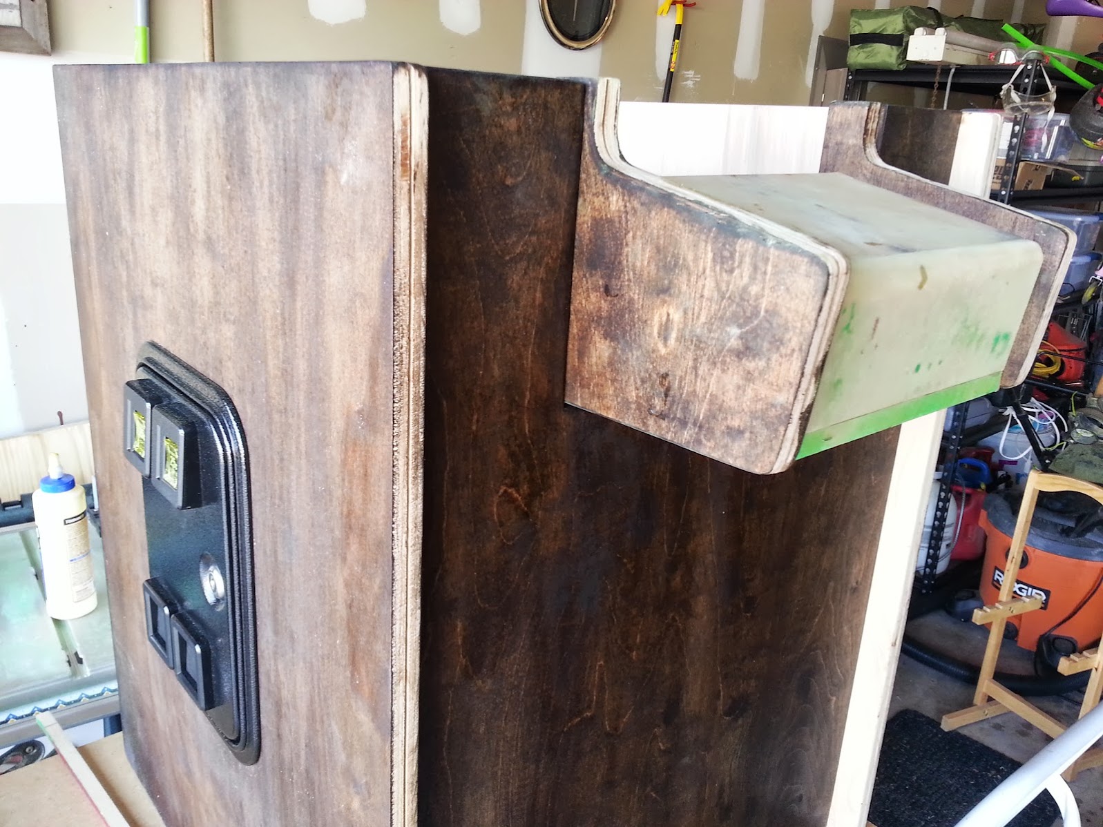

So, the cabinet itself is pretty much done:
Wood stained, control panel's cut:
I realize that my grain is a different direction, but I am going to end up redoing those, more on that in a bit.

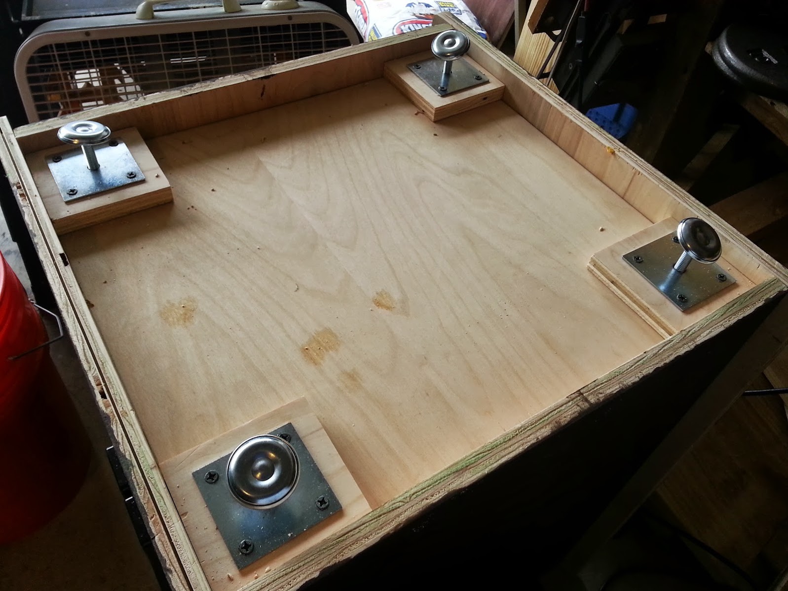

Legs in place:

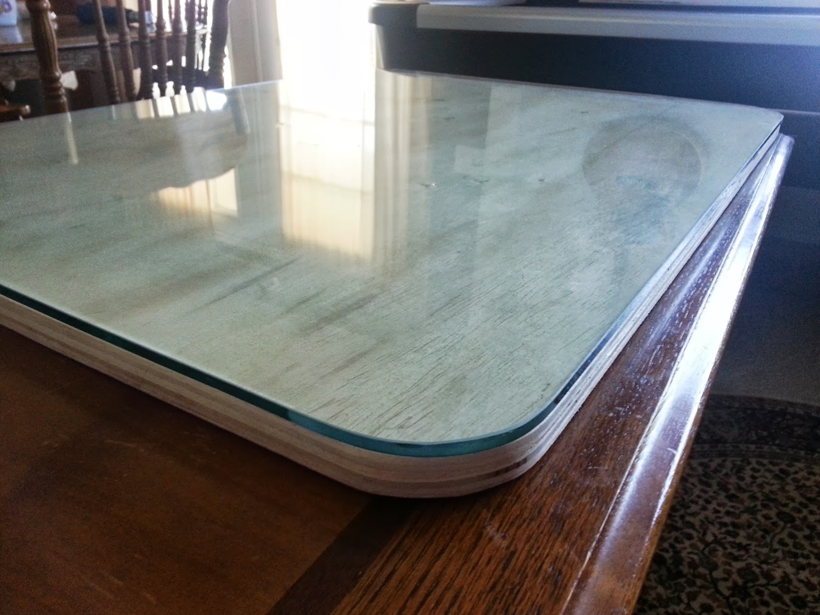

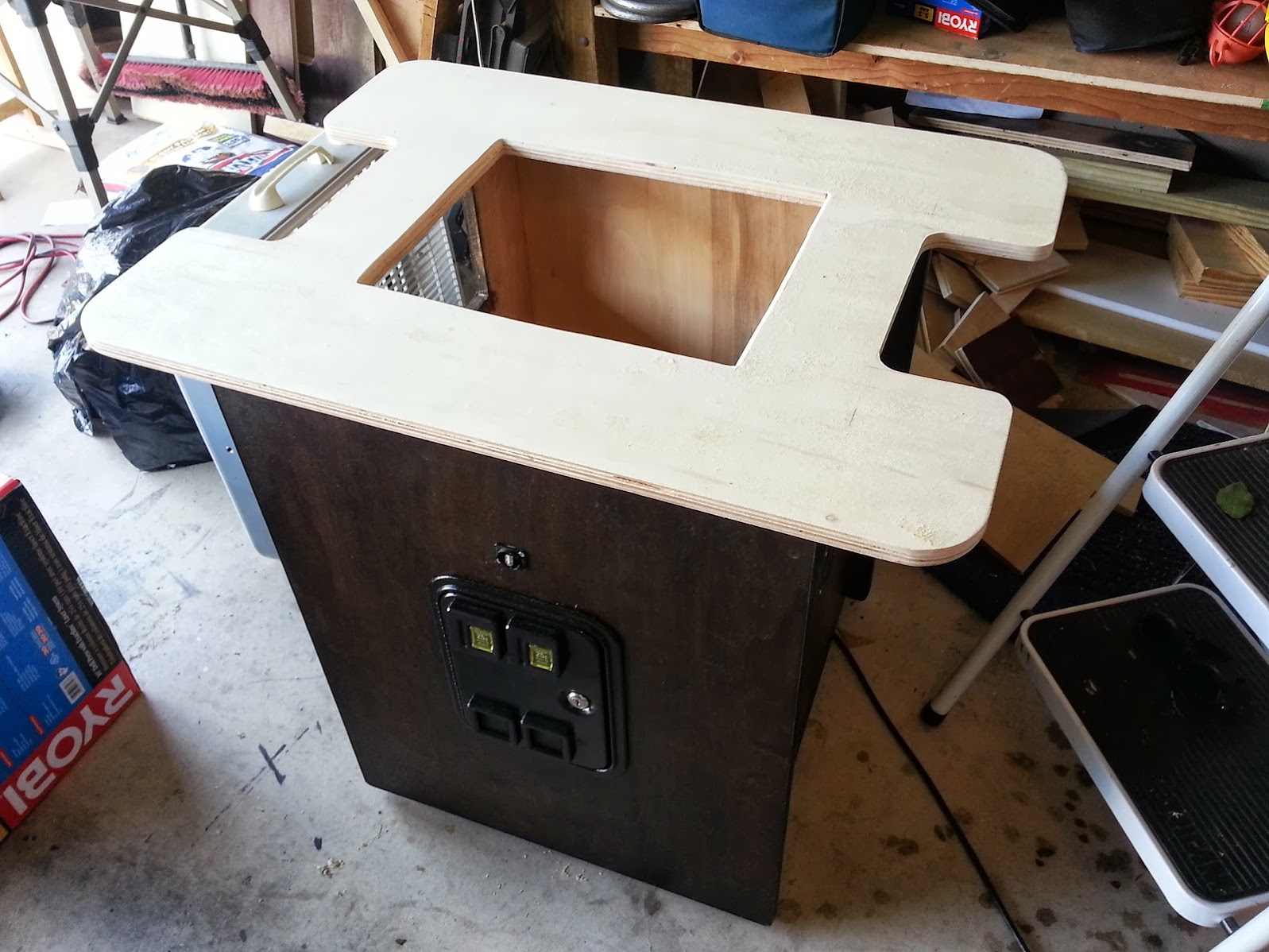

Glass and top wood cut
Top painted, monitor mounted
TMolding on top piece installed
