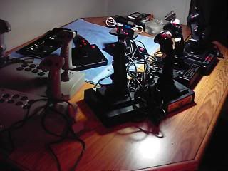

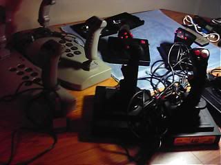

some spy cam photo's of the elf's lab  :burgerking:

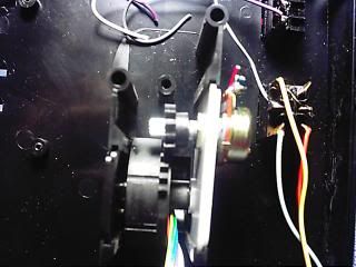

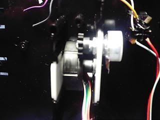

there 100k with smashed spline
my 10k replacement
Btw... mine is a bit more level and has a more smoother travel now becuase the gears are now meshing correctly and should last these are 2 different new out of the box throttles so the teeth are not shot/worn on theirs yet ;)

I have everything in the pics totally stripped part for part at the moment and am even going to mix them for the best setup.

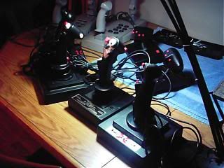

I also picked up a FLCS pro all metal casing stick to mix and match in with the others.
it is the perfect fit for the wife's hands but on the small side for mine while the x-fighter is a scale mold of the real deal fighter jet and them baby's fit me like a glove  >:D
I should be able to mix and match most the stick to whatever type base if needed to.
it is hard to say which is the best of the 5 different models becuase each has the + & - when it comes to overall feel and base weight/sturdyness.
flcs pro is nice becuase everything is metal except the stick handle molding and it is probably the heaviest of all. it's downfall is the base is on the small side and wobbles rather easy and also the stick is on the small side. it also does not leave one with much room to work with on the inside when thrwoing a controller pcb in there but it is possible just have to do it all fancy becuase it is going to be a tight fit is all.
there plain jane flcs is the same as above but all plastic so I wont bother with this one or the top gun series.
the X-fighter now this is thick plastic through out with a huge base and a metal plate mounted in the bottom and to me this is the best feeling stick of them all becuase it is the only scale jet fighter stick they made then and it fits my hand perfectly.
feels great nice and heavy with the metal plate in the base and these stay put the only flaw is the base is not metal otherwise I would say these are the best of them all.
the f-16 flcs is all plastic but has 4 hat's as opposed to 1 like the above mentioned so that is a plus but there problem is there the same base as the top guns and regular flcs with no weight all plastic and very wobbley.
now on to the f-22 pro this is there top of the line for the time it is all metal except the stick handle casing and has the hardest coiled springs of the bunch. while the base is still not as big as the X-fighter is still stays put good and also has the 4 hats like that f-16 there the same thing stick wise but base wise the f-22 size and weight beats the f-16 plastic version hands down becuase it is smaller based and all plastic.
the best of them to me so far is the x-fighter for the 4 button 1 hat setups and most comfortable stick feel of them all and f-22 pro becuase it is all metal base with stiff springs and has the 4 hats.
I am thinking of leaving the one x-fighter like it is but taking the other's stick off and throwin it on the f-22 base and put the f-22 stick on a x-fighter base.
once I get into actually playing games with them I will see if I want to make the custom change over or not but it is also possible and once I get that far I can say without doubt wich one is the best of them all around..
« Last Edit: May 30, 2013, 01:50:40 pm by northerngames »

I been working alot lately but still poking on these when I can and so far I got 2 sticks to do as I please and there is one in particular that I am going to try to stock up on while I can becuase everyone is going to want one for there cab when I finally show and tell.
untill there a done deal with some other things I will release the builds of them and also offer a mail in service for those that already have one or dont have the skills to pull it off making there own.
for now all I can say is good things are coming  :applaud:

small update.
I got these working on ps1 ps2 xbox I could do 360 wired or wireless but the console's need to run off one controller pcb for the stick and throttle so something like a vga port need's to be added to the stick and the wire's ran through it kinda like they were when stock with the old tech.
but now on pc xbox and ps controllers cen be used with either pcb in each stock or throttle without a cable running to the two.
console's would see each pcb 1 in each stick and each throttle as two controllers where the pc see's them as whatever signal you want as keyboard and mouse functions using xpadder for xbox and whatever the one is for the playstation's don't recall the name but will edit it when I do lol.
anyhow with pc even a xbox in one and playstation in the other can still be sefl mapped to do anything really.
playing from beachhead or space harrier to current pc games of all type's.
all I can say is they dont make store bought pc sticks like these except the warthog this is very expensive but I can get the same out of these if I really wanted too hahaha  :applaud:
with two xbox controllers wich means two signals from x,y,a,b,lt,rt,l3,r3,back,start,black,white and then each stick's up down left right and left as either my choice of digital or analog.
that's a whopping 56 seperate signal's if I wanted to go crazy and in the stick base's and throttle base's there is ton's of room.
I got hurt and had no time for these but getting back into them.
I plan to add a xbox thumbstick assembly and D-pad on one of the of throttle sticks along with at least 6 mini buttons too.
I need to go to the scrap yard and get some 1/2" steel plate and fill the bottom of the base's with a slab of thick metal to weight them down and then use like a 1/4" rubber foam type stuff for the base bottom so it dont scratch but stay's planted good.

been awhile since I have gottem around to more custom controller building but I still have all this going on and put to the side.
I still plan on getting everything pictured going as intended as some already are I just have had no time lately.
I been into building custom rc monster trucks again and doing 1/1 repairs on my dodge, home, saving up and buying a fancy mill drill, lathe, press's etc. for custom metal parts and what not so it's all drained me pocket and body wise :laugh2:
I will be back in the loop come fall though.
I plan on decking out one of H's bartops soon as I get the funds and time again.
