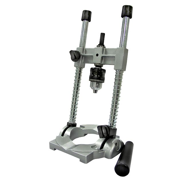

 I would highly suggest using a hand-drill with a drill guide from Harbor Frieght to make perfectly accurate straight holes.
Another good option is the Craftsman Drill Guide.
