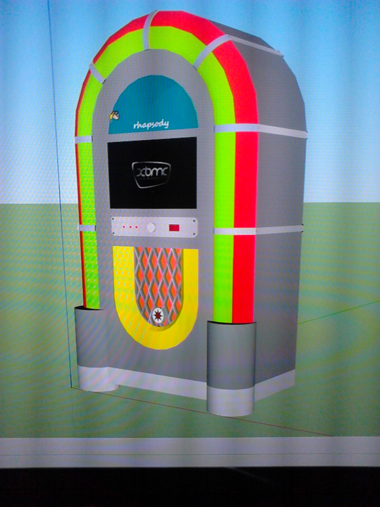

Hi all,
Been awhile since i did any projects, my arcade machine is in hibernation, so the wife wants a jukebox and we are both agreed on the shape.
I like the shape and size of the wurlitzer so i am basing my design roughly on it.
Here is the amp with power supply (will be replacing the power supply wit something that can take 500 watts)
A picture of the speakers (shamelessly ripped out of an old car)  :dunno
And the computer plus touchscreen, running XBMC 'frodo', all setup and ready to go
Will start construction within the next couple of weeks, weather dependant.
Wish me luck
Cheers
korbitz
  • Posts: 103
  • Last login:June 30, 2017, 01:09:54 pm
Re: New build, wurlitzer style jukebox - rhapsody
« Reply #1 on: March 10, 2013, 04:38:30 pm »
Okay i've updated the design/color to show each part clearer, the tubes will be semi transparent enough to allow light from RGB leds to shine through.
The 7 metal trims around the outside are there to hide the joins in the plastic and for show  ;D
The pc is a HP touchsmart q1105, touchscreen works well, spec is high enough for what it needs to do (run XBMC)
I am running the re-touched skin, which will allow users to run videos of Vevo, and access loads of digital radio stations.
The chrome control panel will have a griffen powermate, a digital display (not sure what i,m putting on it yet and some buttons, power/radio/lights/etc)
The subwoofer will be on the base pointing downwards with a neon ring, placement of the 2 speakers is undecided at the moment.
