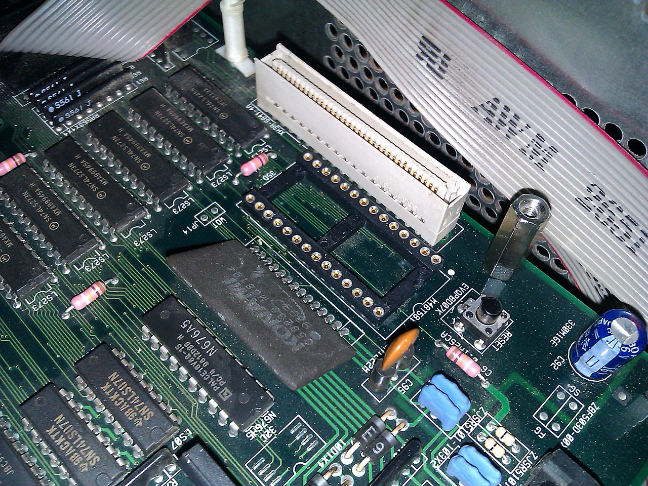

I Have a silent scope 2 fatal judgment game that errors out on boot. I've found its because the battery on the timekeeper NVRam is dead. The fix seems easy enough, buy a new chip and reprogram the data to it. Mame doesn't look like it has a dump of this game. Does Anybody have a dump or know if any of the same hardware series games would be the same info or is it specific to that exact game. I'm not interested in spending 300 bucks to have someone at the vendor fix it.
« Last Edit: May 12, 2013, 12:19:43 pm by lilshawn »
lilshawn
  • Posts: 7516
Re: silent scope 2 - fatal judgement nvram image
« Reply #1 on: February 21, 2013, 02:38:14 pm »
I dug and dug and dug and dug (like dig dug) and finally found this on a li'l server from the netherlands.
best i could translate is that there is 4 dumps here, you make sure the board revision matches and it should work.
off to ebay for a new timekeeper ram chip.

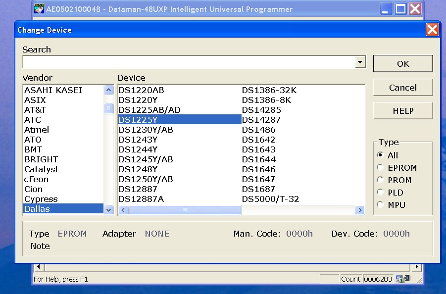

M48T58Y-70PC It's a legit number and you can still find them. problem is you need to program the data back into the chip in order for the game to boot. this is the main issue, it doesn't program like a normal flash ram chip.

  Konami used them on EVERYTHING in the late 90s, though most devices will self-initialize.
yes most of the konami systems had a chip with the NVRAM data written to it...if your timekeeper battery was dead, it simply takes a little longer to boot because they had to reload the data from slower ROM.
Konami CONVENIENTLY left this chip unpopulated on the Silent Scope series boards.  :angry:
I have an EEPROM burner (top2000) that can write data to sram for testing purposes but the data writing for a standard 8k sram chip (which is basically what this nvram chip is) fails after a few bytes and corrupts after a few reads.
interesting, despite ST datasheet claims. Maybe something is amiss and it's trying to R/W to the timkeeper bytes. Just a guess, I don't have the datasheet handy atm.
This may sound a bit crazy because I can't find any schematic for that board.
I theory, do you think that if you can populate that ROM IC with NVRAM image that it would do the trick?
Obviously it depends on the board, software and some other important details, but who is to say that the original programmers did include that functionality but the specific ROM was left out as a cost saving measure? :dunno

I'm sure Dallas semi makes a part that is compatible... dallas tends to document their parts a little better than most. That's probably why ed mentioned them.
here is the rundown...
the nvram contains a string of code a few bytes long that contains the version and region codes of the software. this string also has a checksum to ensure the data doesn't get corrupted.
when you boot the board, the game software starts to load and then calls the info from the nvram... it compares the region code and version with the software contained in the game ROM. if it matches...it runs. If it doesn't - error 11 is displayed. (it assumes the rom is not matching either the version or region.)
so when the battery dies, the software doesn't run because the data is all 00's. in order to get it running again, you must program the nvram with the original data it had with the correct region/version/checksum, so when it calls for the info, it checks out okay and boots the game.
the problem is, even though the nvram seems to be a standard 8Kx8, it doesn't program like one. (at least my eeprom programmer doesn't)
MonMotha
  • Posts: 2378
« Reply #17 on: September 03, 2013, 01:27:26 pm »
Also, crazy.  Looks like Dallas isn't giving out full datasheets to their 1-wire crypto parts without an NDA anymore.  No idea why, because they used to and were actually secure (i.e. they did not rely on "security through obscurity").  Even the older SHA-1 parts now need an NDA for the full datasheet.
No mater, it's not really relevant to this discussion: the part in question does no crypto.  There's nothing preventing you from obtaining a usable "dump" so long as you do it before the battery dies.  The game software might still tie the data to the system serial number, though.
lilshawn
  • Posts: 7516
« Reply #18 on: September 03, 2013, 07:05:30 pm »
it's more security from people burning rom sets from ss2 and upgrading their ss1 (and other same system) machines with new roms or buying japanese machines and burning roms for USA so they run legit.
for really really, literally for real, the only data it checks is the very first 8 bytes for the version, region, and the checksum bytes.
Code: [Select]
47 4B 39 33 31 00 00 00 19 99 45 41 41 00 AF A6
translates to:
GK931....™EAA.ݦ
931 is the version (830 for SS1 or 931 for SS2)
EAA is the region (UAA for USA EAA for europe etc)
the last 2 bytes are the checksum (AF A6)
even the 2 bytes (19 99) are used as the copyright date in the game.
if the nvram contained only these first 8 bytes, it would probably work.

OK, here is how I did it:
1. I replaced the original Timekeeper (M48T58Y-70PC1) with a 28pins socket for easy access.
2. Programmed the new Timkeeper (also M48T58Y-70PC1) with the SS2_931EA.DAT file out of the ZIPfile posted earlier in this thread. I used the for me only available programmer, wich was a Dataman 48-UXP. As you can see on their homepage (http://www.dataman.com/m48t58y.html?package=1593) this programmer does not support the M48T58Y-70PC1, but when I choose a Dallas 1225Y as device it was possible to do it anyway. The verify error is normal, because of the time-data wich changes every second, dont mention it.
3. Insert new programmed Timekeeper in socket, put little board back on and the game functions!
4. DON'T adjust the clock, which comes up after you clear the bookkeeping. If you do save something else then the time which is already shown  the game get's locked and asks for a password! In that case you have to re-program the Timekeeper. (or know the password of course)

  • Posts: 7516
« Reply #37 on: October 07, 2013, 10:10:03 am »
well, i recieved my new time keeper. I did only receive one. it came packaged from mouser. ST had an "option" in the form where i selected from a number of distributors to select my preferred parts place. I happened to select mouser.  :dunno meh, all good.
but, i plopped the chip in my programmer and selected the D1225Y and it does the same as the other chips. gets to 0400c and errors out. It must just be this programmer.  :-[  :banghead:

lilshawn
  • Posts: 7516
« Reply #39 on: October 07, 2013, 04:00:39 pm »
i'm using some chinese made "top2003" programmer. it's been good for everything i've thrown at it so far... I think with a software update it would probably work...but because it's a chinese unit, they pushed out some crappy english translated software and that was it.
it uses the cyprus EZ usb interface, so perhaps some kind of universal software could work with it.
while it doesn't have the M48TY numbered part to programm, it does have a dallas D1225Y which is what another user here used to program the ST timekeeper, but it doesn't work in my case.
