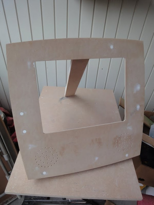

Well i was searching for something in the storage, and found the front mdf panel of this project. Might as well finish it, dont like opening topics which i dont end.
Its gonna be a simple side project, replace the pc for a android mini pc stick or a old left over xbox1
I drilled the speaker holes by hand, turned out ok

« Reply #24 on: January 30, 2013, 06:57:50 am »
 :applaud: :applaud:
   Yes I remember when you started this. I'm glad you're going to finish it.

Finished the woodwork mostly. Little bit more sanding and filling and then i can start painting. As this thing will be heavy it needed a lot of reinforcement.
Added control panel buttons and 2 air vents
