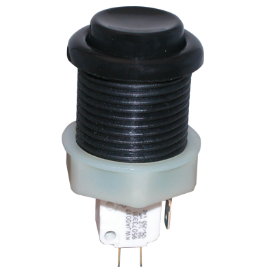

2. HAPPA? competition joysticks and about 14 HAPPA buttons...not sure how good they are but they feel solid
The Happ Competition stick is a common choice for playing a wide variety of 8-way games.
It won't do as well on 4-way games like Donkey Kong or Pac-Man, but you're not shooting for the world record.
As long as the buttons have the terminals pointing horizontal instead of vertical, you're good.
They're horizontal, but why is vertical bad?
If you look at the flat plunger "foot" that presses against the "nub" on the horizontal microswitch, it presses straight down.
For the vertical "Ultimate" Pushbutton, the plunger leg presses the nub sideways.
