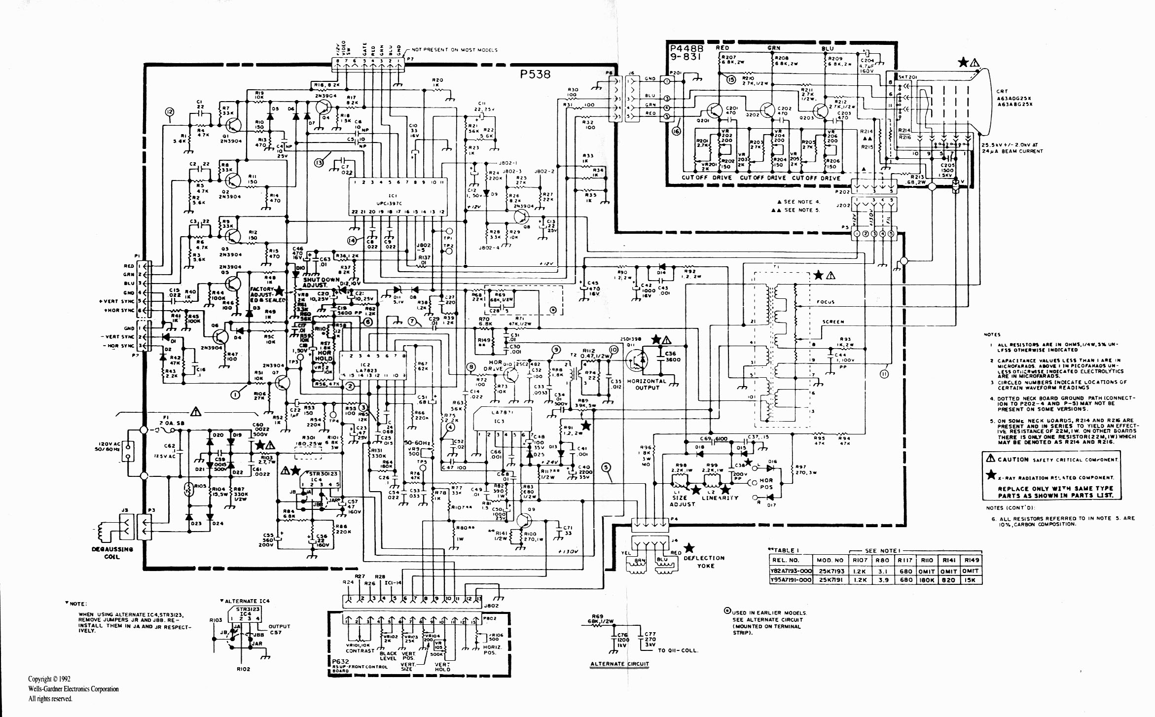

Here's my situation: I have 3 chassis
chassis #1 WG K7000 series 538 main board with a P448B neckboard--flyback and IC4 missing--this is the one I'm repairing
Chassis #2 Wg K7000 series 447 main board with P456--new cap kit and flyback condition unknown
chassis #3 Zenith version of the K7000 came with working monitor--board had a hole in it underneath C36 but otherwise complete.  It was shorting across this hole.
What I have done so far:  transferred the new caps from board 2 and put them onto board 1, along with the flyback and IC4 (STR 3123)
Edit:  when I power on, I get no glow in the tube but the large 220 ohm resistor on the side of the chassis heats up like crazy.  What should be my next step to find out where the power is getting diverted?

You made a big mistake as the main boards are different! There are some wiring changes/jumpers on the P538 depending on the voltage regulator installed at IC4. Some of the component values are different on the board.
The P538 board is for either a 25K7191 or 25K7193.
The P447 board is for the 19" and/or 13" tubes with the small neck diameter (22.5mm). Probably for 19K7600 or 19K7900.
Double check for a shorted diode D18 and/or shorted horiz output transistor Q11 (2SD1398 which has an internal diode across collector-emitter).

According to the schematic for the 25K7191 (for the P538 board), when you have an STR 30123 installed for IC4, you should have jumpers "JB" (which connects pin 1 to ground) and "JBB" which connects pin 3 to the junction of R103 & R301 (B+). When you have an STR 3123 installed, you should have jumpers "JA" (which connects pin 1 to B+ at R103 & R301) and "JAR" (which connects pin 3 to ground). Both of these IC voltage regulator have the B+ and ground terminals reversed from each other so if you did not change the jumpers for the correct regulator----ka boom! The regulator will be destroyed immediately on power up!

A big thanks to ken Layton for the schematics--If anyone else wants them I have converted them into a jpg files--this is for the 25" k7191 model--I won't time this message out since I know how hard these are to come by.  I have attached here as well but I'm afraid it might not be big enough to be useful.  we'll see.

Here's a higher res jpg of the schematic that someone emailed me a while back:
http://jstookey.com/arcade/WG_25k7191/wg_k7191.jpg

Good links but if you have a P538 board those specs sheet will lead you solidly astray since you know there are different parts, but you won't know that they go in different than the P447 board--the schematic is a must have for this unit.
Still haven't got mine working--I ordered a new Q11 and IC4 for it since I don't know what a "known good" value for either of these chips are--and they were cheap.

Received and installed new IC4 (STR 30123) and Q11 (2SD1398) and sent power and no power ???  So I followed the troubleshooting guide...AC is good, fuse is closed but no power.  I checked IC4 pin 4 and it was almost 0 (.2V or something) as well as P202 pin 3 on the neckboard (same .2V) .  What part would stop all voltage after the fuse?
Would a bad flyback give these results?  Oddly enough the board that I got it from has a service note of "no power maybe 200V 560uF--new rectifier diodes/caps 8/23/03"
Is there a way to test if the flyback is getting any voltage (without a high voltage meter that is  :-\)

Check for voltage on the big white resistor attached to the side of the aluminum chassis (R301 on the schematic). With the monitor powered by an isolation transformer (as usual) put your negative (black) meter lead to chassis ground and the positive meter lead to either one of the resistor terminals. One side of the resistor should show the regulated 123 volts DC. The other terminal should show the raw unregulated DC from diodes which sould be at least 140 volts or more. If there's no voltage on either terminal than R103 is probably open. If there's voltage on R301 but it's way lower than it should be check resistors around C55 & C56 for an open or off value condition.

Thanks ken, I checked R301 and there are no volts DC at either pole--Incidently I tested r301 and it reads 180.9 ohms or thereabouts so It's good.  I'm now going to start pulling parts and testing them starting at the power plug and working toward IC4.  .  Please tell me I haven't fried my new IC4 chip :-\

I don't think you damaged the chip since you have 0 volts at both ends of R301. Work back towards the power plug from R301. I'm thinking you have an open resistor or break in the foil.

EUREKA!! ;D  R103 was open so I swapped it with an extra one I stole from the part board it works!  Weird though, because I had checked 103 previously and it read as good--so I must have baked it at some pont during my testing.  Now I can get back to building the cab.
