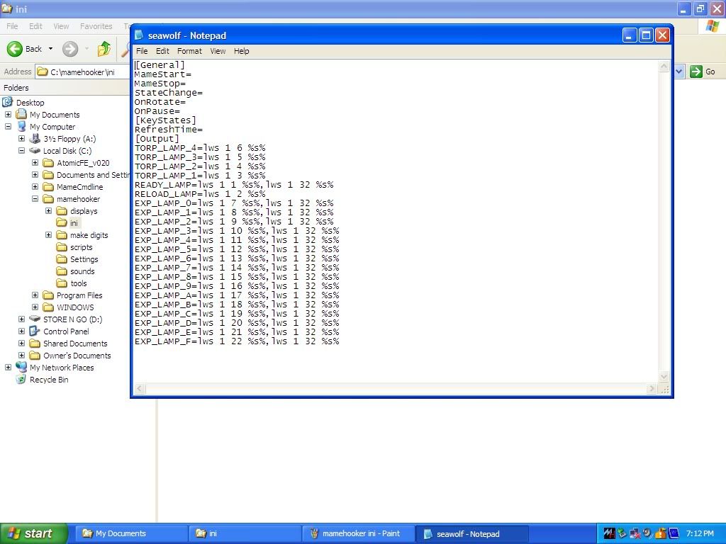

I have gone into the Mamehooker ini's and edited them for code mostly lws 1 1 %s%
I have even edited the ini's once for all outputs to signal off of port 32 to try and get at least one light - nadda

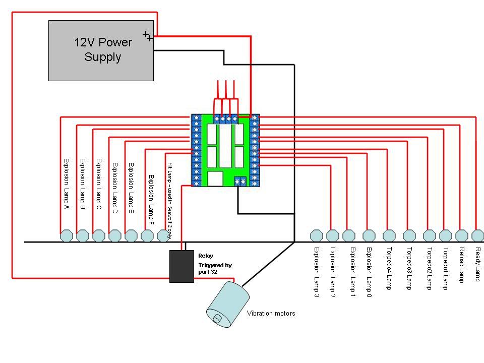

Wiring plan after prove out- to lazy to draw every wire it all but it should work.  - I am bench testing with only port 32 hooked to a light bulb

Trial of edited Seawolf ini - you can see how i tried to get port 32 to light with the ready light  - nothing

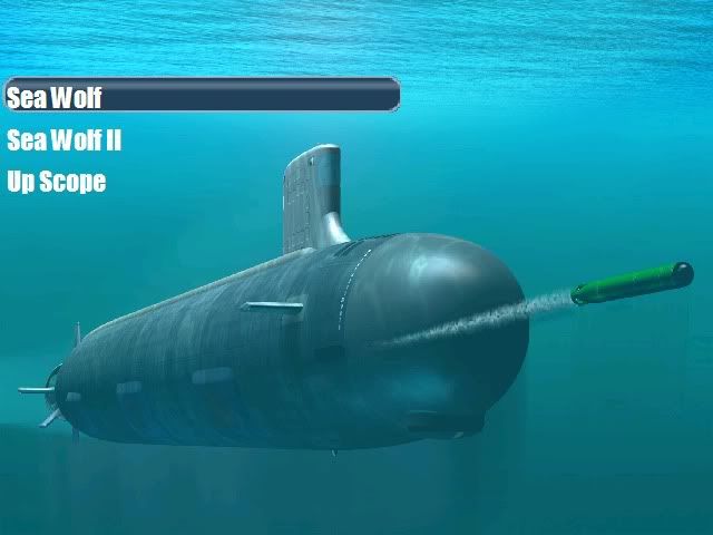

Front end game selection screen - the only thing I did right

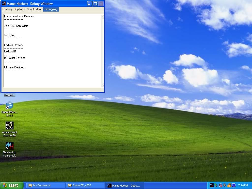

Mame Hooker showing it supports LEDwiz #1

Well spoke with Randy at LEDWiz....figured it pretty quickly.  It turns out I had it wired sort of wrong.  I assumed the LEDWiz was switching the power and sending power out each port...so in effect I was actually sending ground to a light bulb that was grounded.  So now after a quick swap of the ground on the light to +12V it works, makehooker activites it as does LEDblinky.  :banghead:  I figured out of the programming and coding but got the wires wrong....ugh.  So simple after you have done it right once.
