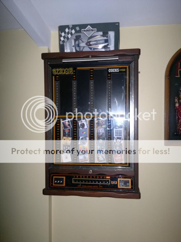

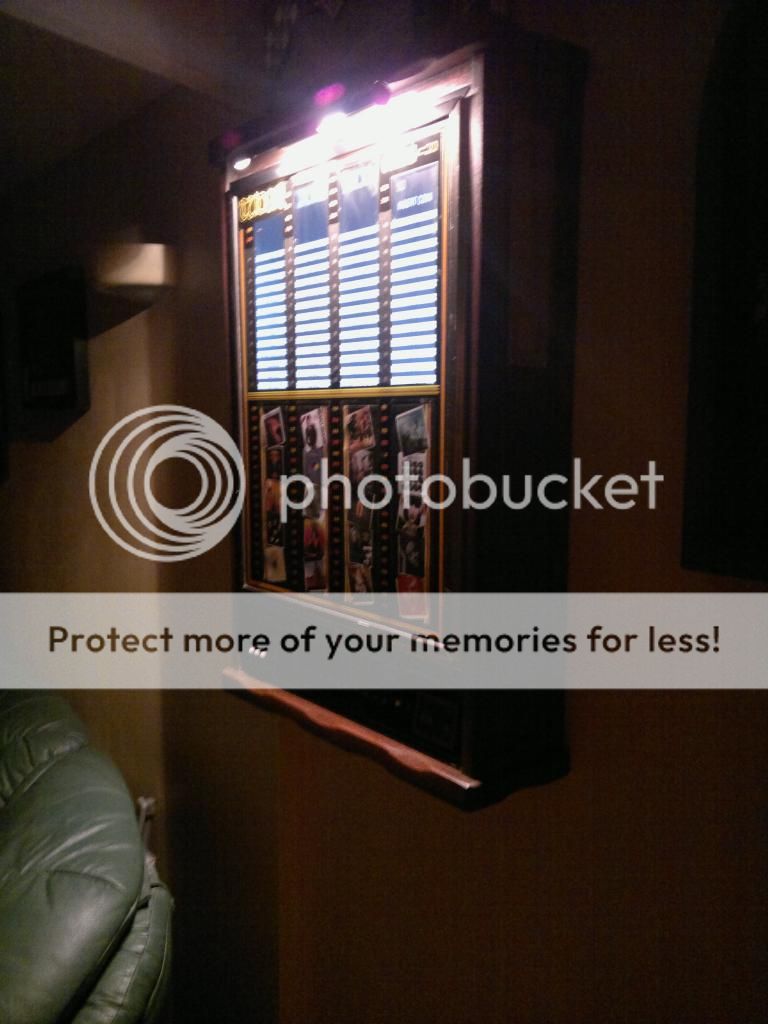

went and bought a job lot of broken wallboxes from ebay and decided convert them into digital jukeboxes.
basically removed glass, removed paint from sections, added some printed graphics and numbers, touched up paint.

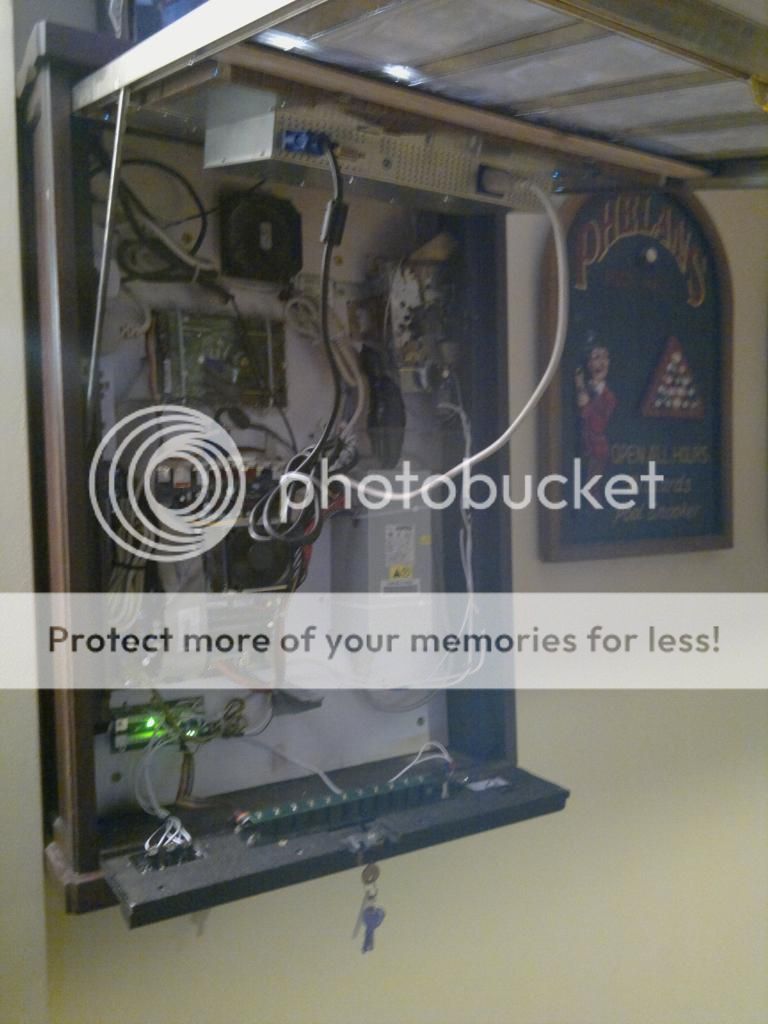

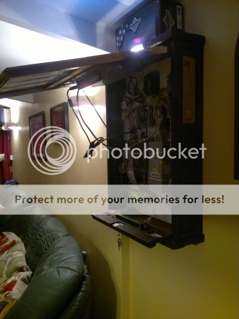

decased and fitted a pc and monitor behind the glass. aswell as couple of fans for cooling.
re wired the keypad (desoldered and resoldered) to a keyboard encoder, and added it all to the pc.
took the coin mech apart and attached micro switch to it. (currently accepting 10ps as 10 credits each).
also added a few buttons for page up, page down, next track and select.
designed a skin using dk jukebox and scaled to fit in the empty areas of glass in front of monitor.
finally added a halogen picture light to above the glass.
Ignore the glare its really non existance in person, just picked it up on camera.
enjoy :D
