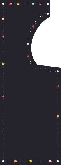

I can't for the life of me get the nerve to do something about the art for my cab. I want to move on but I don't want to rush this part.
I have decided to go with a pac man game themed black cab. I did a marquee for my first bartop that I really liked. Now I need to re-do it in High Rez, which I don't know how to do.
I would like the side art to be similar too, where pac-man, ghosts, and the dots trace around the cab. With maybe a graphic or text in the middle.
No idea for the control panel. Any advice at all will be grateful. I don't know how to input my cab measurements into a graphic program to get my prints perfect either. I have photoshop but not very skilled with it.

I don't know your end size, so I just quickly recreated what you had with what I could find off the arcadeartlibrary (font isn't correct). I made the size 8 x 27 as a starting place.
A preview jpg of the Illustrator file I created is attached.
If this is what you want, I can send you the Illustrator file.
WTF? That was quick, and bloody awesome!
Since I posted this thread I made a little mock up in paint of the cab side. What do you think of the idea?
I figure I would add a logo or something in the middle......not sure.

I like the thumbs-up PacMan from Drnick's suggestion, with the "Pac-Man" changed to "CORY-CADE" like in the first post marquee.  Drnick's 25th anniversary attachment above is a great starting point for this.
Drop the maze background since you mentioned wanting more of a minimalist approach.
Use larger ghosts and pellets around the perimeter and on the front center a stair-step pattern for the pellets instead of curve since PacMan mazes aren't curved.
You may want to print several sizes of figures (2" - 6"?) and tape them on the side of the cab to see how they look scale-wise before you choose a final size.
If you move the pellets and figures a little further in from the outer edge, you are less likely to notice if you are a little off when you put on the side art.

Dr Nick, I am having a hard time figuring out how to measure and plot the front of curve of my arcade. It is not a perfect circle. I am going to attempt to do this today but I still am not sure how I will go about it. Thinking now that tracing the side might be a bad idea unless I can figure out how to do this. Although I have no other ideas of how I will go about choosing the art. Thanks nick, I will try and come up with something.
Pl1 I appreciate your inputs as well in our correspondence, the stair approach to the side is a good idea. Making them bigger is definitely a good idea, I made the side art image in paint and doesn't help for sizing. I am coming up with some images to put on the side as I type. I need to get an image done to scale in photoshop or gimp or something so I can mess around with it and when I get it right I don't want to have to do it over in a different scale like Dr nick said.

Someone here may be able to assist you more with the curve, But If the bottom/back are exactly 90 degrees then I would once again start with a rectangle that is maximum width/height of cabinet. First find the deepest part of the curve and make a note of it's height from top and bottom and distance from back and start from there. This gives you your starting x/y co-ordinates. Then take measurements from back of cab to curve every 1/2 inch both up and down. (This equates to 50 Pixels on the base artwork at 100 dpi)   (For more accuracy you could even do the measurements every 1/4". Once you have plotted all these into the artwork. You can then create a curve that takes all these points into consideration.
I cannot really think of an easier way of doing this if the curve is elliptical rather then circular.

Made some small changes to the side art, got rid of some cherries and added other fruits and some pretzels  :cheers:
Also, I wanted to give it ago at adding some clyde to fill in some space. Just through him in the and made him transparent.
I attached the .AI files if anyone wants to take a shot at helping me out. Any ideas welcomed!  :cheers:
