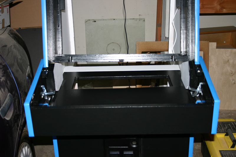

Hi, i wanna buy a gutted cab for a mame project and i ve found this :
It s only 21'' of large and 5 feets high.
Price 150$ -> a bit expensive. There are speakers and screen but not in a perfect state. T molding is new.
Do you think it is high enough to play in a stand up position? I wanna make a 2 player panel with 6 buttons each is it big enough?
What do you think ! And the screen is not vertical enough..I think the biggest i can put in it is a 19''...Bit tiny??
Anyway i really like the style and the size but is it gonna be a problem while playing with a friend?? I am tall btw..
ah yeah i also wanna put this cab on wheels so can win a few inches high...
Sorry for my english and thanx for your help !!  :angel:

It looks like a good base to do your own thing. I have a cab of similar size and design. I went for a two player setup but only 4 buttons per player. I have an original hantarex 20inch screen in it. works a treat. i like the size and angle of the screen

Ok so i ve bought this cab with speakers, t molding, and in a good state.
Well, actually, i want it in a perfect state.
So i m gonna put a new layer of paint -> question do i have to sand down first?
The marquee looks a bit smaller and is unusual, i hope i can change it easily
-> question can i fill the holes with something instead of rebuild the board of the coin door?
More pictures to come..Thank you everyone
Ps i think i will make a gouls and ghost cab but not too dark  :burgerking: , artwork coming soon !

Thats great on the purchase. I measured mine today, it is 23inch wide. I am happy with two players but you have to stand slightly over to the side when playing. 6buttons would be tight but possible. here is a video of mine so you can get a feel for the control panel size.
MacGyver
  • Posts: 317
  • Last login:December 18, 2023, 12:49:00 am
    • Project Build
Re: I've got a gutted cab ! (advices needed)
« Reply #6 on: September 04, 2012, 03:22:53 pm »
Are you sure that it's paint?  It looks like black Melamine or vinyl.
You are right It looks like black Melamine or vinyl.
How do i remove this sh**?
Space Simpsons cab in progress
  • Posts: 9794
  • Last login:Yesterday at 01:04:08 pm
« Reply #13 on: September 04, 2012, 08:24:32 pm »
If it's vinyl a heat gun and scraper should do the trick IIRC.

Hello,
I wanted to remove the vinyl and as it is very difficult without a heat gun and that i want a full artwork...I said to myself, why dont you just fill the littles scratches with sand and stick your artwork on it?
- Is it a bad idea and if it is, why?  ???
Secundo, i remove the old screen and think i m gonna put a flat one, i ve found some "square" screens very cheap ! Is it working ok or do i need smthing else?
Go back to the absolute...
I remove marquee..It is very skinny but i hope that i will be able to make a good job.
The bad point is..I want to put some wheels and the cab is not tall enough in my sense so i wanted to make it higher...But it is already done on over more than 10 centimeters (picture one..)..
So what do i do with that?? I just plug the wheels and that s it or i make it higher and it ll be awfull?
What is the best way to paint the coin door as new? Do i sand it first? What kind of aerosol is needed to have the hammer effect??
The clamps for the CP are on the side but i want to haver flipper buttons do you think it is possible?
Thanks for your advices  ;)

I don't have all the answers for you, but here are a few to get you started:
The main drawback is the fact that the cab looks like it has been on location for quite a while.  Seems like the vinyl texture would trap a lot of the dust, dirt, grime, cigarrette smoke, spilled drinks, etc.
If you don't prepare the surface properly for sideart, it will curl up or peel too easily.  See Rikitiki's Side Art Install 101 thread and associated videos.
The adhesive on printed sideart is less sticky than some other applications to allow you to smooth it out and avoid bubbles and wrinkles.
The vinyl is thin enough that it will show the texture underneath it.
If you're going to spend the money on printing nice sideart, you can spend the time, money and effort doing a proper prep job or you can  :angry:  when it comes out looking . . . not so good.
Think of it like doing a back handspring on cement:
- Doing nothing is OK.
- Doing it all-the-way is OK.
- Doing it half-way is no good.
The thickness of the cab side (3/4"?) plus the panel support (3/4"?) makes it too thick (1-1/2"?) to mount the microswitch on regular buttons.
You could use Ultimarc's Goldleaf buttons since they don't have the microswitch/wires coming off the side.
Use a 1 1/8" hole through the outside of the cab and a little bit larger one through the CP support piece so you can tighten the button nut with a button wrench like this one.

Don't rely on artwork covering up partially pulled vinyl and scratches. Its a pain at first to strip vinyl with a heat gun but once you get going, its not so bad.

Yes, definitely use a heat gun. Its real tough without one.
Not sure what part of the world your in but Harbor Freight stores will have them real cheap.
In a pinch once, I used an iron with some material between the iron and the vinyl so it wouldn't melt on the surface.

Bad news...It does not work with the heat gun !!
The wood burns the vinyl stays and so on..
So i get my money back to the shop and ask a "Pro" he told me that the best way was to sand it...Even a cleaner, remover does not work (apparently)...
So i ll sand it  i guess ^_^

I've had good luck removing vinyl of all types with a citri-strip type paint stripper, tried a couple different brands (it is thick, almost a gel), and it works well. You just end up with a bunch of rubbery vinyl sludge all over the ground afterward (put newspaper or something down). Was the only thing I could take the vinyl off an old Kangaroo cab with.

Hi everybody,
I ve got some news. Nothing amazing but i keep going.
I sand this *** vinyle..Hard job but now it s ready to receive a nice artwork.
I ve cut the CP, i m ready to order the pushbuttons.

Hi everybody,
I ve put wheels, it is a bit higher now and easy to move  :)
I ve bought a 20' flat screen LCD 4/3 and i find the result very nice.
I know how to fix it in the cab..
My questions :
- Where can i order the artwork? I live in Montreal and i want it cheap of course..
- What do you think about this for the cp? -> I m afraid that the pushbuttons will destroy the drawing..Maybe i will do smthing around the pushbuttons and joystick, it is more...Professionnal !
- The second one for the marquee..I will add a back ground i think
Pictures of the cab soon !
Thank you
