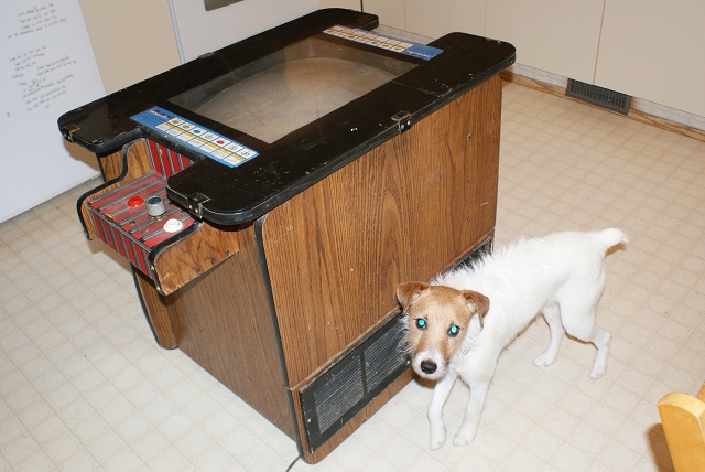

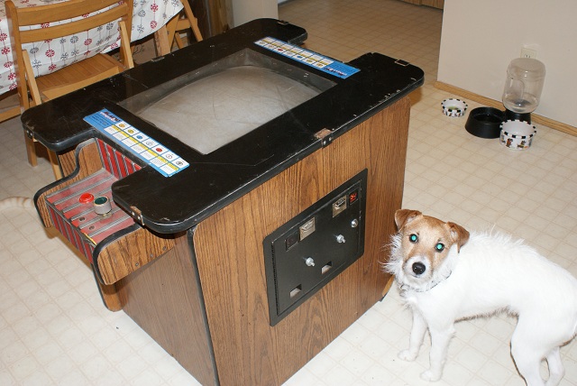

So... back in January of 2010 I stumbled on this cocktail machine on Kijiji (Canada's Craig's list), for a price I couldn't pass up.
In the time since then, I haven't had a suitable place to work on it, not to mention a marriage, honey moon, and birth of my son... life sure manages to get in the way of hobbies, but it's all worth it. Over this time I managed to save up enough to pick up a few power tools, and also stock pile some other building goodies. Totem has a 2$ off-cut bin full of 2'x4' sheets of various boards that I pick over from time to time to build up my stash on the cheap.I've got some primer and paints from various other projects. This summer I booked some vacation time. The wife is at work this week, and my son (now 14 months old) is spending the days with grandparents. I finally have some "me time". This is my first major undertaking on a project of this magnitude. I have absolutely no real prior woodwork experience. This project will be the first time I've ever really put power tools to wood on my own. Please be gentle!
Without further ado, here's the cocktail as I picked it up over two and a half years ago:
Now then, let's get started...

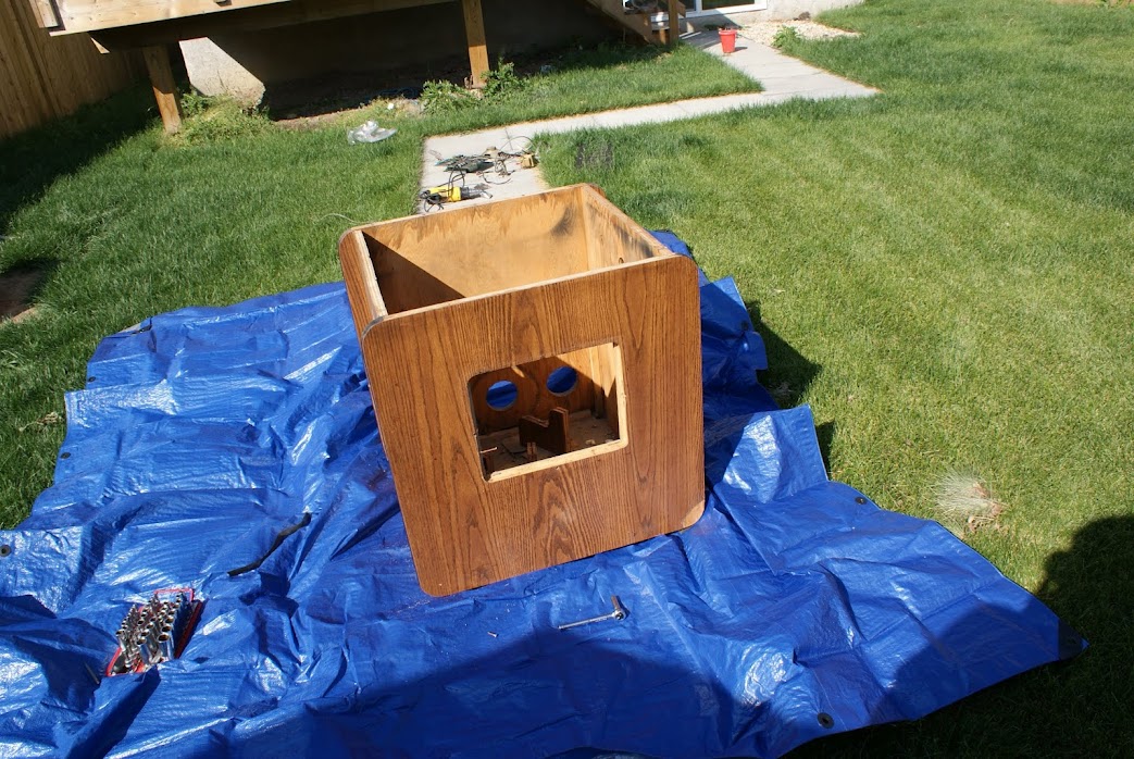

DAY 1! August 28, 2012

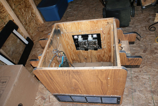

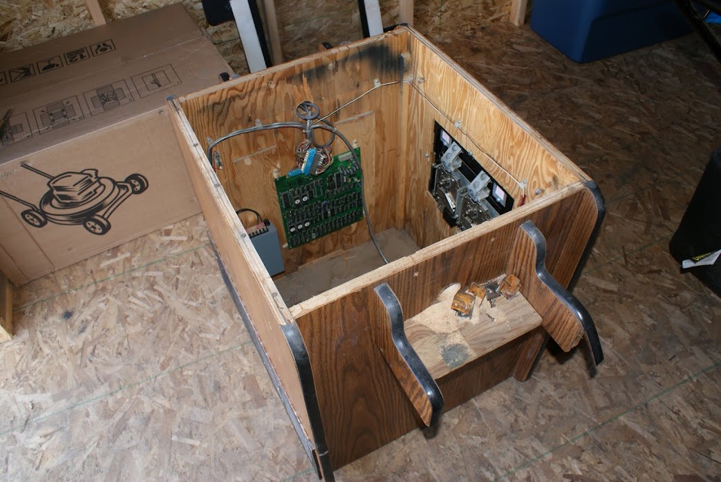

Step 1: Strip out EVERYTHING!
Remove the top panel...
Won't be needing this for what I have in mind...
Looks like the monitor is heavily burnt in, possibly from a couple games... who cares?
Let's strip all the hardware out of this cabinet now...

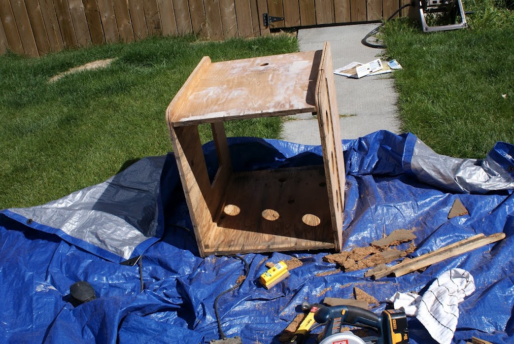

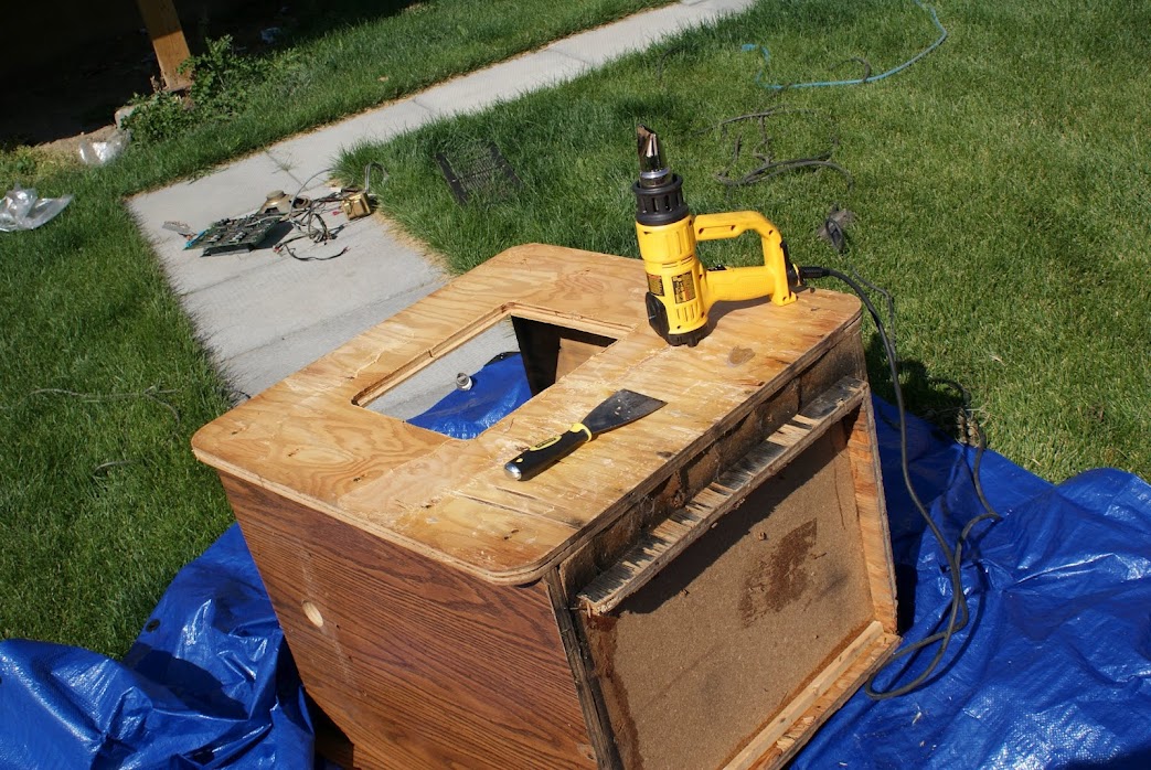

Step 2: Strip the laminate
Putty knife and a heat gun, set to 1100f... this makes real short work of the process!
Step 3: First Sand + Early Bondo
Hit it rough with 80 grit, and tried my first attempt at Bondo'ing...
...and failed horribly. First few batches I mixed up all hardened in about 2 minutes. Must be too much hardener. Cut it back to about half as much hardener. I gave up for the day at this point.

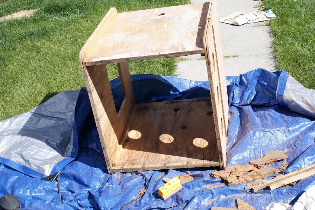

DAY 2! August 29, 2012
Rainy morning, only going to have a couple hours of work time once the yard has dried up enough. The grass is still soaked, but at least I've got my tarp down. It's useful two-fold. Helps me from getting wood and screws everywhere, and keeps the moisture down as well! Also, still no go with the bondo. Since I cut back on the hardener, it's STILL SOFT today!
Speaking of moisture, I noticed something yesterday...
This bottom has GOT to go!
A couple hard whacks with a hammer absolutely disintegrated the bottom panel. See all the particle board laying around?

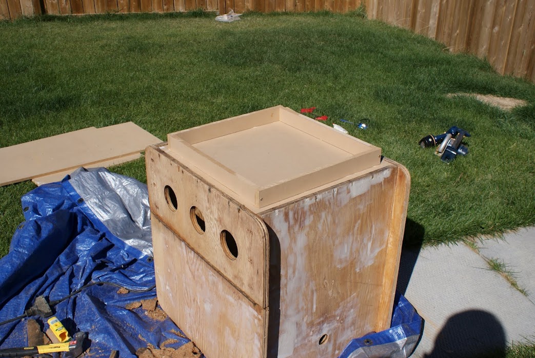

No worries, just means I get to put my virgin saw to some 3/4" MDF!
Measured out the hole for the bottom panel, chopped up a board, and here goes nothing...
Well! Looks like it fits! I must have been fluking out pretty good! The glue says clamp and let set for 25 minutes, but I don't have clamps that would fit this. While I let the glue set, I stacked on a couple sheets of my 2'x4' 3/4" MDF, and just to be sure, I set my 19" CRT on top of it all. I still have enough time to run to the hardware store to pick up some wood filler, and a couple new putty knives.

That's a nice looking coin door... You can get the 25 cents plastic inserts on eBay for a couple bucks.

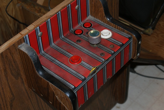

The push buttons on the control could use some replacing, but make sure to keep the spinners if they're functional. Those things are expensive.
Can't wait to see the final product. Have you decided on a theme for the machine?
DillonFoulds
  • Posts: 605
Re: Cocktail Overhaul
« Reply #3 on: August 31, 2012, 07:58:14 pm »
All the controls will get replaced. I'm gonna put in some sanwas, with square gates, and try for a 4 button setup. The spinners, I might see about going Turbo Twists. To do this, I'm debating stretching the panel by about 3 more inches, just for a bit of lee-way, I'm basing this on what happened with the Canucks cocktail.
