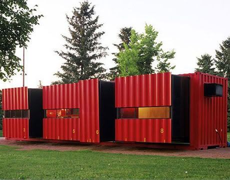

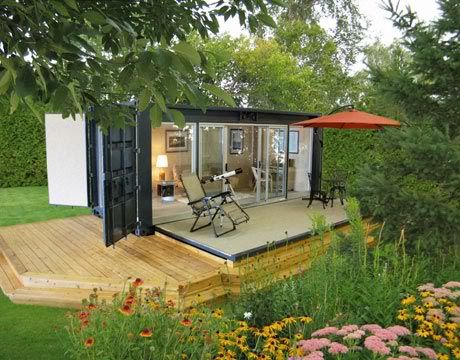

Sure, these have been popular in third world countries as housing, but why not crank the style-o-meter to eleven and use them for modern architecture? Being inexpensive ($3000 for a used one sometimes and fetching less on other sizes), it leaves the designer more budget room to fabricate and furbish how they want their new hobo-I mean home to look like.
Examples:
Since land is cheaper in the US due to its size, why not buy a lot somewhere and build one of these? They almost look like they could be good anti-storm material, sans really high winds. I always wanted to design my own.
