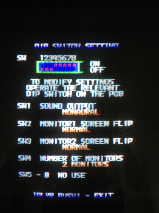

attached is a pic of the dips on my Run and Gun

Thanks again Malenko. I'll let you know when it comes in. Here's a pic of the switches on my board. Seems I have twice as many, which only adds to the confusion.

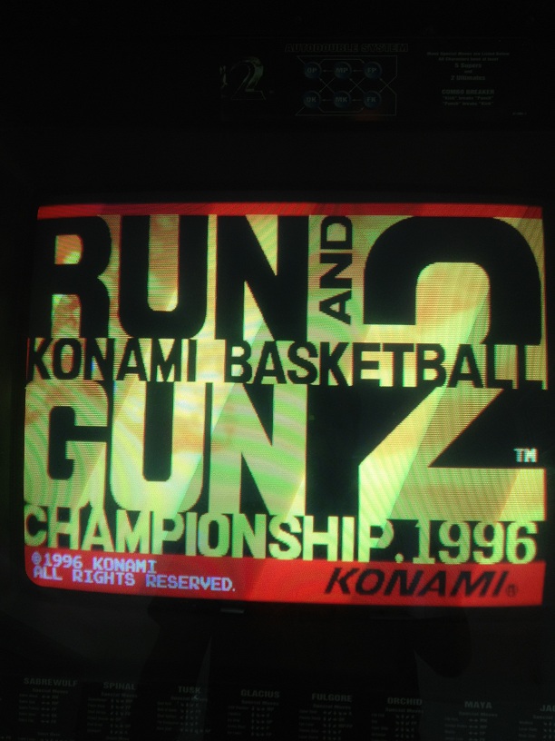

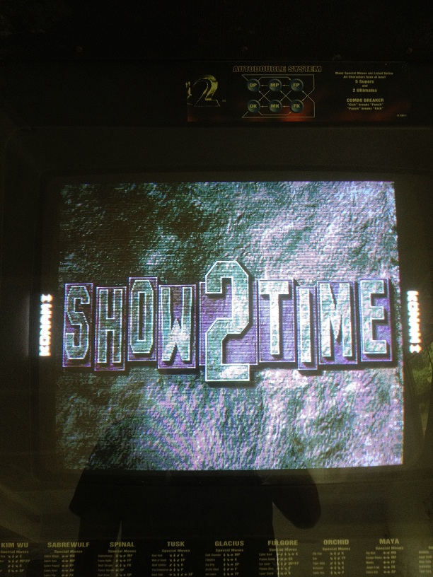

got your boards, they play just fine in my KI and MKII cabs. I think its the voltages from your power supply. Just for the record,I like Run and Gun 1 much better even though 2 looks better.
Dip settings, this is how you want them, except dip 4, that's for 2 monitors, you want that one off.
switch bank 2 (aka switches 5 through 8) don't do anything.
Switch 1 mono/stereo sound
Switch 2 normal/flip monitor 1
Switch 3 normal/flip monitor 2
switch 4 1 monitor/ 2 monitors
title screen 1:
title screen 2:
so, what do you want to do? Send me your set up and see if I can make it work, or me just send you both RnG boards back?
