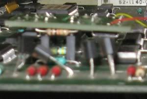

Also, I noticed this board has what they call a "CMOS MOD. ASSY BOARD" (the little daughter board at 6D). Does that have anything to do with the other CMOS and could there be a problem there? I just see "CMOS" without really knowing what it does and wonder if they are related at all.
« Last Edit: May 01, 2012, 12:22:50 am by vinito »

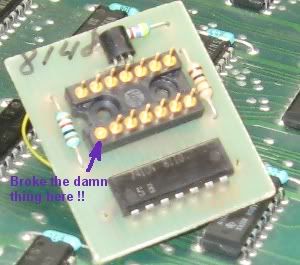

Aw crap! crap crap crap!!!
Just being curious I decided to unplug the little daughter board and take a look at it. Well fumble-fingers let it get out of control just as it was almost out and I bent two legs on the 14-pin connector on the daughter board. They're nice little gold plate pins and slip into a nice little machined socket. Well in the process of straightening the pins out, one of them broke off.  :cry:
I might try to kludge something together and make it work, but in case I can't think of a good way to do that, what do you even call that little connector so I can buy a replacement if I have to?
(edit to add): OK I learned (I think) it's called a "DIP header". Bet it ain't easy to find. Maybe I can just rig something to work....
(edit once more to add): OK I figured it out. No big deal. I begrudgingly replaced the cool little socket and broken DIP header with a standard female header strip on the main board and some gold-plated header pin strips I've got in my stash for the daughter board. Whew! I was kind of freaking out. Just had to settle down and think for a second. I knew there had to be a simple solution.
Back in business
Returning to the problem at hand...
By the way, there was nothing to see on the daughter board. Should have just let it be. At least it was a source of excitement for a bit.
« Last Edit: May 01, 2012, 12:21:05 am by vinito »

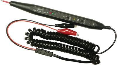

In case it matters, I do have a decent oscilloscope (which I also don't know how to use very well - have piddled with some pretty basic stuff). And also have a little oscilloscope I built from a kit, partly for the fun of the kit and also in case it might be useful being so portable. So those are at my disposal in case you have any troubleshooting advice which would require either and wonder "If he only had a....".
Here's the kit I got. The thing actually seems to work surprisingly well for what it is. I got it somewhere else, but this is the same kit:
http://www.sparkfun.com/products/9484

Yea I've been told logic probes are no big deal. But I've just never had the call to use one so it's all the mysterious ether to me at this point.
A friend of mine is a pretty good electronics hobbyist and helps me out sometimes. I haven't talked to him in a while so maybe asking to borrow his logic probe if he has one would be a good excuse to get in touch again. Hey, don't go hatin' - nobody calls me unless they need help either. ;D
I'll take a look at the flowchart and see if I can get a handle on checking things out. If it's dumbed down enough, then that's probably just what I need. Looks like I'll have a few days of waiting on parts to do a little research. Just have to squeeze it in between the garage rebuild project. Seems like I always have too many irons in the fire.
(Edit to add): OK since I'm on this blasted buying spree, I went ahead and ordered what looks like a decent little inexpensive logic probe. So there !  :P
I usually ask around and get advice, but from what I understand, logic probes aren't as high-falootin' as multimeters or scopes etc. Spec's are decent and reviews seem favorable. The estimated arrival is Friday, so if that's the case it will suit my impatience just fine.
Here's what I bought. Let me know if I screwed up.
http://www.elenco.com/product/productdetails/logic_probes_&_pulsers=NjQ=/logic_probe=MjQ4
Also, I figured out that I could open up a PDF with Gimp and chop a page up to print and reassemble the pieces with tape. So now I have a nice, clear, big schematic to go by. That might help a bit.
« Last Edit: May 01, 2012, 10:53:55 pm by vinito »

Sorry man. I work at a power plant and it's been nuts lately getting the thing back up and running for a while. I'm plumb wore out and haven't had the gumption to look at the game.
However, I did receive the logic probe so I'm tooled up to start investigating. I'll be doing that as soon as things get "regular" again, which should be this weekend if not before.
So thanks for the concern. Everything is OK other than maybe my back and knuckles argue with me lately ;D
