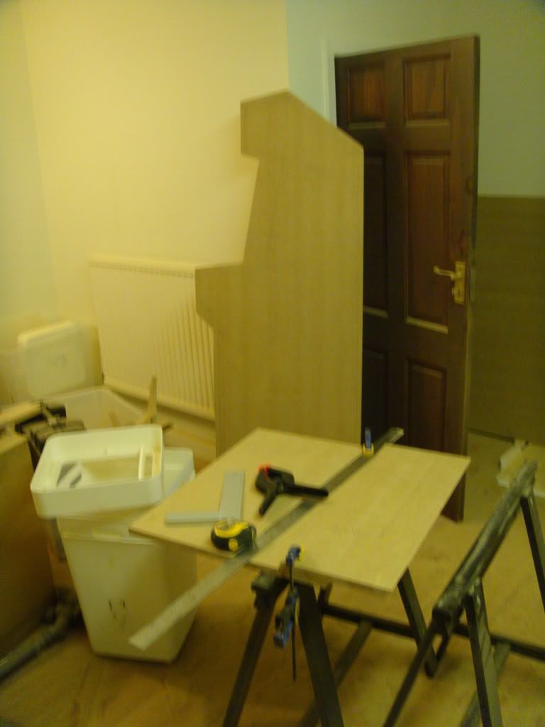

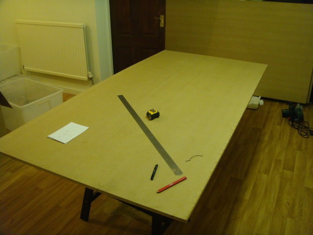

Over the Easter weekend I got off my arse and started drawing out the cabinet sides.
Cut out the shape.
(I didn't use a hacksaw as shown in the photo)

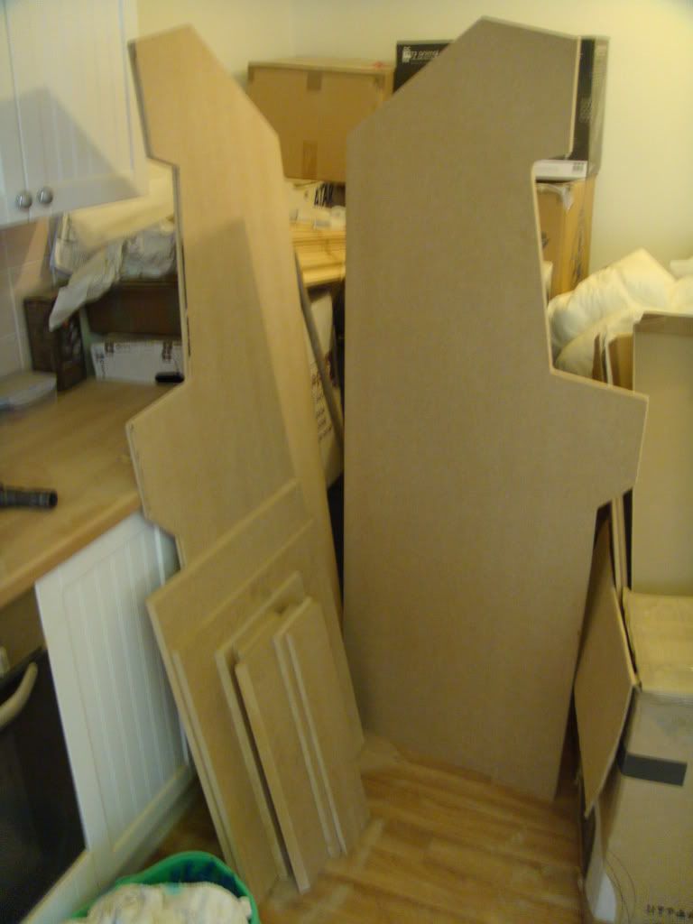

Time to start cutting the the other panels.
All panels cut, l thats what I thought until I realised I havent cut the bottom. Doh!  :banghead:
Just needed to check the panels fit together. Not 100% perfect but as I'm using a hand circular saw its a good first attempt.

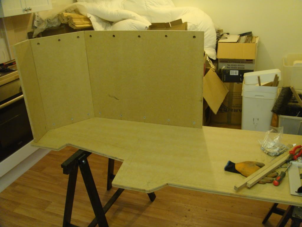

After a few measurements and drilling the first panel is in place.
Since the first panel was a success I drilled the second panel.
Posts in place for the second panel.
Third panel in place. Everything going well.

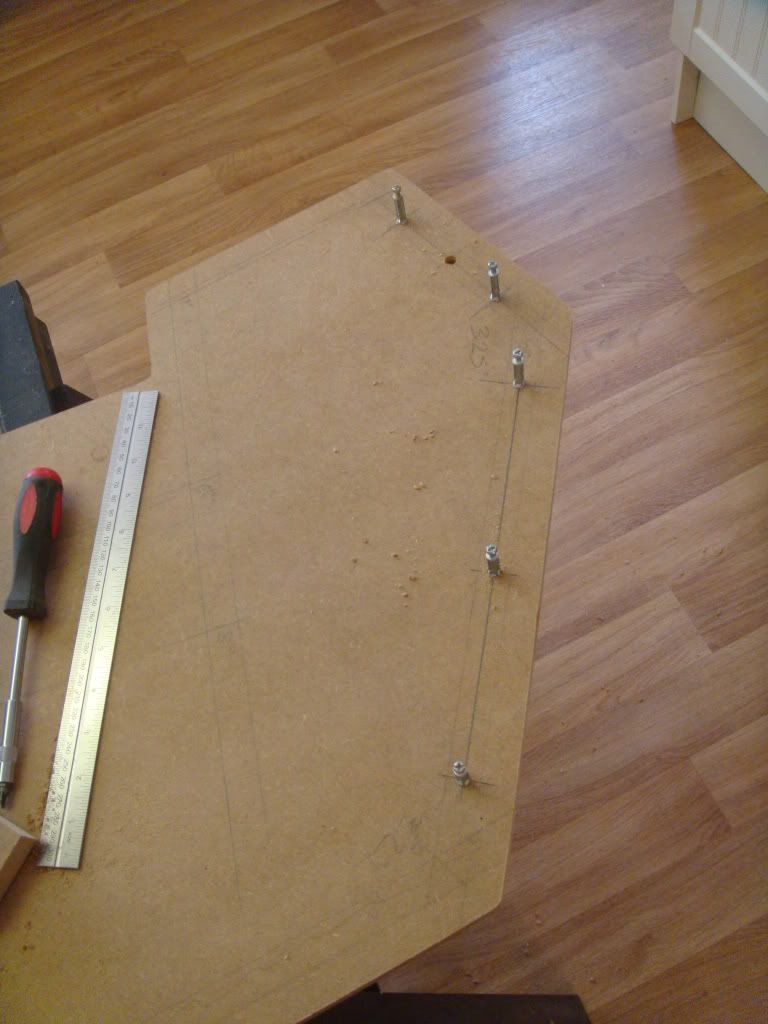

Looking very good, if you don't mind me asking how did you put the pannels together?
Call me stupid but i don't see any wooden supports or anything?
If you can perhaps show me? much nicer than my first cabinet that i can promiss you.
I've used cam locks & cam dowels - here's an example http://www.hafele.com/us/products/Minifix_Connecting_Bolt_Cam_Hafele.asp
I bought a plunger fitting/devise for my drill to help me drill straight holes
I made a little jig on the bottom to help with centring the drill bit in the middle of each edge of the panels.
I used a 15mm Forstner drill bit to drill the holes for the cam locks
After drilling 5mm holes in the side panel I screwed in the cam dowels
Slide the panel on to the dowels and tightened the cam locks, job done.

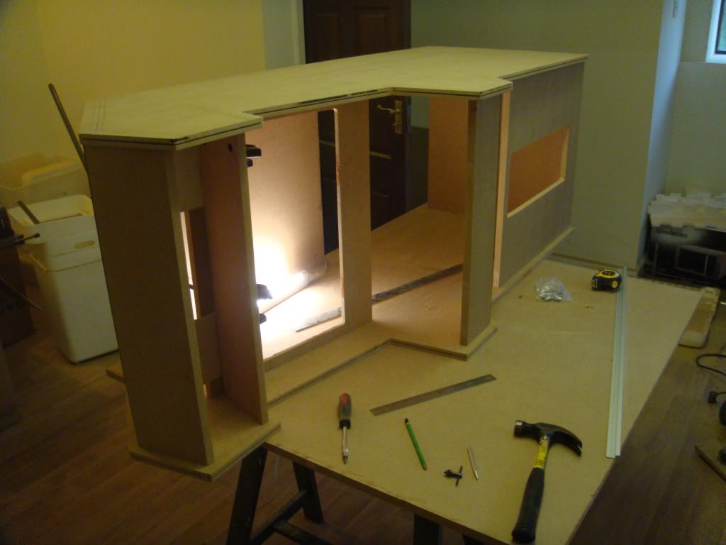

A little more progress today.
I haven't attached the side panel on the top, I just wanted to see what it would look like.

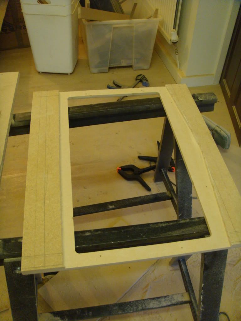

I spent all day Saturday working on the cabinet.
Finished the base, I may need to add a couple of struts as support. We'll see once I attach the casters.
Routed out the bezel for the monitor. I wanted to inset the monitor to reduce the space from the perspex and the screen. Its a little rough but it will be hidden plus a little bit of filler will smooth off my dodgy routering.
Cut out the coin door hole.
Progress so far.
I drew out where the panels will go on the other side panel........I picked it up to put it on top and then it dawned on me. I'd drawn on the wrong side  :angry: :banghead:
After redrawing the pattern on the correct side I was able to fit everything together. It took a bit of fettling in places though.
Still lots of things to do. A trip to the DIY store tomorrow me thinks.
