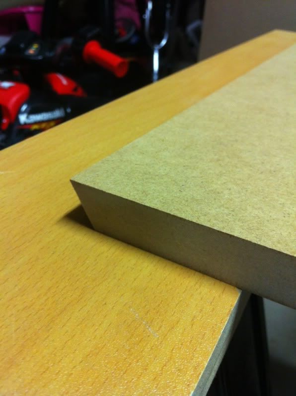

I've been using this and I'm very happy with it...I cut 3/4 MDF, 3/4 Ply, 2-by...basically everything in the course of a year.
http://www.lowes.com/pd_59914-70-DW3578LX50_0__?productId=3341684&Ntt=dewalt+blade&pl=1&currentURL=%2Fpl__0__s%3FNtt%3Ddewalt%2Bblade%26page%3D2&facetInfo=
Hope that link worked...if not, it's at Lowes and the product ID is DW3578LX50
DeWalt 24-tooth segmented 7 1/4.  It's a nice, thin blade (1/16-ish).  I've built my entire cab with it after finding my "fine" blade (bought for this very cab) had almost 1/2" of runout (wobbled like a drunk frenchman).  I brought it back and decided to try this on the MDF.
I think because it's so thin and has a slight kerf, it cuts really nice through MDF.  I've also ripped 3/4" ply during this project and the cuts are supreme...no flash and absolutely no chipping.  Honestly...it's a fantastic all-arounder and I'm very glad that my ply/fine blade had to be returned.
These cuts were made with this blade on a 2.3HP Skill 12-amp (it's about a 5 year old saw.).  I always use a straight edge.
This is a 4" strip I ripped from a 4'x8' 3/4" ply sheet.  The edges are better than the edges from the factory...
This is my crappy saw.  I had to lose the good one.   :badmood:  So, I bought this in a pinch about 5 years ago and it hasn't broken yet.   :timebomb:

Very nice cuts! I was thinking more teeth was better? Something like this:

mcseforsale is on the right track. Your 150 tooth blade is what is commonly referred to as a plywood blade - they are only good to use under limited circumstances - cuts certain types of thin plywood without splintering.
For a good all purpose blade for wood, mdf, and plywood, the 24 carbide tooth blade is great and that Dewalt one is decent quality. I've used them myself.  In general, more teeth = smoother cut, up to a point of diminishing returns.  As teeth go up, more power is required and feed rate is reduced.  I wouldn't go for a 60 tooth blade in a circular saw.
I would toss it and get another $10 blade at the first sign of dullness/burning.
