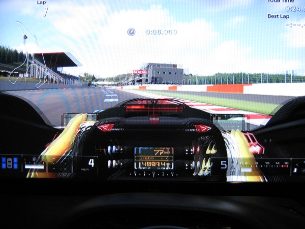

This is the setup now, the screen in BIG
I have been “testing” Gran Turismo 4 and Colin McRae 3, and its all good
Colin McRae 3, cockpit view

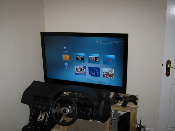

so i went alot wider, i also thought about the design, building the screen support into the base for extra strength. anywahy some pictures
seat base and screen support half done and the main base
from the other angle, with seat
dash put on
you can see that the seat base is off set toward the left hand side of the dash,
screen test fit
when i offered up the screen, i realied how crap i cut the dash, i will probably be able to bodge some thing to mask this up, and TBH you only see it if your looking for it. no photos of that

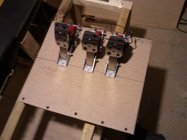

first up today is fitting the pedals.
started off with this
un bolt them from their plastic housing (16 screws held the top of the plastic case to the bottom, plus 12 holding in the pedals)
after alot of measuring etc, i screwed them to a piece of wood.
after alot of buggering around, screwing in, testing the height and angle, etc i settled on this as their final position
happy with that, i turn my attentions ot the steering wheel setup. i took the base unit apart to see whats inside, a couple of heafty motors, some wires and a circuit board, and some air
to my surprise. the unit fitted in the dash, without comprimising on space anywhere,
with with the whole dash on
still not sure how im going to or out of what i will make the steering column.
and this is how i left it for tonight

right, minor update, but with major impact
after a bit of testing, i found the steering column bracket to be too much different angle to the column, so i adjusted it, and filed the inside of the bracket. then added some copper grease.
the wheel now moves free, and no squeaks etc
a vid to shoe how free it moves when switching on, compare it to the vid i posted earlier to see the difference
i then got the big tv out to have it setup properly
i have changed my mind, the PS3 is going to be part of this rig, meaning this TV is not high enough quaity, so after xmas i will buy a cheap 1080p LCD to put in, i hope Best Nuy has some decent discounts
i've also fitted all the dash parts now and it all fits and is very secure/solid

and the last purchase was the screen for it, a Technika 42" LCD TV
its a good TV, its not amazing, but its good. its nice to have a screen that i can read the text on, as my other test screen wouldnt do 576i, this one does 1080p, and it shows
this isnt my poor picture taking, but it shows it party piece, yes the screen is 3D. how i ever got my G/F i needed a 3D TV i dont know, the 3D isnt amazing on this screen, my LG 42LW550T in the living room blows this screen away, i think its part due to the distance i'm sat, plus i need to play with some of the settings.
