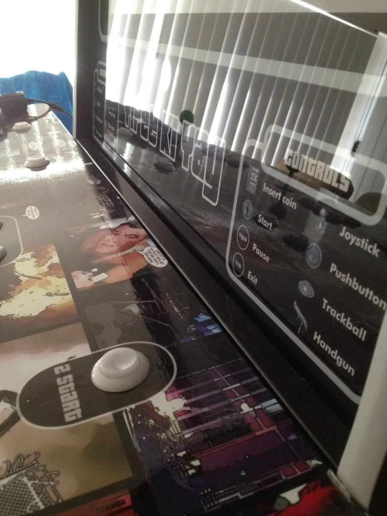

henbury
  • Posts: 15
  • Last login:June 14, 2013, 10:38:10 pm
Re: joystick and push button confusion
« Reply #23 on: June 19, 2012, 06:40:04 pm »
I mounted from the underside and used bog filler for a flush finish on Yipee Ki Yay.
http://forum.arcadecontrols.com/index.php?topic=120827.0
Skip to the "control panel" and "control panel assembly" sections.
As i describe alongside the pictures, the only thing I might reconsider is jigsawing to allow for the baseplate only, and routing out underneath to make room for the micro switch bundle and harness plug. Then I mite not have had to fill in gaps with galvanized sheet. Don't use expanding foam it doesn't work.
