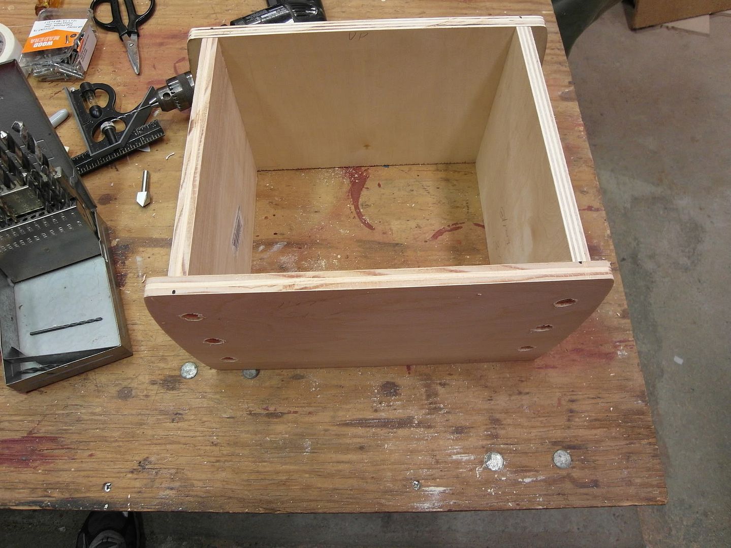

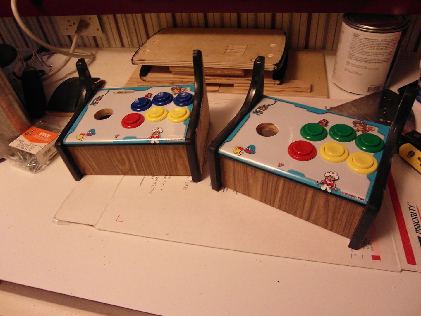

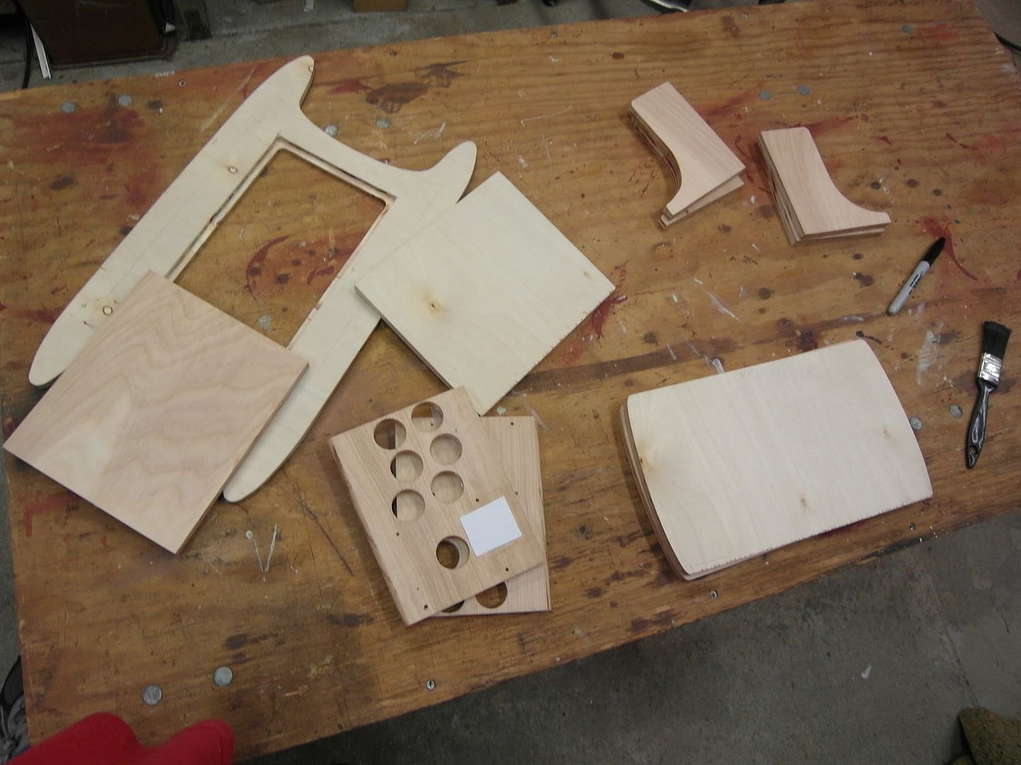

I’ve been working on this one for about a month or so on and off. Figured it was time to share with everyone.
It’s a “mini” cocktail machine :D I know how much everyone loves ‘um.
Anyways quick build specs - used ½ inch beech plywood for everything, PC is a repurposed Acer Aspire One (N450 Atom, 2GB ram, 160GB HD, 10.1 LCD), Xin-mo  usb controller,  Happ Ultimate sticks and Happ buttons.
I’m between jobs at the moment so I thought this would be a fun project and maybe make some cash selling it when its done, if I can part with it lol.
Now for part you’ve been waiting for -  Pictures!  :applaud:
I’m not one to take build pics as I’m going but I did snap a few. First few are of 3D Renders in SolidWorks .
Enjoy!

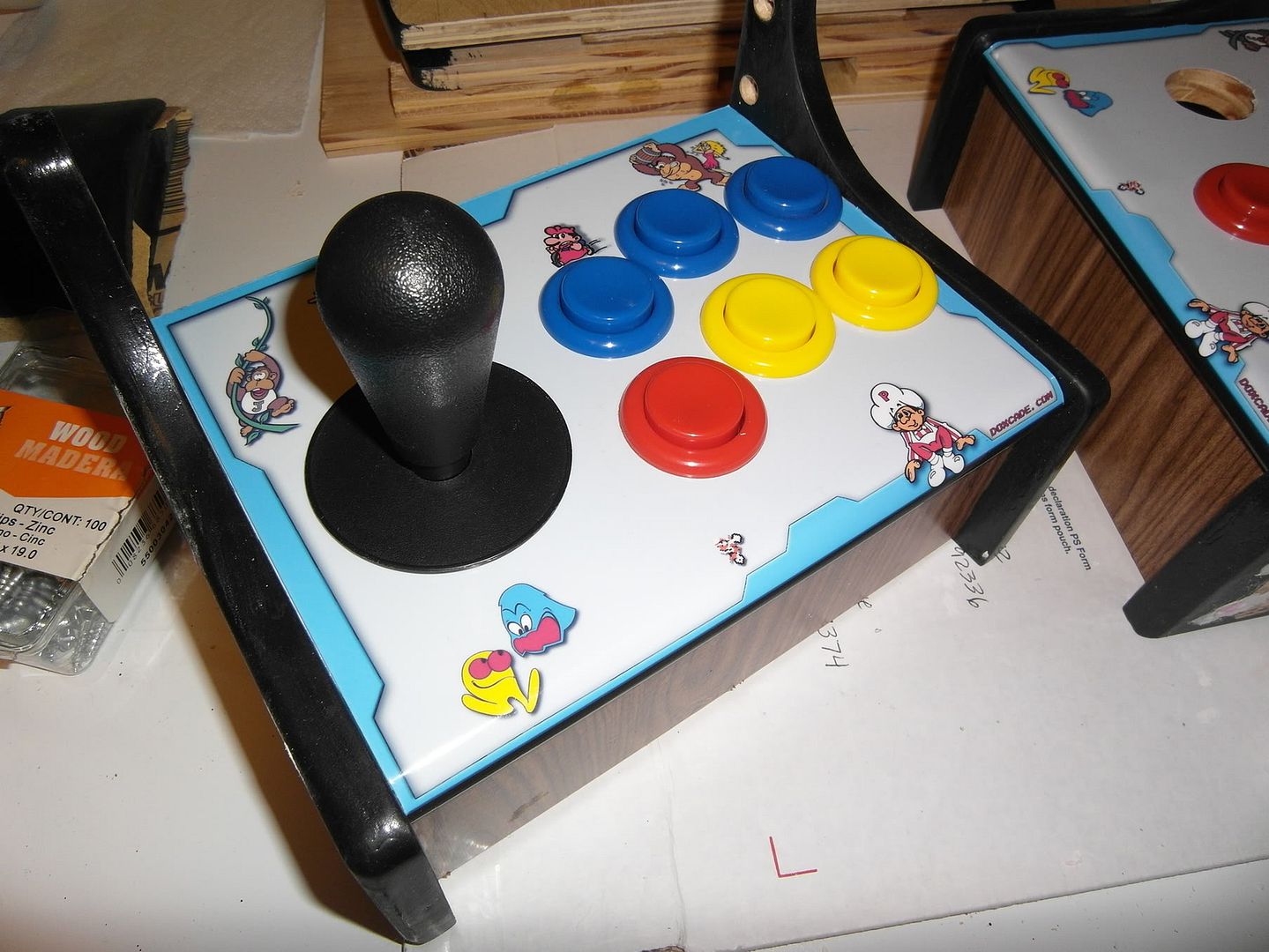

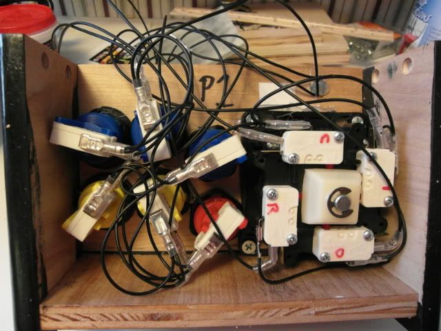

Very nice work so far. The buttons are extremely close to the right side, didn't you have room to have them a bit more to the left? What joystick did you use? With such a small cabinet and low weight, I would suggest going with either a Sanwa JLF or a Seimitsu LS-32/LS-33 for both space and joystick force.

Thanks! Due to low build budget I had to "borrow" parts from my full size machine for this one. I used old Happ Ultimates as you can see in the pic below theres zero room left over. Next build I plan on using better sticks and smaller buttons and also angling the control panel a bit.

As you can see in the pic below theres zero room left over.
And I thought it was cramped underneath the control panel of my MVS-99-6 cabinet.
Then again I'm not finished, and that's a Sanwa JLF and four 24mm buttons you see there, with 20mm buttons at the top (well, the bottom if you look at the photo).  ;D
