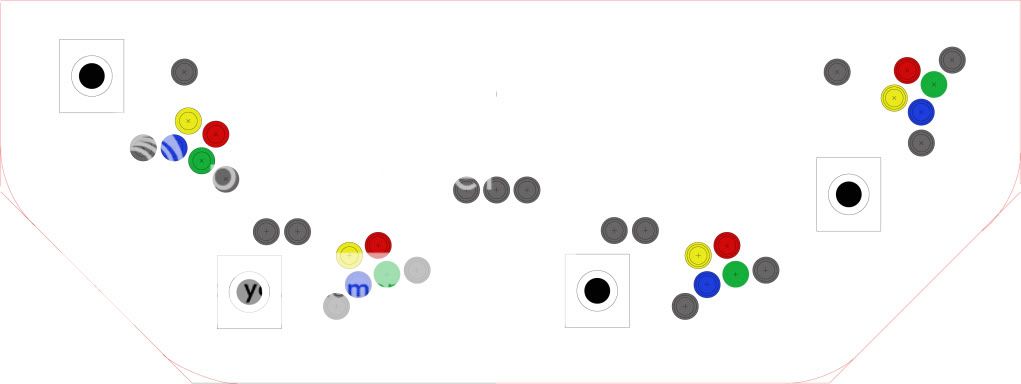

Ok, so I've been thinking more about the button layout.  Thanks to Kevin at ogredog.com for the template.  I'm thinking that I'll have all the buttons except black and white buttons as well as players 3 and 4 will lose the select button.  The three buttons in the middle are for player 1: black, white, and analog click button.
Any thoughts.  Anyone have experience doing a 4 player xbox control panel build?

I hope you're not planning on playing any Street Fighter with that layout...

good point, what about this one?

better :dizzy:
