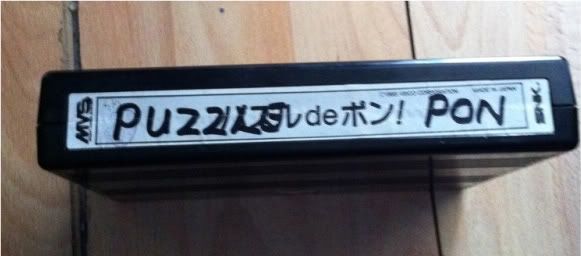

basicly i bought a old arcade cabinet a few days ago,was bought as repairs needed.The monitor rolls upwards constantly,The cabinet has a neo geo mvs ,and on the cabinet it says Supreme video on the cabinet header.I was told to try turning the vertical hold on the back of the monitor to see if that does anything but it doesnt speed up or slow down the rolling.I am a total noob when it comes to arcade cabinets,so this is the first one i have owned.I have some pictures if anyone can give me some ideas what to look at.The machine powers on fine but soon as the neo geo screen comes on it just rolls upwards,The cart in the machine is puzzle de pon,i think its a jap cart so not sure if that makes any diffrence
