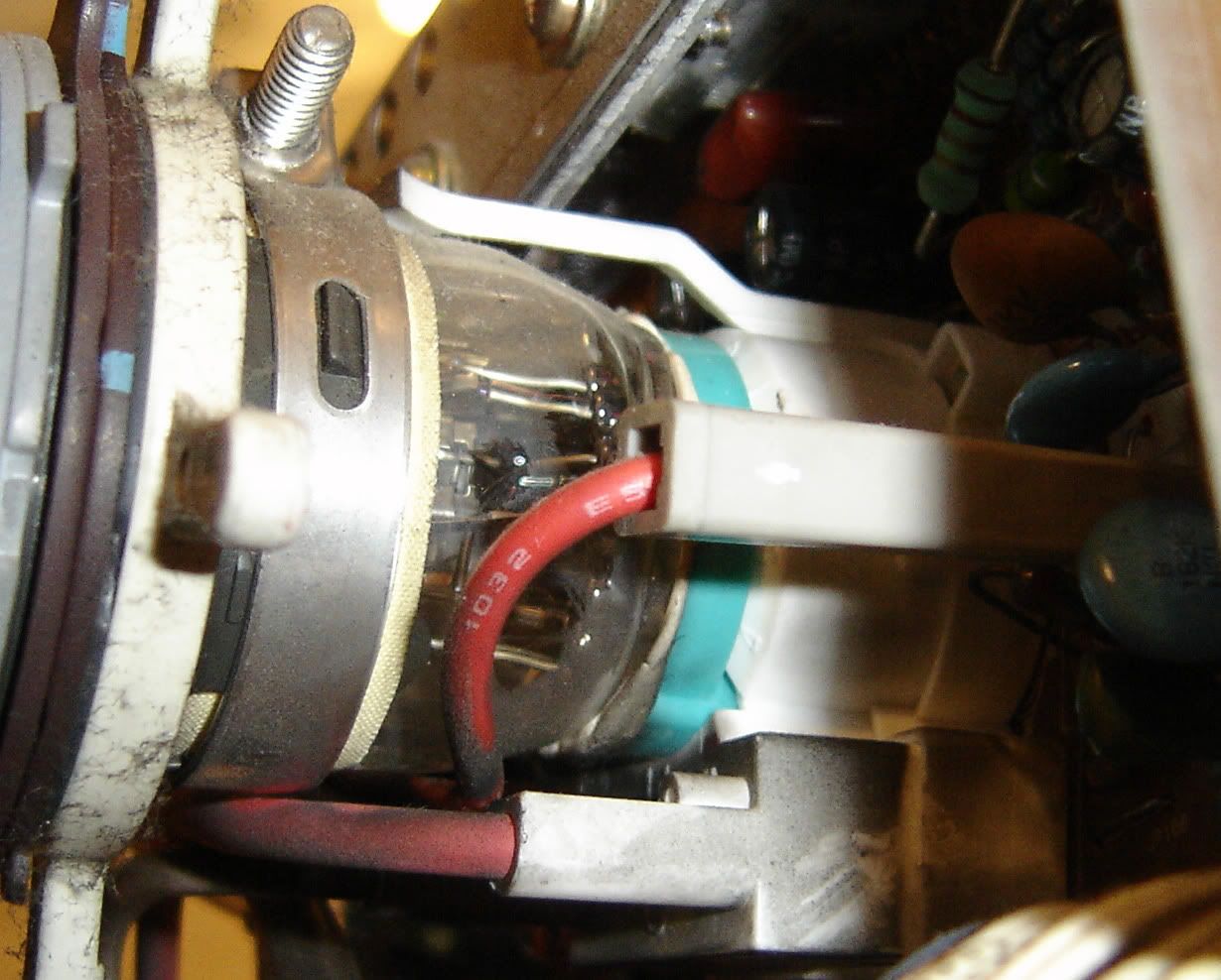

In the pictures, you can see that there's a green plastic belt around the socket. So I have to cut it before trying to pull the neck board off the tube?

Didn't notice your pictures.  The green "belt" is probably not attaching anything, but there does appear to be a white clip up top that you may need to release somehow.

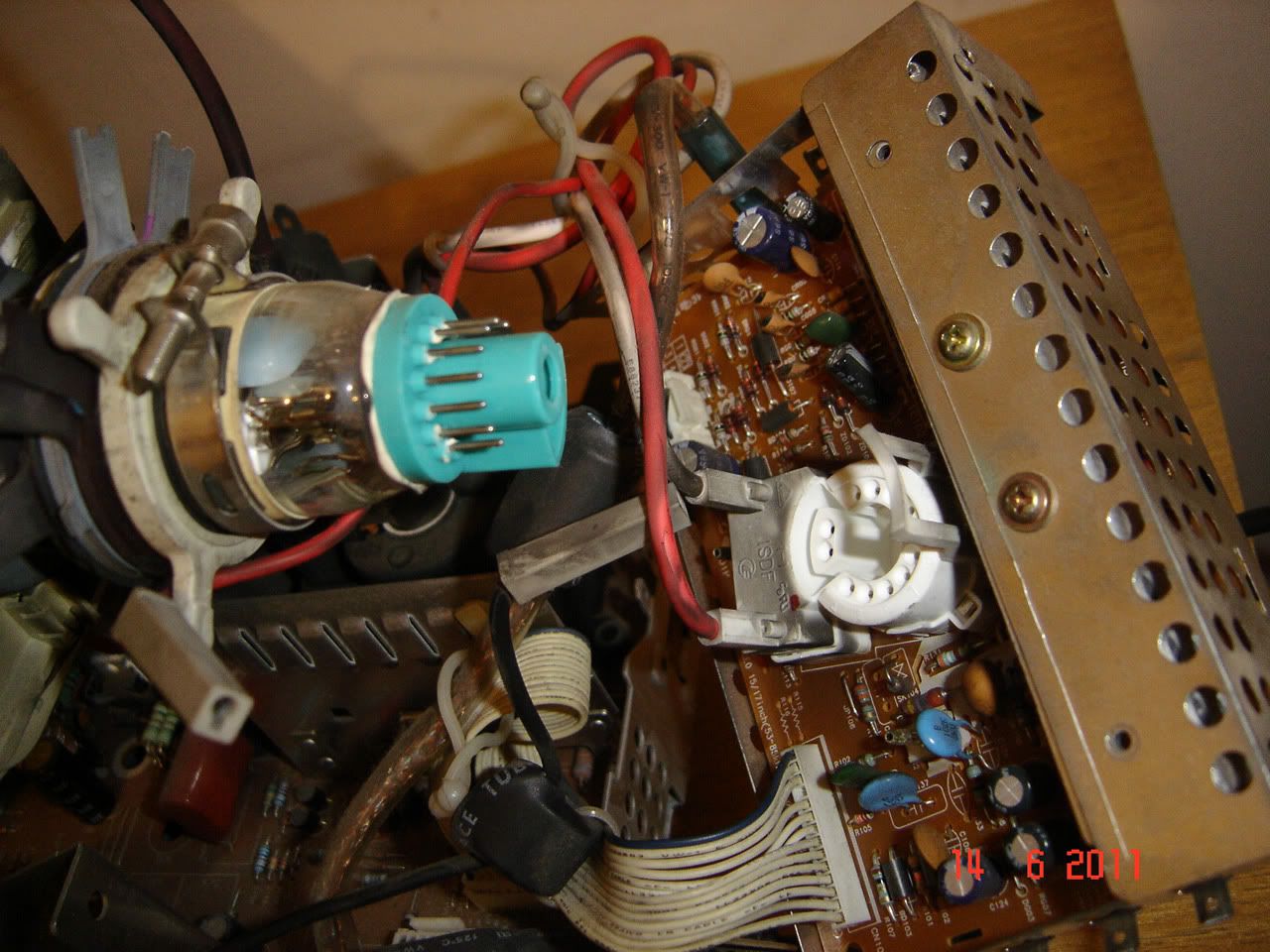

Here is the green belt: link. It's a hard plastic and thick. I took some pictures that show that it looks like it goes under the socket aswell so I'm afraid it's part of the locking mechanism? I will post the pictures soon. * EDIT * Pictures: [1, 2]

Finally I managed to pull it off. The green thing is indeed part of the socket.
After some hours trying to remove the shield I finally removed it too (damn I need a third arm! :angry:). And... after a quick look I couldn't find defective solders. Just tested the RGB connector (the one that plugs into the neck board) and VGA connector (continuity test, bending in the RGB wires in every direction) and it looks ok, no bad contacts. Looks like I will have to make a lot of tests.
