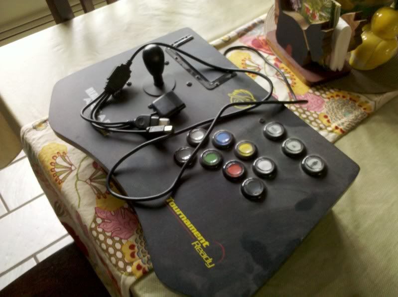

Found this up in the attic:
I think it would make a perfect portable mame setup.
Ideas:
New buttons
Small itx/nettop mobo inside
VGA/DVI port on the back
RCA Jacks out
Headphone jack
Usb ports on back
Plug into TV/LCD/HDTV to play some mame
have it boot straight to hyperspin
I'm going to get to work on this tonight

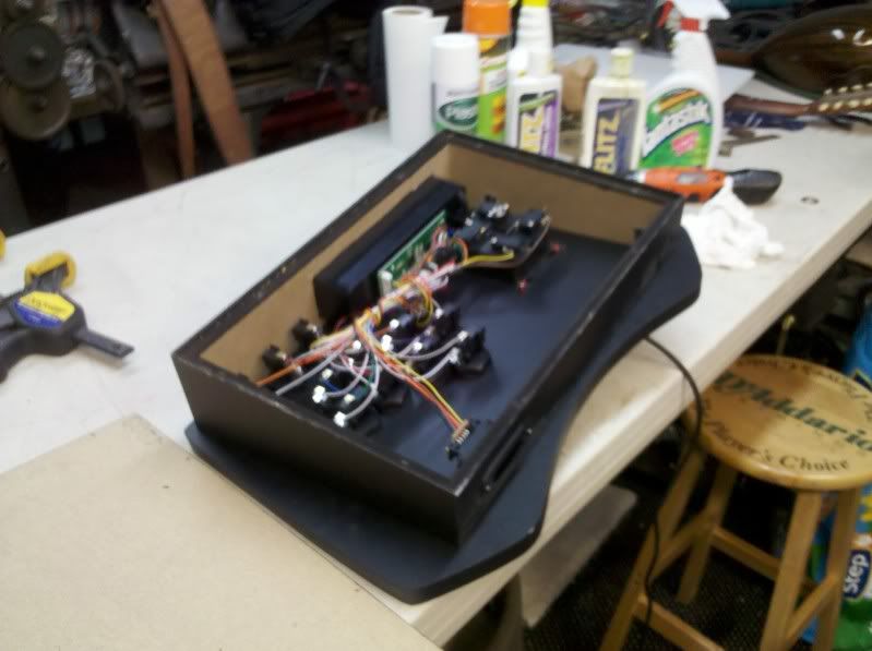

Some things to consider...
1) is there enough clearance in there for a netbook? Looks pretty tight.
2) can you give it enough airflow
3) how are you going to power it? or turn it on?
Keep us posted

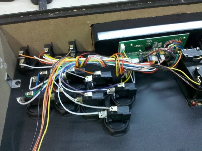

so just popped it open and seems it's gunna be a tight fit:
But i think it will work!!
First, can anyone recommend a really small itx factor mobo that can handle basic mame and a very slim tinyxp build? I'm assuming they have these types of mobos that cater to the htpc croud? something small form factor like say the apple tv or something, i'm kind of out of the loop with the atom/netbook croud..
Also here's some more pics of the controller pcb.  Notice how ---smurfy--- pelican just soldered right to the posts, placed thick goops of glue to hold the shotty joysticks in place...
notice soldering directly to switches, lol. i guess i should expect it when dealing with crappy parts.
Second, I need to use some really short buttons, something like a candy cab with low profile underneath, but that wont work since the cp is not a thin sheet of metal, its 1/2 inch mdf.  I'll need to find some buttons with short profiles
Also i need to get the correct clip leads to solder to the wires for quick disconnects.  I have a bunch downstairs just don't know where i put them when i finished with my street fighter II restore.
i believe there is enough clearance for a mini itx, definitley enough for my msi netbook bottom without the lcd connected. that's assuming i leave the same butons in there which i am not going to do.
i believe a fanless system wouldn't need cooling beyond open space, for example my atom netbook runs cool with osx hackintosh 10.6.2 overclocked with just a stock crappy heatsink and the fan removed.  I believe even in the most powerful scenario, an i3 intel processor with a stock heatsink, which is overkill in my mind, i'd probably get away with just removing the plastic case on the unit where the controller cords were meant to fit, or i could just cut a circle in the side and put a ball bearing coolermaster fan on the side blowing air in at low rpm towards the processor heatsink.
standard mobo's have a pin junction for connectors to fit and a diagram. it's just a matter of connecting momentary switch to the PWR on/off to get the mobo to turn on and off.  I plan on using a happ button to make the connection here, placing it on the side of the unit hidden from view.  worst case i'll wire it to a small led lit 24mm button i have lying around from a candy cab cyberlead i finished off and didn't use.
