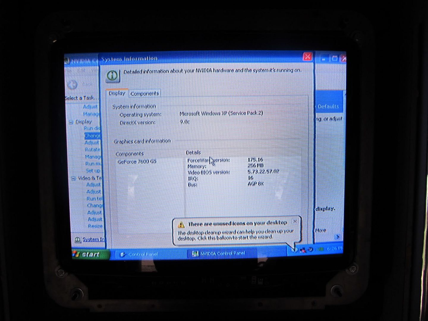

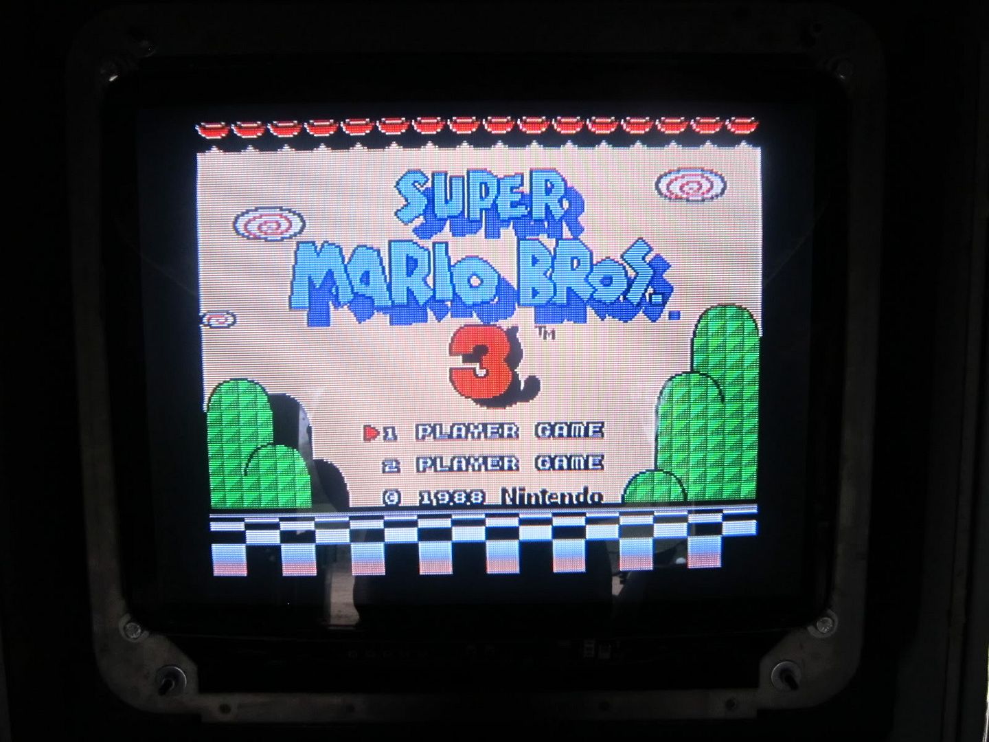

elkameleon
  • Posts: 528
Re: Sony Wega 24'
« Reply #26 on: April 25, 2011, 03:07:44 pm »
I actually picked up this exact tv set for my arcade and had all the problems you described. I had the blue tint on component out, but after hours of ---smurfing--- around I finally got it working perfectly. Unfortunately I did all this last fall and don't remember what I had to do to get it to work. I just finished making a custom chassis for the tv to fit into my arcade cabinet last week.
http://www.facebook.com/media/set/fbx/?set=a.10150169075371752.294390.508456751&l=e070af86cc
EDIT: Forgot to mention, i'm using a nvidia geforce 7600gs. Its what I had laying around that was AGP and had component out. I believe what I did to fix the issue was actually roll back my drivers to the ones that came with the card, and it fixed it. I will confirm my driver version tonight when I get home.
EDIT 2: My current driver version is forceware 175.16
« Last Edit: April 25, 2011, 07:39:07 pm by elkameleon »

« Reply #27 on: May 18, 2011, 09:42:51 pm »
Ok,so I have component working and the colors look great, I'm running 480i/30khz. Now two more problems have presented themselves.
A) There is a little bit of flicker and I have no control over it.
B) The screen is no completely filled out
 :banghead:
elkameleon
  • Posts: 528
Re: Sony Wega 24'
« Reply #28 on: May 19, 2011, 01:12:59 pm »
You'll have to adjust the settings in the video driver to get it stretched to fill the screen, that's what I had to do. There should be a setting for flicker reduction, but its going to be noticeable on the windows desktop, but when you are playing a game, it goes away.
