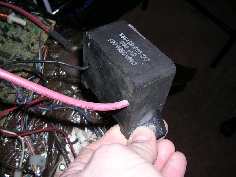

Checking out a WG K7000 series chassis for adidas1984x who bought it complete with a tube, but it had a crushed remote board.  Since I have heard you shouldn't try to power one on with a remote board removed, I figured it would be a bad idea also to do it with one as bad as his was (all pots were destroyed!).  So he sent it to me to check on one of my tubes (while he waits on Bob Roberts to ship him a replacement) since I had a K7000 series remote board I could swap to it for testing.
Well, after reflowing some bad joints and checking over the chassis, I just don't know what the black box in the pic is for.  Can you guys enlighten me?  It has a heavy gauge red wire going to the anode cap (along with wire from flyback) and a lighter gauge black wire from the black box to the metal plate the HOT's heat is dissipated to.  Here it is:
Unknown part:

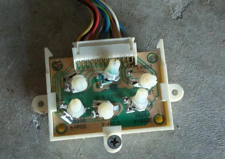

His damaged remote board...ARGH!!!

i've never seen that in my life before... does it just have the 2 wires or does it have a grounding tab that connects when you screw it down someplace? of course google doesn't turn up anything, although the # is similar to the flyback# for the WG... 046X0560-003
maybe it's dumping voltage from the anode... maybe an automatic tube discharger? maybe it's a voltage doubler...  :dunno

I think you're right about the discharger:
Next will be making new safety bleeder boxes to spec for some of the larger screen rasters found on 7600 39" & some u5000's.. While I know the demand for those will be short it will be settling to know they will soon be avail.
wells part # 046x0560-003

That black box is pretty much a large capacitor with a grounding lead.
Helps to quickly bleed off excess HV when the screen flashes, namely from gun games and such.
Replacement flybacks will not have those.
I have never had any trouble running gun games without one, but that seems to be what those were most commonly found in. (as far as I have ever seen)
Might be other games that have some form of extreme "flashing" that goes on, dunno.

Dont worry, Hes getting a fixed remote board...  I got the board right now, waiting on parts...

  lilshawn, there is only two mounting spots made from the plastic on the casing.  Not sure exactly where this mounted on his monitor as it was loose as pictured when it shipped to me, but definitely no grounding tabs.  Just the two wires pictured.
cotmm68030, very similar part #, but the funny thing is, this came from a much smaller 25" tube supposedly.  Not a large one like the 39" model in your quoted text.  Guess they made them for smaller ones too.
Kevin, thanks for the identification.  I don't think he's putting this back into a gun game, although we just got a different chassis going for his Area 51 cab.  He wants to do a flyback and cap-kit install, but i am not sure I have the time for it at the moment.  Just trying to see if it works as is with a good remote board.  Somebody has already installed a few new caps, but not a complete kit it appears.
It typically mounts to the frame rail just above the flyback.
That smaller black wire is the grounding lead, it typically just gets tucked under one of the screws that mount the block to the frame.
Can't get to one of mine right now, so I just nabbed a pic of the net to kinda show you where it would be mounted.

Well, the $12 kit has 6 pots to solder back into a remote board, but he claims on his site that he occasionally comes across K7000 remote boards and rebuilds and tests them to resell for $20 for the complete board.  I THINK he told me he ordered a complete board from Bob, but I could have misunderstood, or he simply wants someone to rebuild the old one to have as a backup in the future.

Chad at arcadecup.com sells brand new complete k7000 remote boards.

P632/P802 Remote Board
$17.50
(+ shipping of course)
