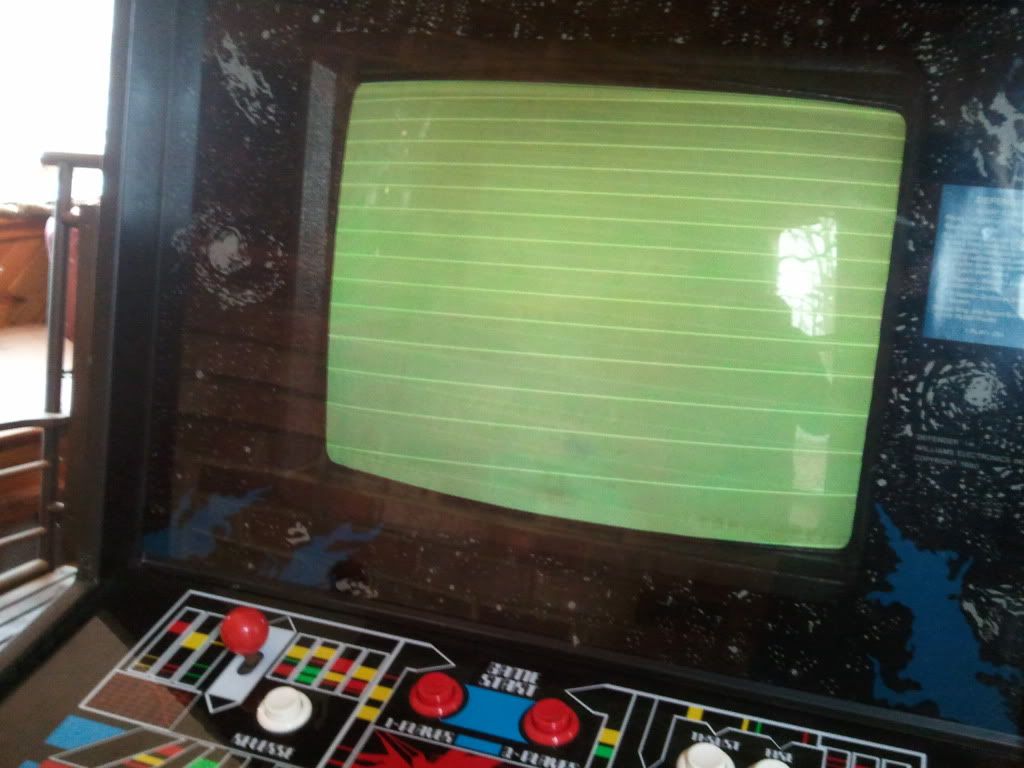

Hey all, I have this Defender machine I am trying to get to working order again, and the on-machine diag is less than helpful...
When the cab is powered up, it makes the little start-up sound/jingle thing, and nothing more, the monitor looks like this:
It has the 4 LED diagnosis instead of the alpha-numeric one, and on start-up all 4 leds blink twice. According to the manual this means all is ok? From what it appears the game doesn't even boot up, no Defender "growl", the start buttons don't do anything.

Re: Need help with Defender troubleshooting..
« Reply #1 on: January 21, 2011, 05:42:46 am »
Adjust the flyback on the monitor. The brightness is way to high. It could possible have something on the screen and you would never see it.

Thanks for the tip, pinball
« Reply #2 on: January 21, 2011, 11:46:24 am »
Thanks for the tip, I turned it down, I recorded a short video of all I get:
