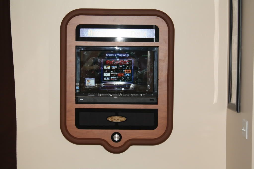

Wow, sure has been a while since I posted a project on here. I have been quietly, and slowly, building Mountain Jukebox kits for the past year, so personal projects get pushed aside (still plan on finishing the Fantasy machine). I was asked last year by a member of this forum to build a one-off jukebox. I was given this HP Touchsmart 600 and these Bose CineMate GS Series II to work with. Yep, a 23" 16/9 wide screen, all-in-one.
The customer wants a wall mountable jukebox, but he also needs access to all of the ports and optical drives that are on the side. He also asked that a matching enclosure be made to house the sub unit just below, closer to the floor. This thing is going to be BIG. Massive.
I spent a lot of time designing this juke towards the end of the year but was bombarded with year end deadlines at my "real" job. Although the deadline came and went, the customer was very understanding.
I was able to get a lot of work done in the past few days since I took some well deserved days off. Using my CNC, I first started by cutting the frame of the juke out of two 3/4" pieces of MDF that I glued together.
Today I made the center part of the front panel.
It will be glued to the trim piece once it is wrapped.
This piece will eventually be chamfered on the inside and rounded over on the outside. I will be wrapping the trim in this vinyl.
The back of the main panel. Once the trim is wrapped in vinyl, it should fit like a glove. The stapler is there as a reference to the size of this beast.
The computer/monitor has a high gloss bezel surrounding the screen. To help with aesthetics, I will match this with gloss black acrylic around the marquee, speaker, and volume knob openings. These will be back mounted and polished.
Here is some video I shot today of the parts being cut on the CNC. Sorry, it's a bit shaky. It's the first and last time I use my iPhone for videos.  :-\
Stay tuned.

Here are some shots of some of the parts I made this weekend.
The part on the left is the speaker grill insert. It is made from acrylic glued to 1/2" MDF. It will be back mounted to the wood laminate face and the grill material will be back mounted into the two openings you see here.
The oval in the center is for a special plaque the customer has requested. It will be made from .030" brass and engraved with text.
I was also able to finish hand routing the trim piece. it has a 45 deg. bevel on the inside and a 3/4" round over on the outside.
Here is a quick tip: Instead of using regular Bondo or wood filler to patch small holes, like above. I recommend using glazing putty. The stuff is smooth as silk and dries super fast. Plus, it works straight out of the tube, no mixing.

I've made a lot of progress on the juke, just haven't found the time to post.
I wanted to round over the corners for the sides, so I made a jig to bend each corner piece.
I used the CNC to relief cut two 1/4" pieces of MDF to wrap around the jig.
Here is the first piece clamped.
Then the second. I used polyurethane glue (Gorilla Glue) for this.
To make it easy to locate and clamp the finished corners, I cut a pocket .1" deep into the back plate.
All done

I was also able to get the front trim wrapped.
Spent some time tonight polishing the acrylic inserts too.

Some more pictures of the build. The customer is coming to pick it up tomorrow.
Here is the sub "enclosure". It's more decorative than anything.
This is the light box for the marquee.
Here is the switch for the marquee light. When the right switch is in the on position, the marquee lights when the dor is shut to prevent scorching the customers eyeballs.  :D
mountain
  • Posts: 1205
    • Mountain Jukeboxes
Re: Mountain's Massive Juke build log
« Reply #31 on: May 13, 2011, 09:55:51 pm »
And here are the final pictures.
The vent at the top with fans blowing the air up and out. There is a vent at the bottom to allow cool air in.

« Reply #39 on: May 16, 2011, 05:41:17 pm »
I was going to let Mike tell this story ...
But I wanted to include my part ...
Almost a dead ringer for what Mike came up with ...
I am going for the wireless look .... I forgot to have my drywall guy add power to the sub woofer ( but he will be back ) and I need to run that video cable under the carpet ....
Side Shot
Scale Shots
I will get some inside cabinet shots soon ... Pretty cool they way it all comes together ....
Jason

« Reply #41 on: May 17, 2011, 02:22:31 pm »
Is there any foam or anything around the pc to close the gap when the front is closed?  Or is it just a tight fit/absence of light inside the case where they interface?
Really excellent work.
Jasonmm
  • Posts: 213
  • Last login:July 30, 2021, 01:07:46 pm
« Reply #42 on: May 17, 2011, 05:23:10 pm »
No foam , just a nice tight fit in a magical kind of way.
J
