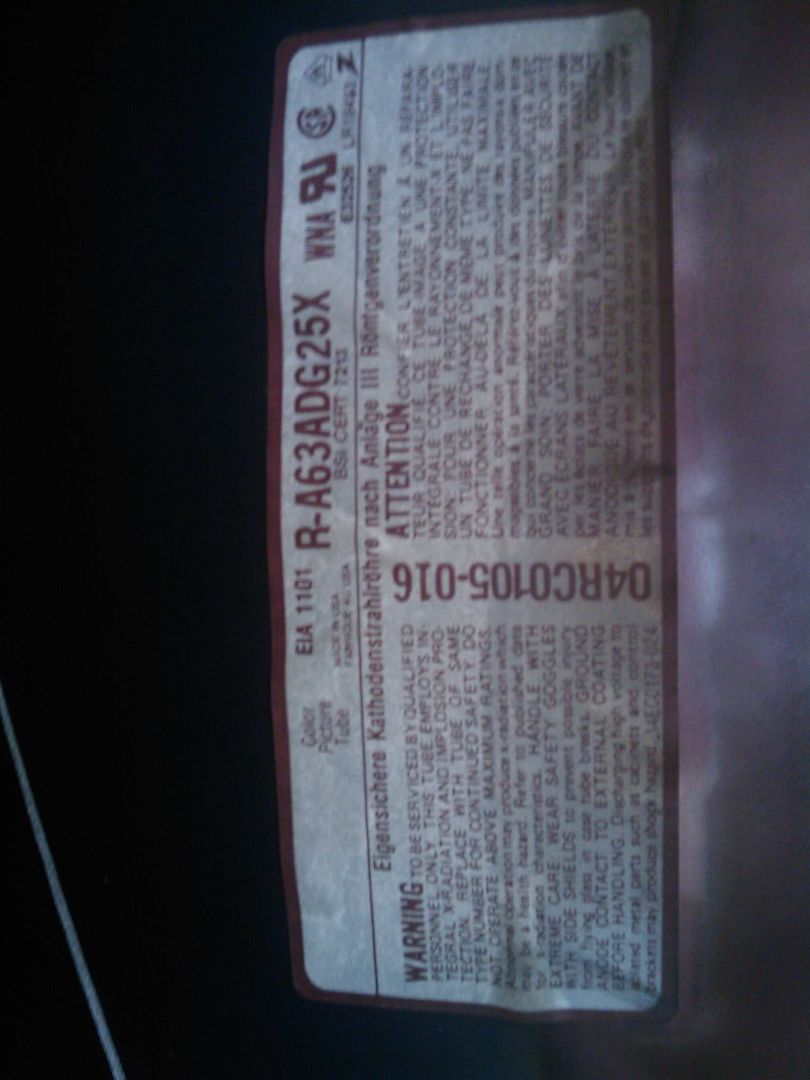

numbers on my monitor are: R-A63ADG25X
serial number: 1096154
grantspain
  • Posts: 6177
Re: NEWB with monitor issue on my first MK3 arcade (video included)
« Reply #3 on: January 06, 2011, 06:01:46 pm »
thats the crt number

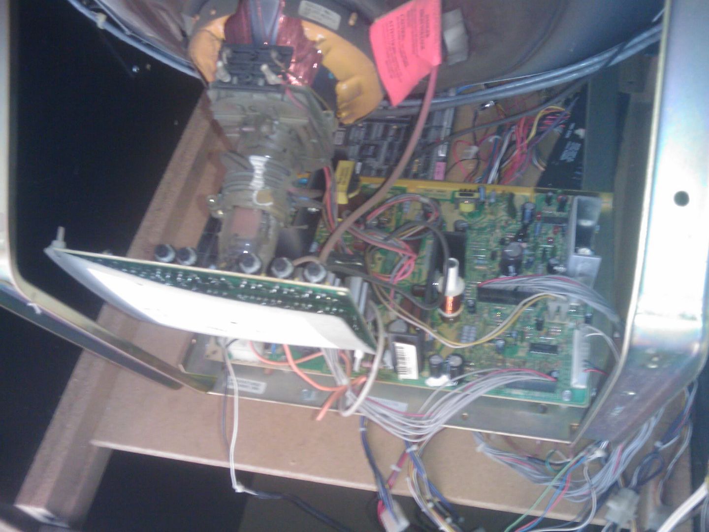

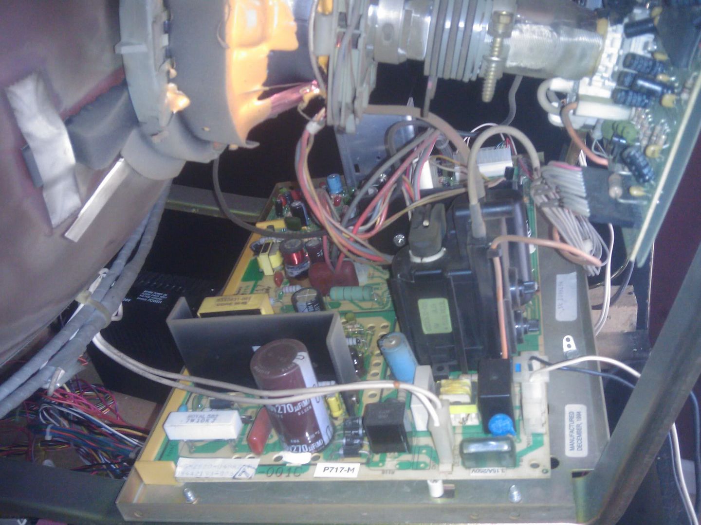

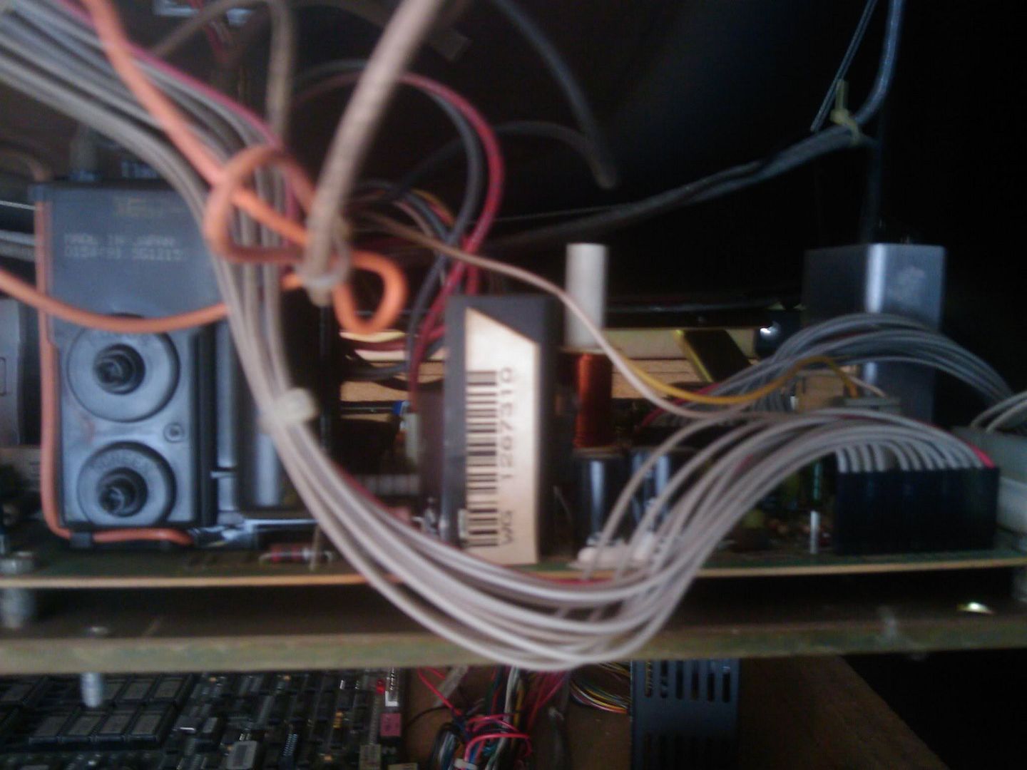

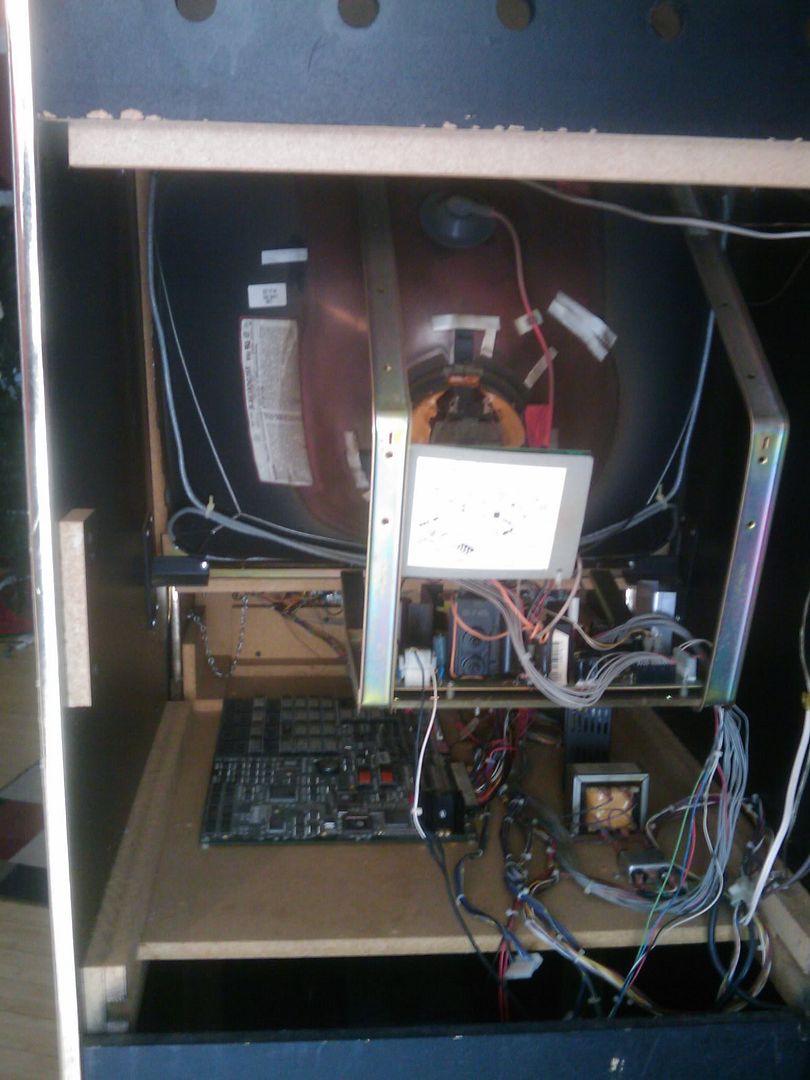

well that serial number was on the tube and board in the back, figured that was it. and its not the original midway case just to throw that out there. here are some pics of the cabinet and board for the monitor.
grantspain
  • Posts: 6177
« Reply #5 on: January 06, 2011, 06:31:21 pm »
quite sure thats a 25" k7400 but I would wait for someone else to confirm this is the case as I have not seen one for about 5 years

« Reply #7 on: January 06, 2011, 07:26:36 pm »
there is a sticker on pic 4 nearest the crt

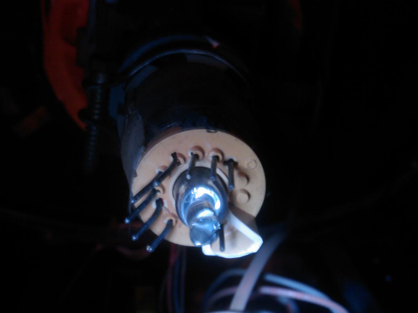

well...bad news, i just screwed my monitor up im pretty sure! was being careless and trying to clear out cobwebs and accidentally hit the board that connects to the tube. the pins on the tube are all bent. lemme snap a pic and see if its actually repairable. prob not =(

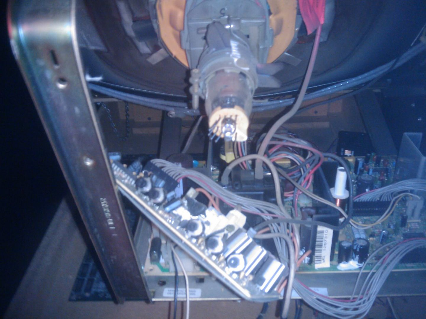

« Reply #9 on: January 06, 2011, 08:11:35 pm »
theres the damage...wtf to do now! buy a new monitor of course but do they come with the boards so it would be plug and play? or should i get just a monitor and use my boards? if i do that tho i would be stuck with the problem i would think
oh and im pretty sure the glass at the end of the tube is broken along with the tab thing at the bottom right...

« Reply #10 on: January 06, 2011, 10:01:51 pm »
That doesn't actually look broken.  That looks like it was just cut at the factory to make room for the little plastic cap they put on to separate some of the higher voltage pins.  The pins are definitely bent, though, so you'll have to CAREFULLY bend them back into position and re-attach the neck board.
If the glass really is cracked, the tube is done for; you'll have to throw it out and find a new one.  You would have probably heard a loud "hiss" sound if you broke it as the tube lost vacuum.

« Reply #11 on: January 06, 2011, 10:28:40 pm »
oh wow thanks for the good news! i definitely did not hear a hissing sound when i popped that kneckboard off so maybe it is good. i know i cracked the kneckboard a bit where it connects, that plastic seems real brittle. of course it is for its age. well do you recommend discharging the tube before i bend the pins back? actually you called them high voltage pins so ill def discharge it lol if i have to get a new monitor where do you recommend i look and which one should i get?!? very new at this stuff sorry

« Reply #12 on: January 06, 2011, 11:15:25 pm »
As long as you're not messing around with the anode contact under the "suction cup", there's really no need to discharge it.  By "higher voltage" on the neck pins I was mostly referring to the focus voltage (a few kV) and G2 (~600V), but those are only present when the monitor is on and operating.

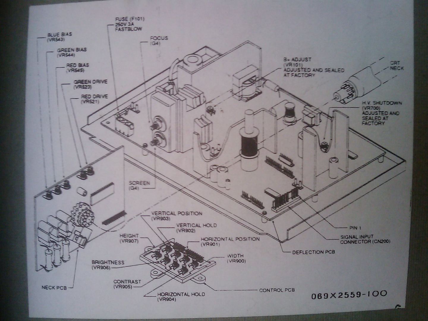

If the chassis has a 50-60HZ pot then with the screen in the distorted state, adjust the 50-60HZ pot till the lines just disappear.

yeah i checked for that pot and i do NOT have it =(
i have the U2000 board that does not include that pot...bob recommended changing out my LA7850 chip so i guess ill be doing that soon
