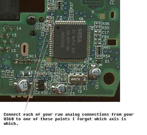

« Reply #5 on: November 28, 2010, 04:29:09 pm »
the DC really did not use the actual analog sensitivity/function except on a handfull of games so getting true analog is not really needed for the most part.
JUST QFT.  I looked into hacking the anlalog directions on the Dreamcast pad before.  Somewhere in circuit between the main IC and the hall effect sensors the signal is just 0-5 volts.  I have successfully tested an official Dreamcast controller with a Ultimarc 360 in it's 0-5 volts output mode (I've forgotten by now which this modes name.)  So, yes it is of course possible.  (the triggers are also 0-5v or 0-2.5v somewhere on the pcb  - I cannot remember now...)  I have since lost interest because now NullDC has Analog via PURUPURU plugin.

« Reply #7 on: November 28, 2010, 06:45:11 pm »
yes that works, I tested it that way before I tried my U360.  IIRC, I actually used the 5V and ground already present in the controller's wiring or on the PCB somewhere.  I still have the controller in a box and maybe some photos somewhere of the test points I had soldered my kynar wires on my photobucket.  I will try to link them later if I find them/remember.

« Reply #9 on: November 29, 2010, 06:26:18 am »
here are the 0-5v points I used for the 360 test.  (succcessfully tested with MDK2 by spinning the view slow/fast)
Hello All,
I know it has been a while since I last posted in this thread,  but I have been on the fence about going with a real Dreamcast v.s. emulation via NullDC.
For me the biggest con with using actual hardware is the need to swap out discs per game.  Along with that also comes the concern with how the CD-Rom drive will hold up over time.
On the flip side, using Null DC I don't see a direct solution for analog support.  As it is, I am mostly interested in the Dreamcast for making a driving cabinet and it is the consistency of the control setup along with the arcade accuracy that made me interested in the Dreamcast in the first place.
Going the emulation route, I found out that I would need a relatively new machine (perhaps an i3 processor) with a very good video card.   This would cost considerably more than using actual hardware, but I wouldn't need to swap discs nor worry about hardware failure.  But it did get me to wondering how analog control is set up in NullDC.
Going back to using original hardware and hacking a gamepad, I reread this thread and saw how you could up analog controls to the 0-5v input...this is where I left off in the discussion.
NickG,
Thank you for sending that picture, it will come in handy for (or if) the time comes to hack an original Dreamcast controller.  However, in the picture you show only the X-Y 5v access points.  Where are the 5v access points for the L & R analog triggers?

« Reply #12 on: May 23, 2011, 07:12:44 am »
It has been a while since I have looked at that but I seem to recall that you just can just solder to the pad on the controller-IC side (the other side than that of the digital hack) of the same transistors* that one would use to perform a discrete l/r trigger hack.  These are gonna be a 0-2.5v, IIRC, but you can just check that with your meter, anyway with the triggers in place, and squeezing down on them, while your meter is on the transistors.*
should be fairly simple to trace back the trace from there to near the main-IC if necessary, but I think one of their testpoints/vias is on the backside of the pcb at that point.
