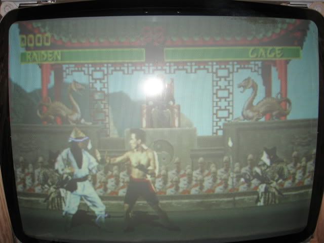

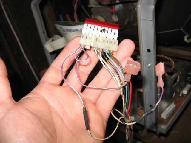

post some photos of the screen when it goes wrong and also some pics of how you have the video signal plug wired

« Reply #7 on: November 01, 2010, 03:57:36 pm »
well i hope this works ..i haven't put a pic on a forum in a long time ....    that one is going in the monitor...

« Reply #8 on: November 01, 2010, 04:00:20 pm »
and this is the side going in the board.   as you can see i have the sync wire plugged in ....maybe that's the problem ?

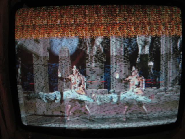

« Reply #9 on: November 01, 2010, 04:01:37 pm »
this it the picture i get for about 5 min..

« Reply #11 on: November 01, 2010, 05:18:53 pm »
strange,if it were a wrong cable then it would not sync even for a few seconds

to me it looks like a game board fault
the picture is fine in the first photo so that proves all your connections are correct
there is graphic breakup and a double image in a few of the photos and the final photo has lost sync
if you could lay your hands on a very cheap test board then at least you could prove the monitor is ok
another thing to check would be the voltages to the jamma connector and a long shot make sure the marquee light is not flickering wildly

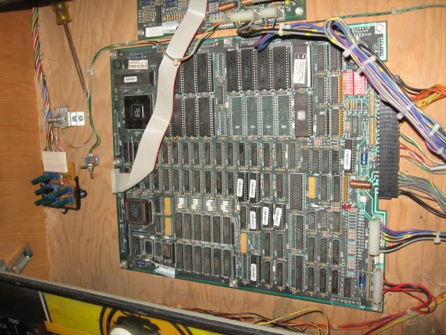

sound issues were common with copy boards
a photo of the game board will show whether its original or not.

« Reply #29 on: November 07, 2010, 10:11:27 pm »
this is the pic that you wanted I hope that you can see what you need ..if not I can take more and for the sound problem ..I put the sound setting back the way it was and all is normal

« Reply #30 on: November 08, 2010, 04:56:14 am »
nice original board set you have

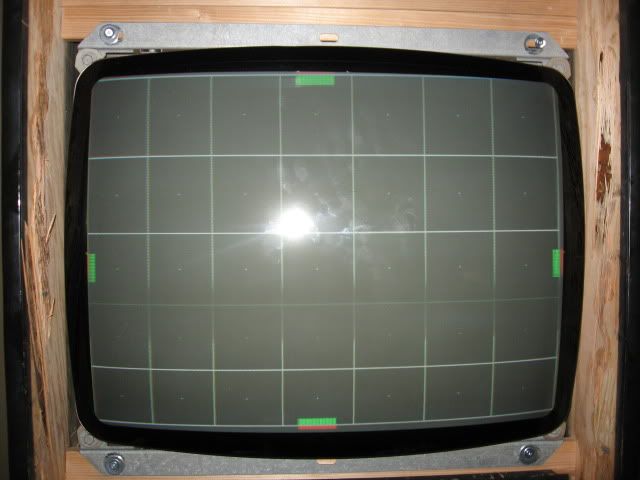

post a photo of the test grid pattern
it sounds like linearity

« Reply #33 on: November 14, 2010, 12:17:02 pm »
so this is what the test screen looks like

« Reply #34 on: November 14, 2010, 01:41:42 pm »
vertical linearity pot needs adjusting-RV102 infront of the tda1675 vert deflection ic on the main chassis(behind the control pcb)
