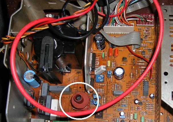

Just purchased an UMK3 in a MK 2 and the monitor is a Hantarex Polo 25". The screen looks great except for the sides that run out of the viewing area. The picture is about 1-2" bigger than what can be viewed on the monitor. I cannot find horizontal control to shrink the image for the life of me. Is this a cap kit issue? Other than this nuisance the screen looks great!

I think you could just adjust the horizontal width coil, slightly behind and to the left of the flyback transformer, if looking from the back of the monitor.  Most take a hex head tool (plastic if you have one), but a metal Allen wrench could be used (adjust a little at a time while powered off), and you have to determine the correct size to fit the opening in the piece of ferrite inside the coil.  I actually think these Polos (if I remember mine correctly) have simply a slot that a straight head screwdriver can fit (again preferably plastic like a TV alignment tool), but you can use metal and adjust a little at a time one way or the other while the power is off then power back on to see the results.  You must BE CAREFUL not to force the tool or you will crack that piece of ferrite in the coil and ruin it requiring replacement of the width coil.

One other word of caution: as MKFan4Life alluded, do NOT adjust the width coil using a metal tool while the monitor is on.  If you use a metal tool (which is not recommended anyway as it increases the chances of cracking the ferrite), you MUST do it with the power off.

Do you have a pic available? I can't find anything remotely close to what you described.

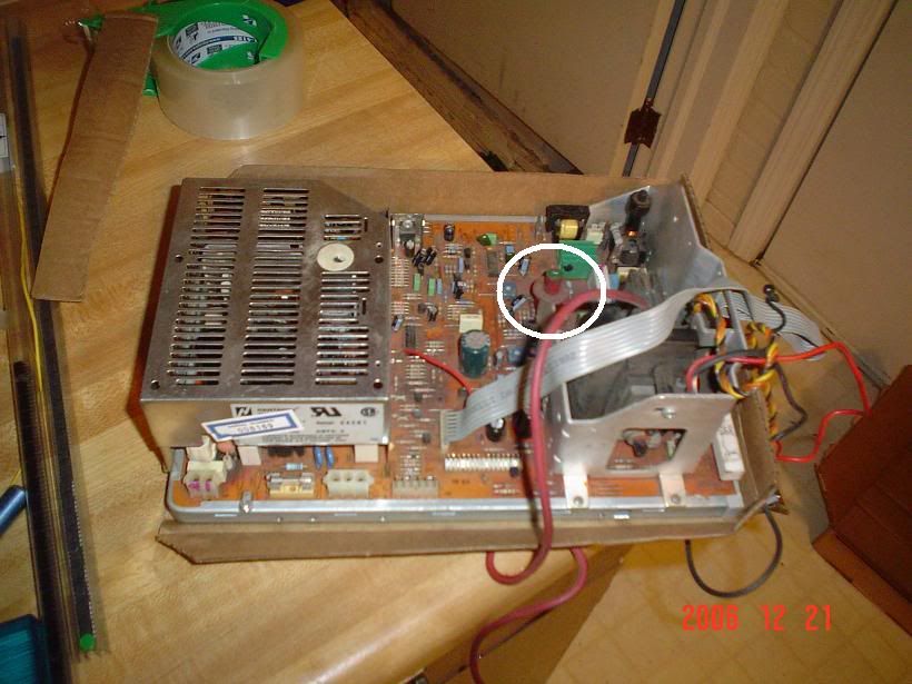

Ok found it, but I have no cluw how I will get to it without removing the monitor  :(

Here are some pics of Polos with the width coil circled.  You need a (preferably) plastic tv alignment tool to properly adjust it without risk of damaging the fragile ferrite piece inside.  Most of the time it's a hex head, but I think some of these Polos have a slotted head, like a standard screwdriver might fit.
Either way, if you MUST use a metal Allen tool or screwdriver (not recommended), then only adjust it a very small amount at a time in one direction or the other with the power to the chassis OFF, and DON'T force the tool AT ALL or you will be replacing the entire coil with a new one unless you have another piece of ferrite that fits the coil perfectly, which would be doubtful.  You can then power the monitor on and check the results and repeat this process until you obtain the width you need.  (You SHOULD be able to manage adjustment of the coil WITHOUT removing it from the monitor frame if you're careful, but if doing it with it powered on, take care to not touch any hot or high-voltage parts.)

Yup thats the one.  I doubt I will be able to get to it without removing the monitor which I don't want to do. Looks like I will have to live with missing an inch of screen on the sides  :(
