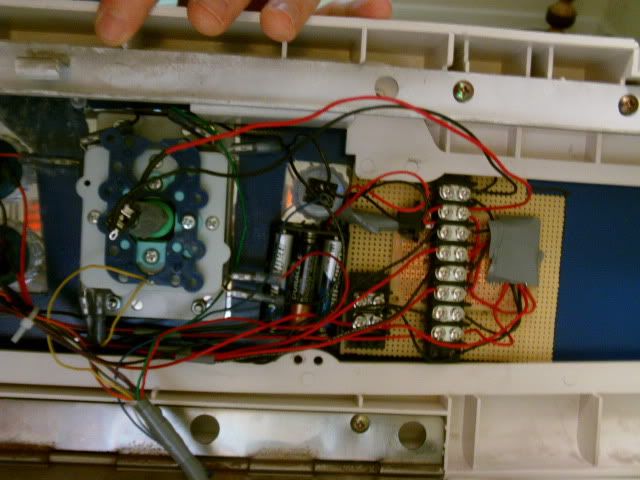

This is a thread for my Korean candy cab that I have recently finished working on. I got this on ebay for $300 + $200 to get it shipped from Florida to Virginia.
It came with a Parodius PCB. On the second day I had it I broke the neck on the tube  :angry: :angry: :angry:, so I replace it with a TV from a pawn shop. It is connected through s-video with a RGB to NTSC converter.
I also added a xbox 360, which is connected through component cables.
I wired up a DB-25 switch box for going between the controls for Jamma/xbox 360. I also ran a video button from the TV chassis to the switch box for going between the s-video and component inputs, also a button for the TV power was ran to the back of the cab. The xbox 360 control is through a hacked MadCatz street fighter IV gamepad (also ran the home button to the back of the cab for turning on the xbox).
I got the xbox from a friend already decased. Without the case there is nowhere for the dvd drive to rest. Luckily, the drive uses a standard SATA cable, and I just happened to have an extra lying around from another project I did. I did however have to manually lengthen the power connector. I then mounted the dvd drive to the bottom of the pcb shelf.
One side note.... I originally had both sets of sticks wired up to the switch box, but when I finished and tried to test it, only some of the buttons were working and I couldn't figure out why. the db25 cable has 25 pins, and for two sticks, 10 buttons, and 2 grounds (one for each hacked pad), I should have had more than enough pins to do this. but when I got out the multimeter to try and track down the problem I found that the problem lied within the switchbox itself. I opened it up and found out that pins 18-25 were soldered to each other, so I actually only had 18 pins to work with... So I rewired it and had to cut one xbox controller. This was particularly annoying, and I don't want to use a soldering iron for a long time... The end result is that bot sets of controls work for JAMMA, but only one stick works for xbox.
Also, the sticks are very loose, so I will end up replacing them with either sanwa or seimitsu balltops. I'm asking around to find out which model will best suit the kind of games that I will be playing.
A marquee holder will be made too eventually. Maybe in a week or so, I'm kind of burnt out right now.

Here are some pics. I can barely find the time to do these projects, so documenting as I go doesn't really happen... Too bad because
I really like reading threads with lots of pictures of projects in progress. Also there is a video on youtube.
*** in the video I say that the other cab is JAMMA, that was a mistake. It's actually just MAME, PS2 and Dreamcast.

Oh, one thing I forgot to mention. the converter I have will only work with Standard Resolution games. So would it be compatible with the current generation CAVE pcb's? Not that it matters much, because I don't see myself ever shelling out the money for one of the newer CAVE boards.

I will be upgrading my control panel as you can see. I want a 4 button setup. The plexi will cover the two button holes that I'm not using. I will be using the following tutorial from shoryuken to achieve lighting up buttons (when pressed, not lit all the time), the ball top will be permanently lit.
http://shoryuken.com/content/light-up-activation-button-mod-tutorial-61/
I still need a hollow LS-32 shaft. Bryan from paradisearcadeshop.com saw a post I made about this and let me know that they have them, but haven't started advertising them yet. He is hooking me up, and I should be getting soon (not really... they're in Hawaii so it will probably be at least a week to get to Virginia. It's ok.) I'm also waiting for the Hex Inverter IC to come from ebay (Radio Shack does not have them).

As promised here are some pics of the cabinet as it stands right now.
First a couple of pics of the bottom side of the panel with all of components. You can see that right now I'm using 3 AAA batteries to power the LED's. I did this as an easy portable PSU while I was wiring and testing. After a few days break I'll get around to picking up the +5V from the JAMMA connector.
I also put a little video on Youtube with a short tour of the cab. Please forgive the not so great camera work, and narrating skills.
The little square of electrical tape next the barrier strips is covering the IC that all the LED's are wired to.
BTW, the two 24mm buttons don't light up. I didn't realize that the KNserts (pre fab LED inserts) don't fit the 24mm buttons.
I didn't feel like doing a custom thing to work around it.
Also, emphatic, you might notice that the background blue is still darker. For some reason when you print the high res file, the colors are slightly off. The guy
at Kinko's tried printing it and recalibrating the printer like 3 times, and it kept coming out that way. Then he printed the low res and the colors were light again.
I just ended up going with the high res. It still looks good.

For the making the buttons light up when pressed, did you use the hex inverter like in this tutorial:
or is there a simpler way?
BurgerKingDiamond
  • Posts: 690
Re: Jamma/XBOX 360 Candy Cab *Final Panel PICS, VIDEO, LED's
« Reply #74 on: December 02, 2010, 08:49:10 pm »
There is this:
http://www.lizardlick.com/Toodles-FGWidget-LED-Controller-Kit_p_580.html
and these:
http://www.lizardlick.com/KNsert-LED-Board_p_585.html
But It's still gonna require some soldering.
yeah, that tutorial you linked is exactly what I did. I got a 5 pack of the inverters on ebay for like $4. It's actually pretty simple if you're alright at soldering and can read basic electrical diagrams. I'm by no means an expert, but I was able to follow the diagram and it works.
One thing I did to simplify it was to use the prefab'd KNserts from LizardLick. So all you do is take of the button plunger and stick in the KNserts. You drill a couple holes and run a GND and a +5V wire from the KNsert to the outside of the button. Also if you choose to use the KNsert without the FGwidget board you have to add a 150 ohm resister and cut a trace on the back of the KNsert.
The balltop is wired straight to GND and +5V so it is on full time. I may be able to answer some question if you plan on going through with it.
