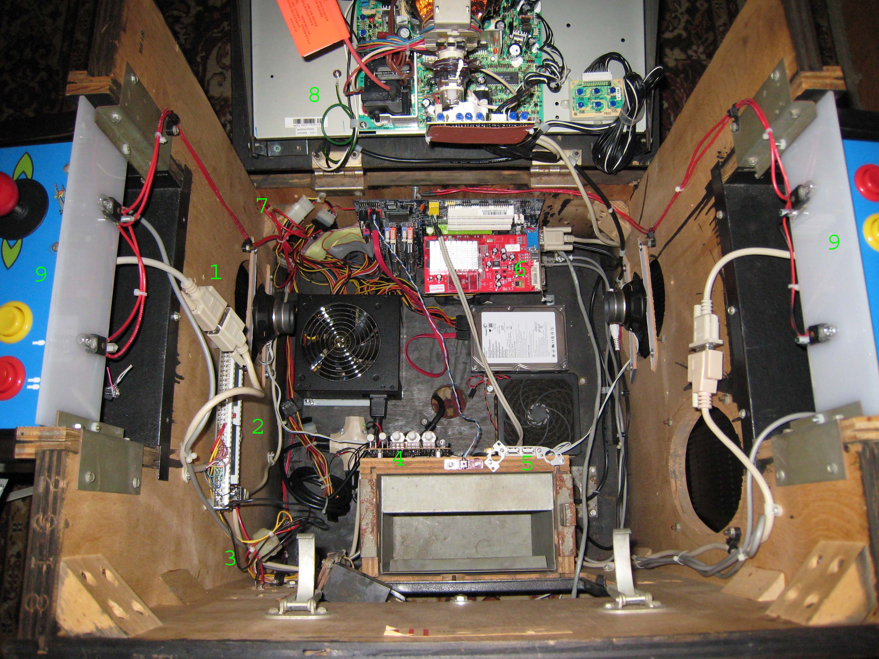

1. there should be plenty of room for any PC.  Mine is de-cased, but it's all standard.
http://www.waste.org/~winkles/winterMAME/pix/wintermame_inside.jpg
2. my former galaga machine is pre-jamma.  I didn't re-use any of the internals anyway.
3. I think 19" arcade monitor was pretty common, at least on the most popular midway cocktail machines.
4. should be plenty of power.  you're going to be mostly oldskool there, as you have to use games that support screen flipping, and most of those came out in the 80s.
5. You can see from my pic that I've got 3 buttons and U360's for each.  Mine is a 9" control panel and it feels about right-not too cramped.
