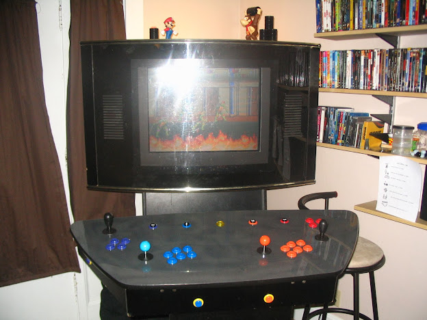

here is the panel with all of the controls mounted.  i went with Happ buttons, with the colors matching up to the TMNT games.  i have two U360s for players 1 and 2, and two Sanwa JLWs for players 3 and 4.  i had purchased colored ball tops in case i wanted to use them, but since the colors don't match very well, i went with the bat tops.
the orange and red match up pretty well, but the blue and purple do not ( i got both the light blue and dark blue sanwa balltops)

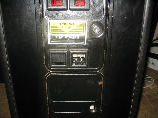

i didn't want a cluttered panel, so i decided to move the coin buttons to the control panel box.  this keeps the panel clean, and still gives you that feeling of reaching down to insert a coin. i normally just hook up the coin door, but since it is only a 2 player coin door, that won't work for players 3 and 4.  i will probably eventually rig up the coin reject buttons as coins as well.

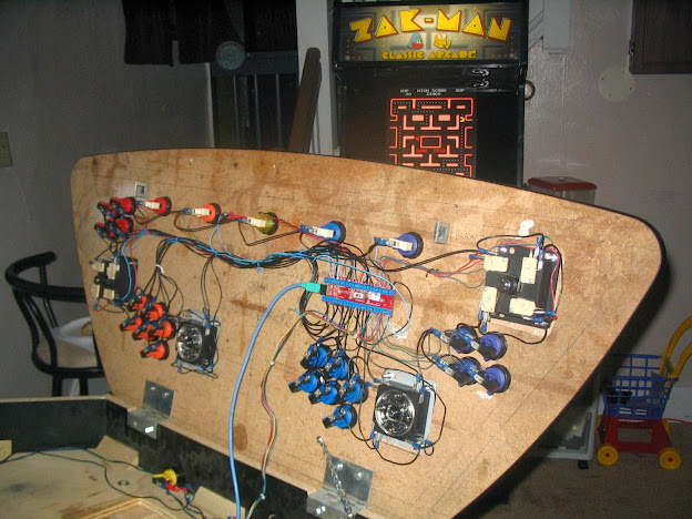

here is the back side of the panel, with all of the wiring done (at least at this point)

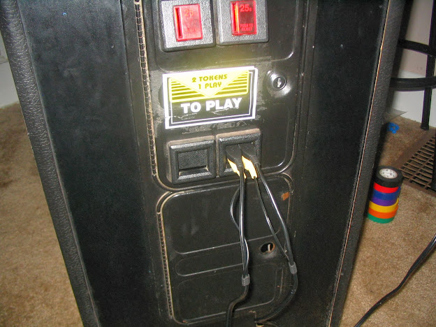

since the coin buttons are not on the panel, i wanted to be able to disconnect them easily.  i wired the four buttons into a terminal strip, and then attached that to a wire harness i found in the cabinet.

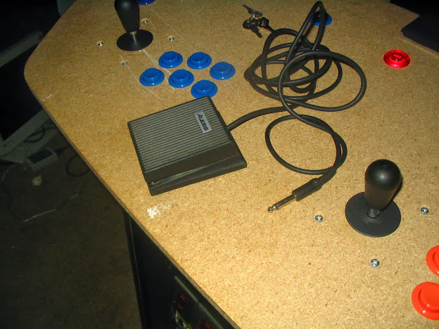

i wanted the exit game button to stand out, but GGG was sold out of the novagems that i used in my last panel, so i did the next best thing...i got a translucent IL button, and an EXIT button insert and a red button blaster LED from GGG.  i drilled the button and installed the LED, which is wired to teh 5v on the keywiz encoder i am using.

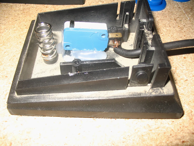

here is a pic of my exit button, not really much to look at.  like i said, i just drilled the hole so it was tight, and pressed the LED into place. i just soldered a wire to each leg of the LED and then bent them around so that they aren't in the way.  according to RandyT, it doesnt matter which leg you solder the resistor to.  to make it easier, instead of attaching the resistor directly to the LED, i put it on the other end of the wire, where it connects to the 5v.
the novagem button inserts fit the iL buttons perfectly.  i just checked the two novagem buttons i have, and guess what, they are iL buttons.

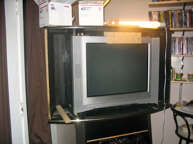

got some more done this weekend...still alot to do though.  The biggest accomplishment was replacing the 17" LCD with the 27" TV.  this is a Sony Trinitron Flat CRT tv with component video input.  i had to remove part of the case on the TV to get it to fit in the cabinet.  i also had to cut a few inches off of the front of two of the wooden supports to get the TV to slide in there. ( i didn't want to destroy the TV, in case i replace it someday, i could use it for something else)
i screwed a few boards together to create a brace to use to hold the TV in place.
I have since trimmed the front board so that it doesn't hang down in front of the screen, but i forgot to take a new pic.
i also got a piece of foam core posterboard at a local craft store to make a bezel for the TV.  it isn't perfect, but it works well enough for me.  i will probably use some black tape on the silver tv bezel to make it not stand out as much.
while this isn't exactly related to the cabinet, my wife picked up a Donkey Kong figure to sit on top of the cabinet...i love it.  now i need to get the mario figure to go with it.  (yeah there is a lot of crap piled up on top of the cabinet, i have to keep everything up high so my kids don't get into it.

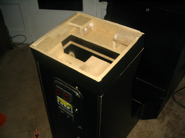

Here is a shot of the cables where the two pieces of the cabinet come together.  i set it up so that i can easily disconnect the control panel portion to move it out of the way if i have to.  visible here are 4 usb cables (two u360s, two guncons on the PS2) one RCA video cable (guncon) and a PS2 cable (keywiz)
i just managed to get my ps2 installed this afternoon.  the PC and PS2 all sit in the cabinet below the monitor, i haven't taken any pics of that yet, since i need to clean up the wiring first.(and also add an exhaust fan since it gets pretty warm in there.  the PS2 is only there for lightgun games, i dont have any of the joysticks or buttons wired up to the ps2.  i wanted to be able to easily connect and disconnect my guns, because i don't want the kids to destroy them.(also my wife doesn't really like them playing with guns).
the guncon2 guns require a USB plug, and an RCA video plug wired either to the composite or the green cable in the component video cables.  naturally, i went with the component cables since they give a much better picture.  there is a switch box that i use to change between the PC and PS2.  anyway, since the ps2 is in the back half of the cabinet, i had to extend the cables up to the other part.  i had two usb ports i pulled out of an old pc case, so i spliced some cables together to add actual USB ports to the cables, and ran them down so that they plug into usb extension cables at the place where the two pieces of the cabinet meet.  i also got two RCA jacks at radio shack, wired them together and added a long cable with a male RCA connector on the other end, this plugs into the special video cable that comes with the guncon guns.  i quickly mounted them to a scrap piece of plexiglass and mounted it to one of the coin return openings on the coin door.  i figured i'm not planning on using the coin door anyway, so i can utilize this space.  it makes a nice easy place to plug in the guns.  conveniently the two guns fit perfectly into the coin box below for storage. ( i need to get another lock for that door.
the panel i cut for the usb ports doesn't exactly look real nice, but i can redo it later.  my goal this weekend was to get the cabinet functional, now i can play it a while tweak what i need to, and then work on the cosmetic stuff.  the plexiglass bezel is really scratched, i dont know if there is anything i can do about that or not, it is annoying at first, but after a few minutes of play, you don't really even notice it.
i got to play some TMNT with the kids this weekend and they had alot of fun. (my 3 year old loved it, my 19 month old just pounded buttons and wasn't really playing)
well, that is it for now, hopefully over the course of this week, i can get the wiring cleaned up maybe work on the plexi bezel.
i also forgot to mention, but i am using a phillips smart strip i picked up at walmart, there is a button on the top of the cabinet that powers up the PC, and the strips turns everything else on.  fortunately, the TV powers on and goes to the proper input upon receiving power, so that works very well.  i have a remote control i use to adjust the volume.

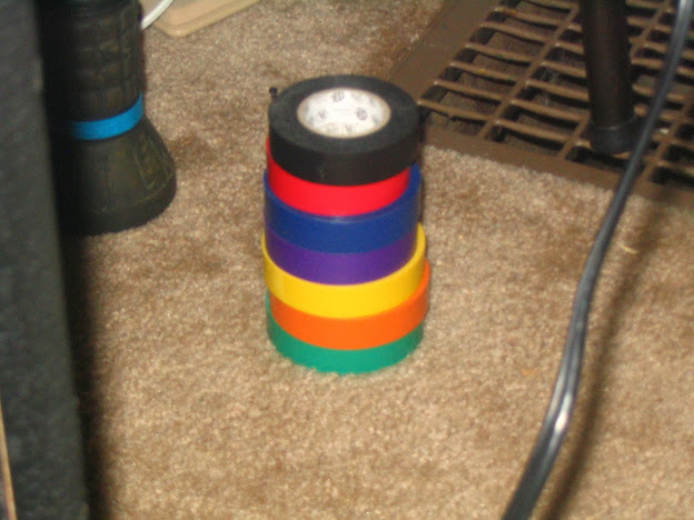

i got a little more done this evening...but not alot.  first of all, i color coded the rest of my cables so i don't plug them into the wrong place. (i dont plan on taking it apart much once it is done, but during the setup process, i pull the control panel out of the way to make it easier to get into the main cabinet)
this was all possible to the awesome colored electrical tape i picked up today at a local hardware store ( 95 cents each)

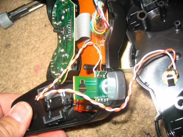

here is a shot of the guncon controllers plugged into the front panel i mounted in the coin chute.
i dont have any gun holsters installed on the cabinet, since i will put them away when they are not being used, however i did find that the joysticks do a good job of keeping them from falling down.
here is a shot of me trying to play Vampire Night while taking a picture with my left hand (not easy)

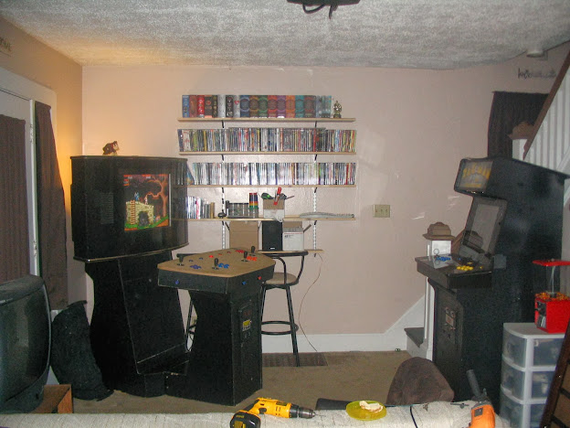

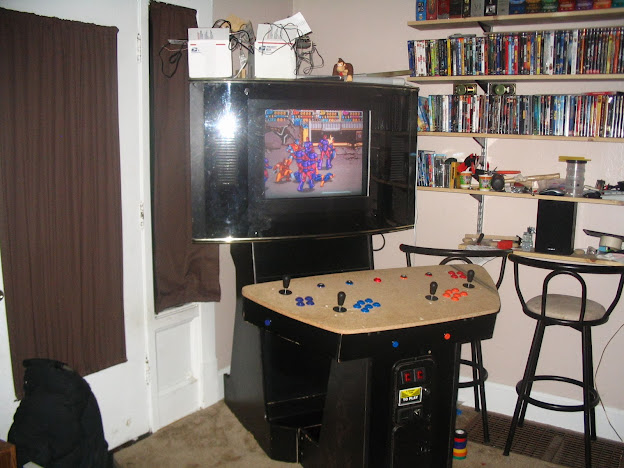

and here is a long shot of the cabinet so far, running xmen.  i still need to clean up my work area around the cabinet, but all of my tools and wires and extra buttons and all kinds of stuff are in thos boxes on top, and all over those shelves on the wall.

well, this afternoon, i stopped by a local pawn shop and picked up a used 3rd party playstation 2 controller for $4.  this will be used as an interface for my reload pedal for my playstation 2.
first of all, i plugged the controller in and made sure it worked, and discovered that every button on the controller will work as a reload pedal in the time crisis games, this means that i can use any button i want.  upon opening it up, i discovered that the L1,L2,R1 and R2 buttons would probably be the easiest choices, since they had a small separate pcb that was clearly labled, as well as solder pads just begging to be attached to.
i had a small 1/8" mono panel mount audio jack lying around, so i attached the two wires to the L2 solder pads, and put a small hole in the back of the controller to mount the jack.  this way the controller is still fully functional if i ever wanted to use it for something else.(not that i would, it is pretty crappy).
then i took a piece of speaker wire i had, and soldered a 1/8" mini jack onto one end, and on the other end, i soldered on a 1/4" audio jack.  (since the pedal i fixed the other day already had a 1/4" mono plug on it.
i then connected a controller extension cable to my ps2, plugged the controller in, plugged the 1/4" to 1/8" adapter cable i just made into the controller, and finally plugged the pedal into the adapter cable.  i fired up my ps2 with time crisis 2, and it works beautifully
right now, i just have the 1/4" jack just sitting in the coin return slot, i need to cut a new panel to mount it on.  i also need to search for a different controller extension cable, that one is attached to a spool which is hard to tuck away in the small opening between the two peices of cabinet. i know i have another one somewhere, but i'm not sure where right now.  the controller just lays in the bottom of the pedestal portion of the cabinet, i will probably mount it with zip ties or something to keep it from moving around and possibly depressing one of the buttons.
i cant get over how much more fun time crisis is with the pedal.  the buttons on the guncon 2 work just fine, but the pedal is just so much more fun.  i dont see it being real necessary to have a second one, since i'll probably only ever use it by myself, but if i see the need, i can add another one down the road.

well, i didn't get as much done to the cabinet as i would have liked this weekend, (wife was sick, plus i had some home improvement stuff that sat a little higher on her list than the cabinet).  anyway, i did manage to get the control panel raised up to a reasonable level.  it was just too low, it was uncomfortable to play for more than a few minutes.
here is the pedestal portion with the control panel box removed:
this isn't really the final product, i was just throwing together something quick to see how it would work.  i wasn't sure if the height was right, and i didn't have enough MDF at the house to do it right, so i used some scrap mdf and a few 1x4 pine boards.  i quickly cut them out (not very well) on my table saw that i have never used before.(should have clamped a board down as a fence i guess)  i cut the pieces, glued them all together and slapped 2 quick coats of paint on it. (no sanding, just wanted a black box).  i set it on the pedestal and ran a few screws in to hold it in place.
i then placed the control panel back on, and screwed it in place.  this put the panel at a much more comfortable height. (just under 38" at the front edge)
i also took the time to clean up some of my mess around the cabinet, i figured now that there wasn't a bunch of crap sitting on top of it (i moved it all to the DVD shelf on the wall)  i could take a pic of the power button i mounted on the top of the cabinet (in the hole where the wiring use to run through to get to the marquee box i removed).  this button was in the original control panel when i picked it up, and since it covered the large hole completely, it seemed like the right choice.
finally, here is a long shot from the other side of my family room.  as you can see, this thing takes up a big portion of the room, but it seems to work well where it is.  obviously i have alot of cleaning up to do.  not to mention getting my other cabinet back up and running.  this room is really dark, since there are no overhead lights in the room.  i mounted an 18" florescent light fixture to the back side of the cabinet to provide a little more light in that half of the room.
well, that's it for now.  i need to play with this for a while to make sure the panel height is good, if it is, then i will make a new booster box to replace the crappy one i threw in there yesterday.

i didn't really get much done on the cabinet tonight, but i did manage to work on my mala layout while watching TV with my wife.  i'm not sure that it is 100% done yet, but it is close.  it is strange designing a layout at such low resolution, my other cab has an LCD monitor, at 1280x1024, so switching to 640x432 is a big change.
anyway, here is a shot of the front end on the cabinet...i wanted to keep it fairly simple.
feedback is welcomed

Well, it has been a while since i have done anything with this, i just haven't had the time.  However i knew that with the holidays coming up, we would be likely to have people come over and visit, and i didn't want to have a bare mdf panel on this cabinet...so i finally purchased the plexiglass and took this panel to the next level.  I am not completely happy with the way it turned out.  i had planned on painting the back side of the plexi black to give it a nice glossy black finish, which i have successfully done in the past on my other cabinet.  however at the last minute, i decided to go with a dark gray textured paint instead.  i really like the shade of gray, since it makes the black controls stand out a little better, but the first coat of paint apparently didnt go on evenly enough, and no matter how many more coats i put on it, it still is splotchy. it is better than nothing, and since it is getting cold out, it will stay like this until spring...at that point i hope to add a trackball to this panel..so i'll get a new piece of plexi and paint it black like i should have in the first place....
i also relocated two of the player 4 (red) buttons.  i somehow had them laid out in a square pattern, even though all of the other players were set up more in a diamond shape.  so when i took the panel out, i used some bondo to fill in the holes and moved them to where they needed to be.  i forgot to take pics of the process.
here you can see the old player 4 button layout:
and here is the new one. not that dramatic, but at least now they match the other ones (noone ever noticed that but me)
While i was at it, i switched out some of the components.  i had two u360s for players 1 and 2, and Sanwa JLWs for players 3 and 4.  i really liked the feel of the JLWs...much more than the u360s.  so i figured since i had to remove everything to add the plexi, i should just remove the u360s.  i still need to purchase two more JLWs, but with Christmas coming up, i need to keep costs down until January.  I moved the JLWs to players 1 and 2, and installed two old xarcade sticks for players 3 and 4....not exactly ideal, but they are fine for now.  i also installed ball tops on my JLWs, i think i will go all 4 balltops when i get my new joysticks, even though the colors dont exactly match the happ buttons.
I had a good bit of rewiring to do, since my player 1 and 2 buttons used to be wired to the u360s.  now everything is running off of a single keywiz.  I had to get a little creative and remap mame completely, but all is working great.  the keywiz is clearly designed for a 2 player panel, however with 40 inputs, and 32 additional shifted inputs, it can be used for a 4 player setup.  as you can see, i have 4 joysticks, 6 buttons each for players 1 and 2, and 4 buttons each for players 3 and 4.  plus 4 start buttons, 4 coin buttons and a pause/exit button....that all adds up to 45 inputs.  i wired up all of the sticks, action buttons and start buttons to the 40 inputs on the keywiz, and then i used the shazaam button adapters on my coin and exit/pause buttons. these adapters allow you to send a shifted input with only a single button press....i was a little skeptical at first, but after using them, they work great.  the adapter looks like a Y adapter....one side goes to an input on the keywiz, and the other goes to the shazaam input.  when you press the button, it sends the shifted input instead of the normal one. GGG seems to discourage you from using these as gameplay buttons, but for coin or admin functions, they are fine.    since the keywiz doesnt retain any custom programming, i decided to stick with the default button config and just adapted mame to use that.  after testing i have had to change my shifted keys to different inputs, because the ones i chose aren't perhaps the best choice.  (F2 for instance, even though i went into the mame config and told it not to use f2 for the service switch, a few games didn't like it (mortal kombat series)...but that was easy enough to overcome by just moving it to a different input.
here is the shazaam adapter
