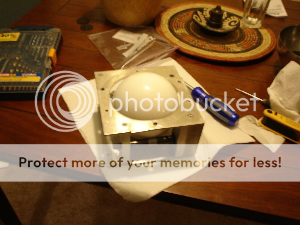

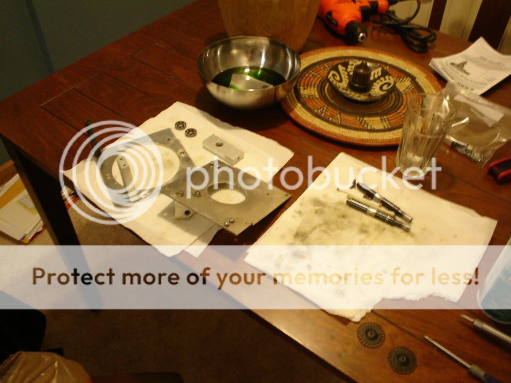

So it all started with this trackball I got off of EBAY.  I bought it for 5 bucks and thought (at the time) that it was any awesome deal.
It was a little dirty, so I cleaned it up, and other than the rollers. everything looked great.
The bearings cleaned up nicely in some simple green and I used some sewing machine oil to lube them back up.
For testing purposes I put some duct tape around the worn spots on the rollers.
And Here's the finished product

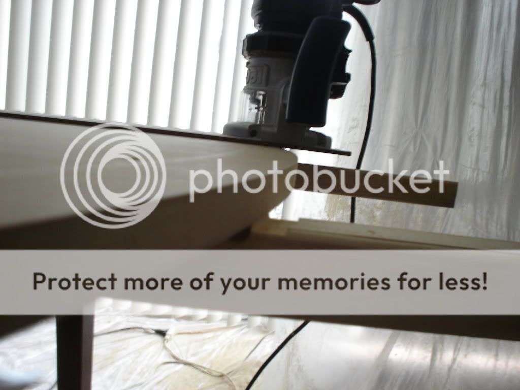

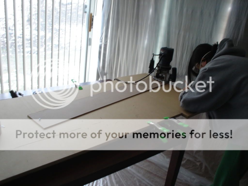

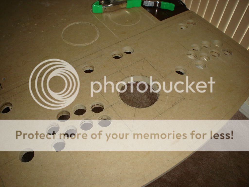

Then I started on the base. I really liked the look of the CP's on Mountain's Mame and the Neon Mame, but I didn't think I could copy the curve, so my original design was more trapezoidal.  After I got all the parts, I decided to go with the curved front anyway.
I was all ready to work outside. The weather out here in Chicago was nice all week, and then it snowed on the weekend.  I was determined to work on this project, so I got some painters plastic and made my dining room into a wood working bubble.

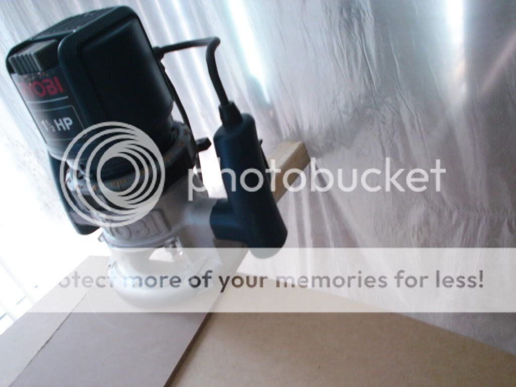

Also in the picture is how I built my giant router compass.  I cut a hole in a strip of 1/4 inch mdf with my dremel tool.  I screwed that end to the bottom of my router.  On my work table I drilled another hole so that the whole assembly could rotate. This gave me a circle with a 45 inch radius
Here is a pic of the router mounted to the giant compass (and my girlfriend helping me take measurements  :))
I rough cut it with my dremel tool and then made a couple of passes with the router.  Afterwards the only thing I could think was "hmmm... didn't know I could do that..."
And another

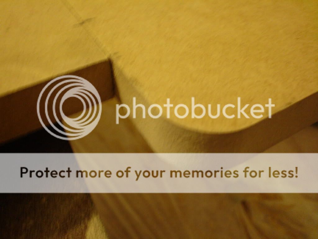

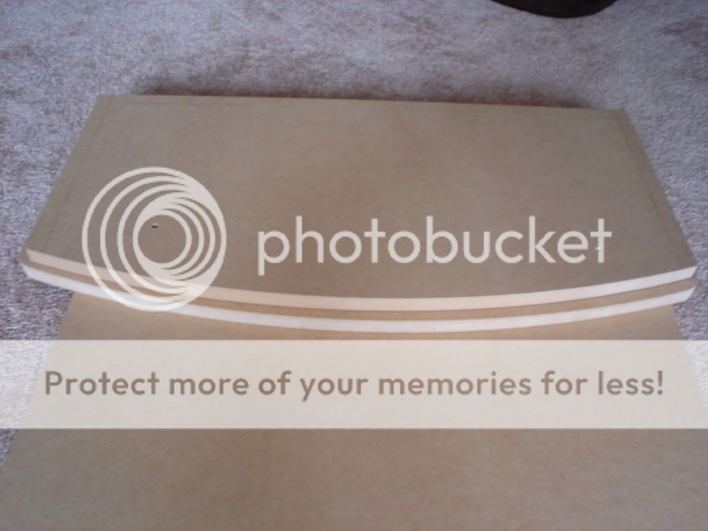

Then my girlfriend and I took some 1 inch PVC piping I had laying around and traced it on the corners.  I rough cut them with my dremel and then sanded them.
The CP (before the curve) was 14" x 28".  I wanted the base to be inset slightly, so I made it 1" smaller all the way around.
I put it in my circle cutting jig and cut the same curve into it.
I was on a roll with the next part, so I forgot to take pictures.  I have some on my phone that I can put up if people are interested.

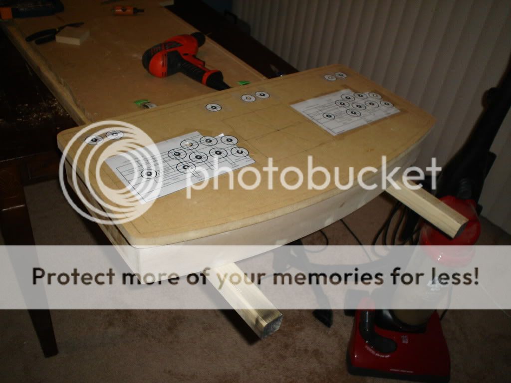

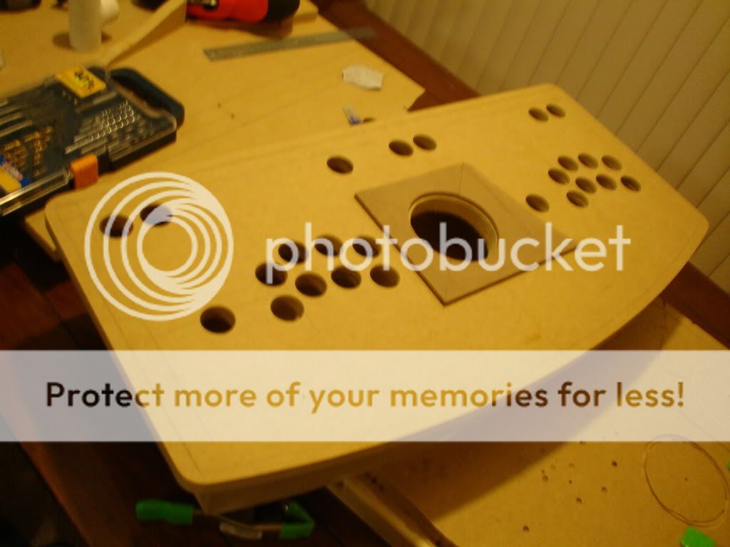

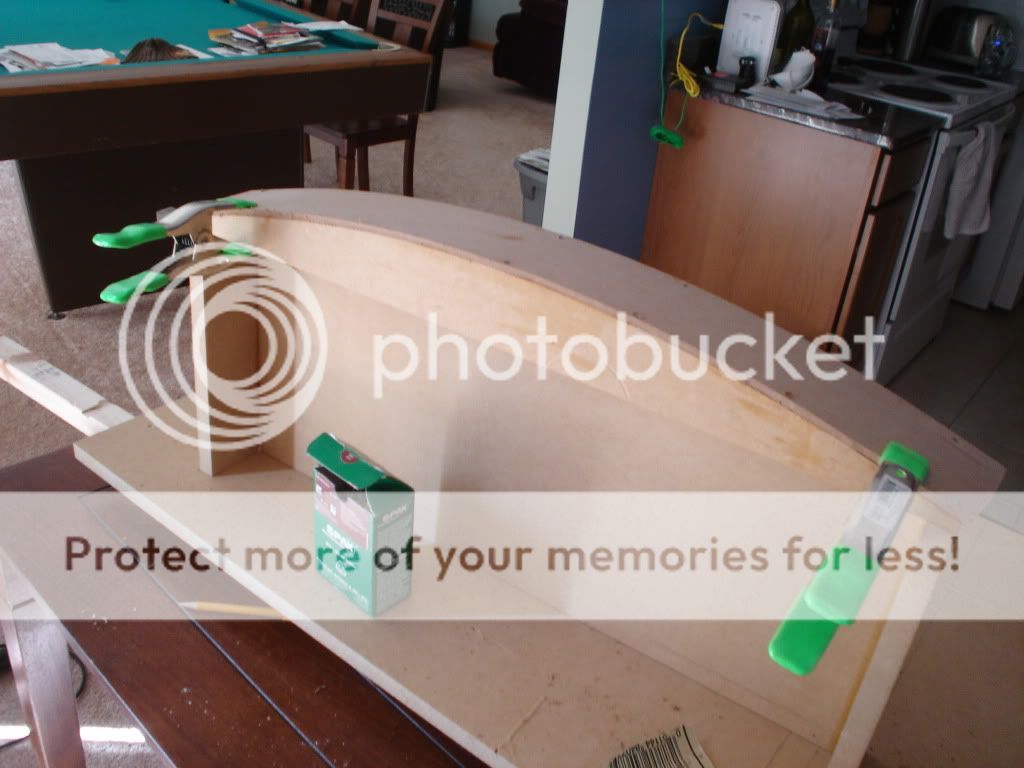

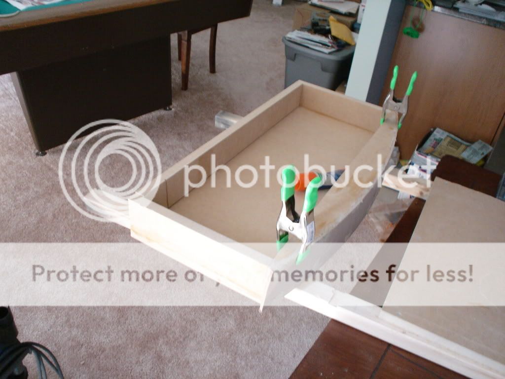

My goal was to make the whole thing as thin as I could, so I made the height of the box short enough to route out the bottom of the CP and mount the 4.5" trackball directly to the bottom of the box. Basically the whole thing is going to be sandwiched together. I cut another curved piece of MDF and screwed that onto the front of the box.  Then I bent a piece of 1/4" mdf accross the two curves and screwed it down
Here's the finished box
And here'sthe box and the Layout that my girlfriend applied to the top of the CP.

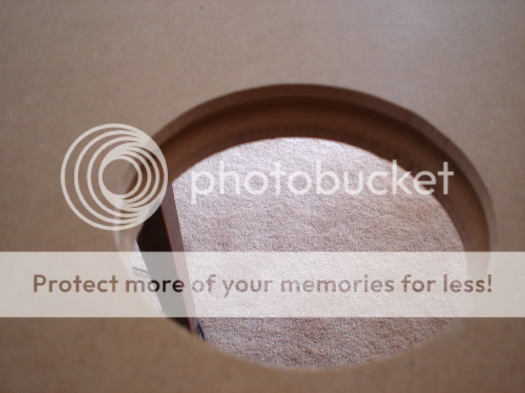

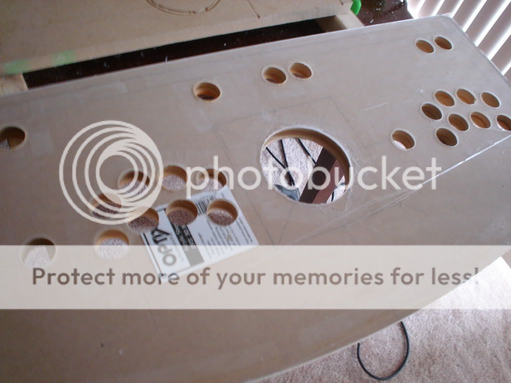

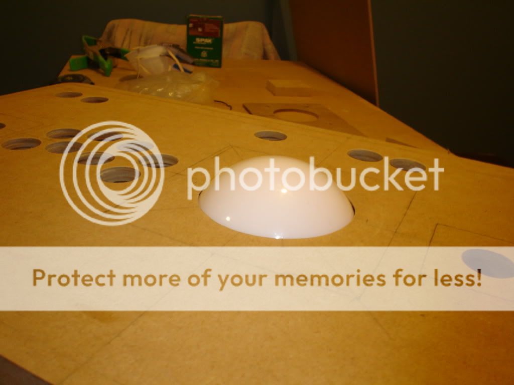

Alright, so the next thing I did was I cut button holes in my CP using a hole saw and I rough cut the trackball hole
Then I attached a template that I had made using my dremel circle cutter to my cp with double sided tape.
Next I routed out the hole with my template bit and ended up with an (almost) perfectly round trackball hole. When I made my template, I used the measurement from Daviea in a previous post of a hole with a diameter of 3.95 inches.  The template was just barely too big, so after I cut the hole into my cp, I flipped it over and routed along the edge with a round over bit.
Finally I routed out a 6" x 6" x 0.5" square in the underside of my cp for the trackball to sit in.
And here's how it sits.
The roundover on the bottom of the circle is just enough to let the trackball roll.
I'm really beginning to love this router.  I hadn't used one before this.

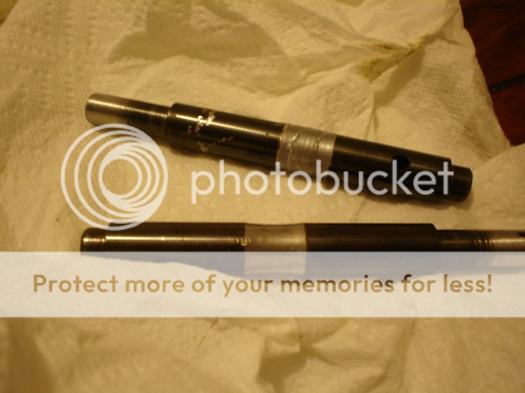

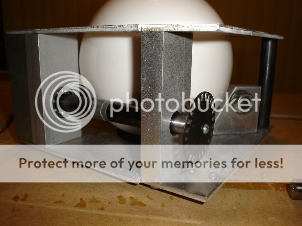

And here's a picture of the trackball and encoder wheel.
I bought happ replacement rollers for this because the boards on it were happs...
Well those didn't fit. Turns out that this is a modified Atari trackball. The rollers have been cut short and then drilled and tapped to match the happ boards.  Too late to get another trackball, I've already cut everything to match this one.  :dunno
