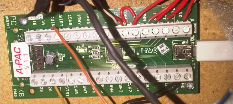

I am working on a Star Wars Cab, Got it all working through Mame, But once I try running it with AAE it doesn't want to load.
I have narrowed it down to the A-Pac?  I pac controller.  It works fine without the I-pac controller pluged into the USB, I have even tried running it with a USB to PS2 adapter.  No love.
I have my Dedicated Mamecab, with Ipacs pluged into it, and it works fine on that PC.
Please help me with this, Kinda stumped here...

The A-Pac is a joystick(gamepad) as far as the pc is concerned. Unfortunately, AAE doesn't support joysticks - he never got around to adding support for them. You would need an interface that looks like a mouse to the computer for AAE to work with it. A U-hid *might* work in this case...

Thanks... Think Im going to go Cry now...I tried to get hold of Tim?  AAE.  Nothing back so far.  I do pray he's still working on this.. Also wanted to ask him about the sound for Starwars.  Anytime you hear someone talk it seems to be barried in the back ground.
Anyone got AAE Running with the orginal Starwars controller?
This is what it looks like with just mame.
This is what it looks like with AAE running.  and that was with the lights on.
Can I trick the Computer into thinking the A-pac is a keyboard?  PPJoy?  Any thoughts? Idea's?

You could try a Joy to Key program, however I can see the movement to be clunky; you need an analog interface to smoothly move the yoke in Star Wars, and a keyboard input just isn't going to cut it. Just try and play Star Wars with the keyboard in Mame to see what I'm talking about. Really the best option is to get joystick support in AAE, or see if you can interface the yoke with a mouse input.
