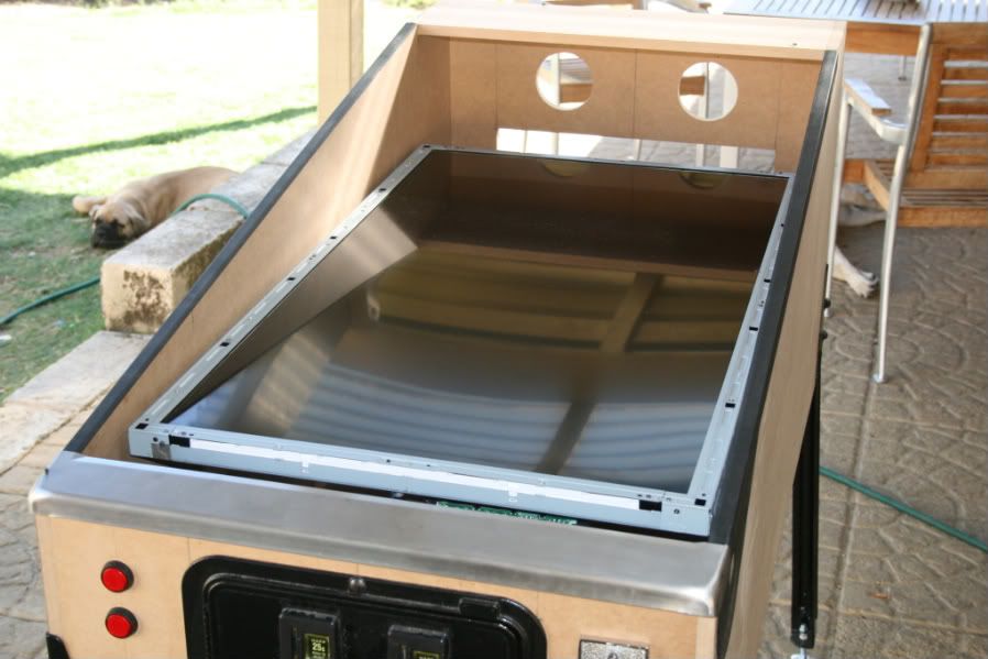

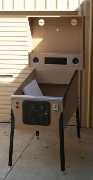

I have been reading this forum for months now working out a design for an arcade cab then got side tracked on building a pinball cab.
Size was built around a widebody lockdown bar and a 42" Sharp Aquos .
Few pics of whats been done so far
LCD test mount, the back is still to be raised another 2"
Hope you like it.

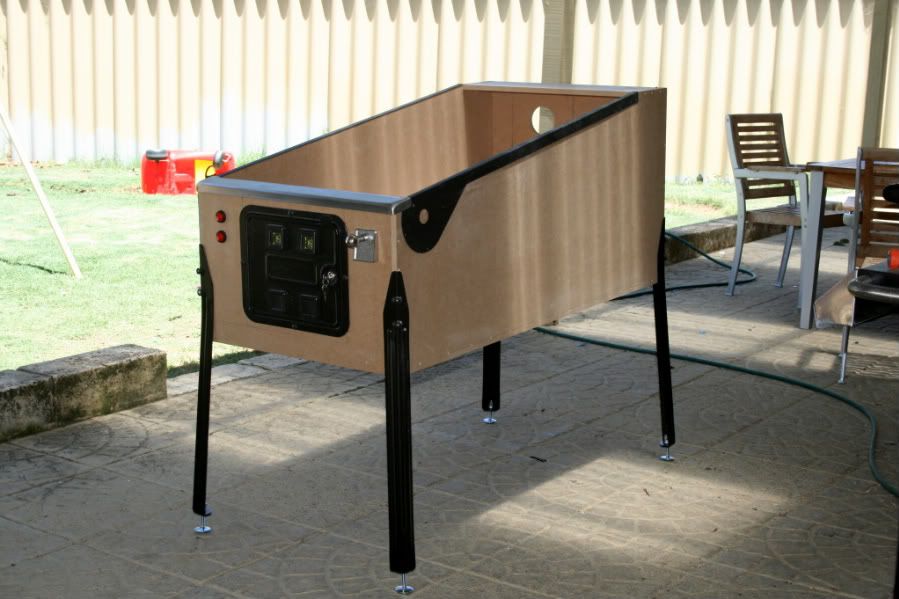

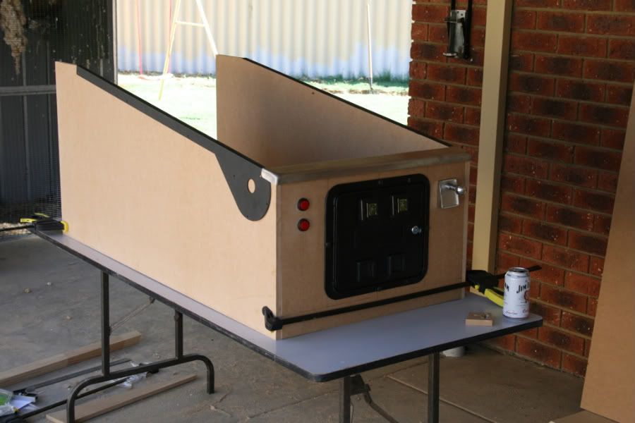

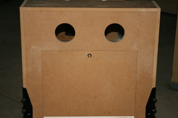

Finished routing the door and attached with lock.

Welcome to the forums!  Looking great!  This is my next project.
Would you mind sharing the dimensions of the body?
Also, what do you have planned for the backglass and DMD?
Keep the pictures coming.   ;D

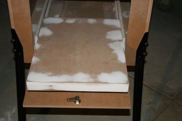

Looks fantastic so far.  I assume that pull-out drawer will be for the computer?
Where did you get your hardware (legs and lockdown bar)?

I'll be sure to post sizes.
I bought a 32" Sharp Aquos for the backbox but my partner ended up stealing it for our bedroom so i need to source another. DMD is a 19" 4:3 LG LCD
Yeah the draw is for the PC to mount to also makes it easy to remove out of the cab.
Most of the gear was bought through www.pinballlife.com

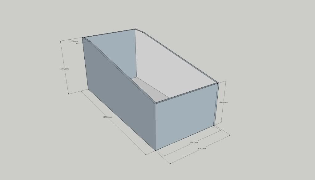

Started working on a 3d model to help with the backbox design, thought id post it at its current state to help people with the overall cab dimensions. Keep in mind all material is 16mm MDF

Appreciate the post of the model, but unfortunately none of the dimensions are readable, since the forum shrinks embedded images...     :(
You might try attaching the file instead of linking to it, since attachments can have a higher resolution.
I extracted the photobucket URL and looked at it that way, but other, less computer savvy visitors may not figure out that workaround.
« Last Edit: February 02, 2010, 10:30:04 am by Gamester »

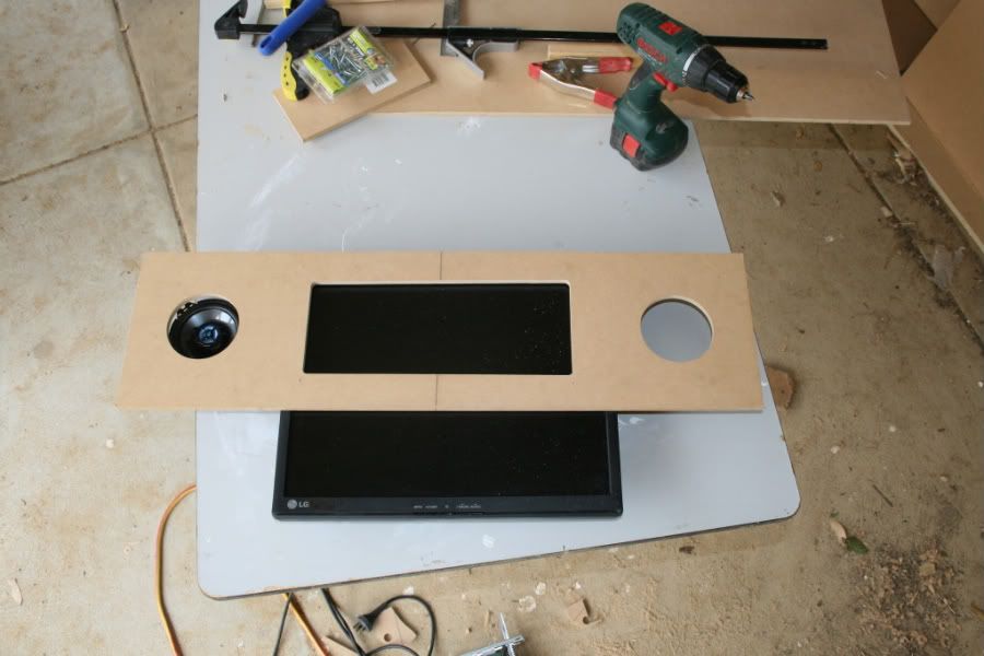

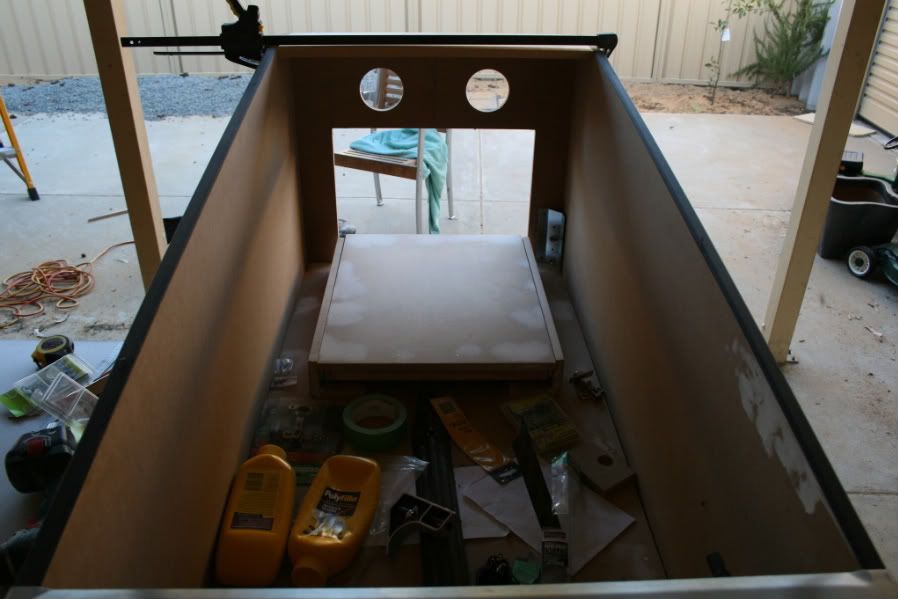

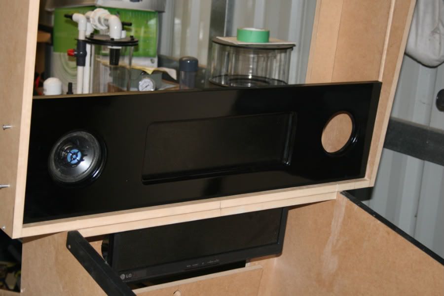

Main peices of the backbox have been cut, also made a router template for the DMD and speakers.

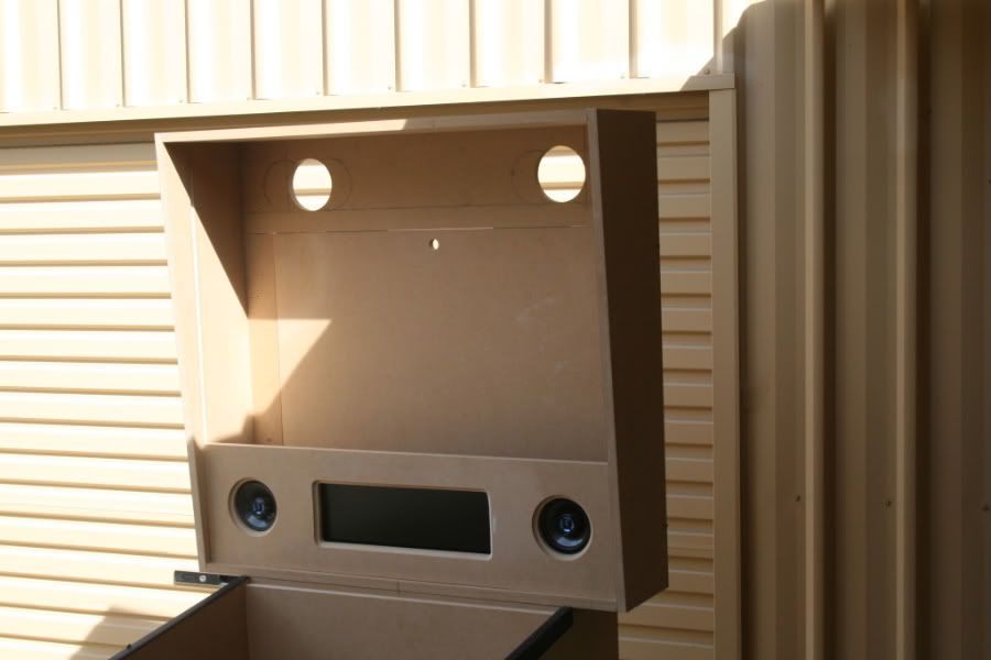

Did alittle more work on the backbox today, only alittle more to do and its ready for prep.

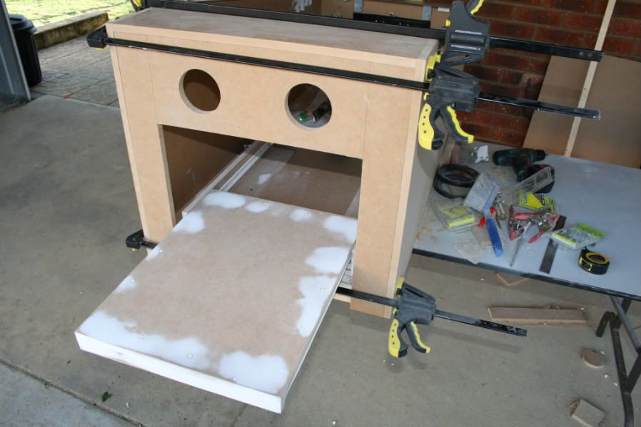

What will be on the slide out self thinggee? and does it slide out the back? Just for PC access maybe?
The drawer is for the pc parts to be mounted to allowing easy acces and removal.

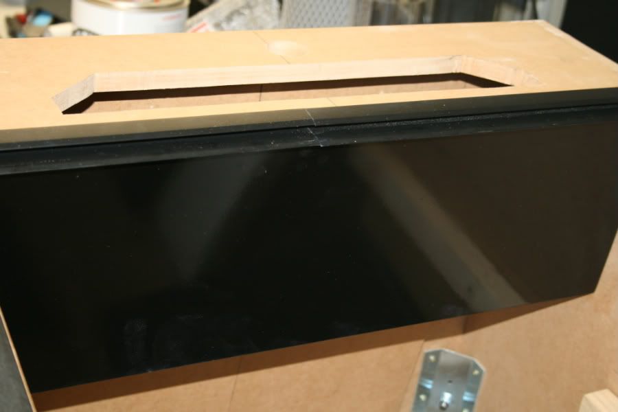

Question:  How did you attach the DMD monitor to the wood face?
The 19" LCD is pushed up against the DMD hole and sinks bellow the backglass into the main cab. I made a wood block that mounts to the LCD that also stops it from falling bellow the reces.

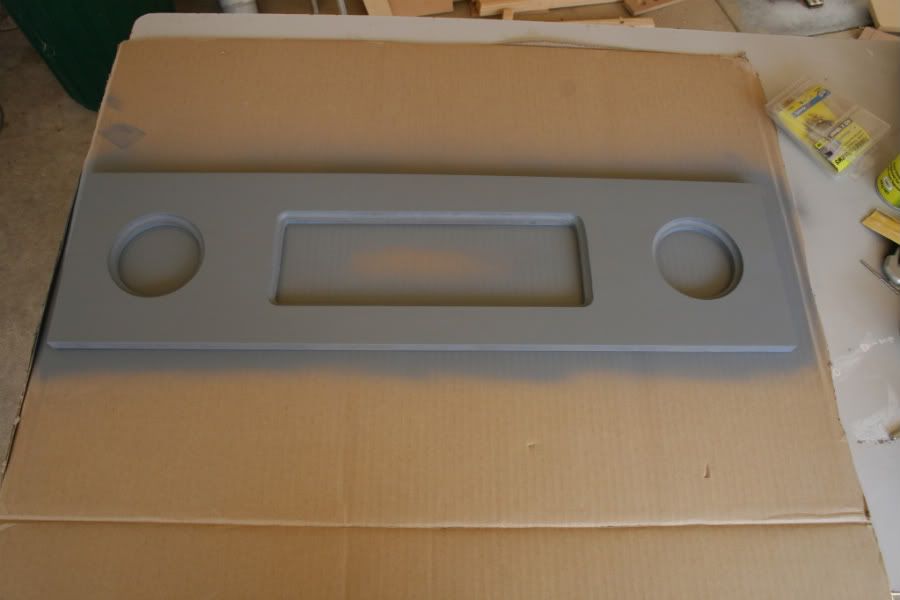

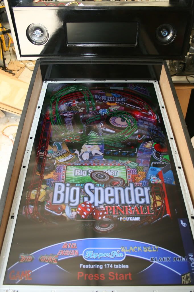

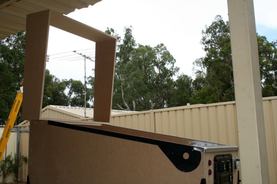

Started painting some of the panels today and its safe to say never again will i try and attempt piano black its just to hard with a pressue pack can and it was windy as hell with no escaping it.
spray putty
Primer
gloss black
Clear coat is still to go on then ill wait a week for it all to go hard before i start to polish it.

Wow, your doing a very thorough job at detail. Thinking everything through fist before just going to wood. Very well built. What software are you going to run on it? Future Pinball?
Where's my gold star :P

Sweet paint job, Kurt! Very clean. How many coats are on that piece?
BTW, what kind of router edge did you do to the DMD and speaker holes? I'm ready to do mine, but I'm scared to start since there's no undo button in real life! hehe.  I was thinking of a rounding bit, but a couple of tests I did the 45deg chamfer looked pretty clean.

Pinball wizard: Thanks for the comments, Malenko hit the nail on the head.. Front end ill be running Hyperpin.
Elfman12: Thanks mate, i think i used a cove router bit, not sure i tested afew before i did it on the main peice.

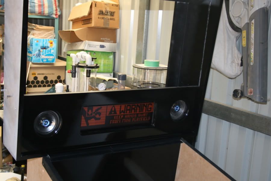

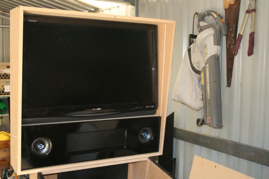

Threw in a shelf to hold the 32" display before i pull it apart to glue and fill then it should be ready for priming tonight with any luck..
Quick picture to make sure it all fits. I havent added any mount yet so the monitor will sit straight once i have them and glass in.

Thanks, that backbox is going to be super sweet. Great fit and didn't have to de-case!

It doesnt look super sweet at the moment it's covered in polly filler.
I built the box to fit around the tv so i ddnt have to de-case it more protective that way i guessed.

Got alittle bored while waiting for the backbox to dry so i started the backplate and glass retainer.
Getting a pretty good reflection considering its covered in dust and still needs a 1200 sanding and polish.
Hopefully have the backbox 80% completed this arvo just waiting on fans and grills to turn up and throw some glass in there.
DMD test, couldnt resist

Received my 120mm Fans with red LED's and grills today so i can finish up the backbox and move onto spraying the main cab.. I can slowly see the finish line then onto wiring it all up my least favourite job..

Finally got around to mounting the playfield with the correct depth before i pull it all apart.
