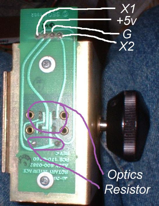

I picked up 2 360 steering wheels and the optic board on them are pretty plain. I wanted to verify what I think is what before I hook it up and end up frying the board.
My only question is:
from left to right would this hook up as...
X1 +5v GND X2
As usual, any help would be appreciated.
Thanks

I have a very similar looking optic board from a Sega Star Trek spinner, and it looks like you've got it right.

I appreciate you lookin' Jerryjanis, i'll give that hookup a try....if I fry my board then I know I was wrong.  ;D

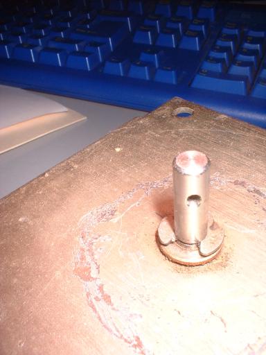

Great, now do you happen to know how to get one of them darn sega vector spinners off the panel? I couldn't seem to get the knob off mine.
Mine never came with a knob, so here's a picture of the shaft:

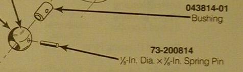

I'm guessing that there might be a hollow pin that goes through the spinner knob and through the hole in the shaft, similar to the one seen in the following picture from the 720 joystick manual:
If your spinner has been used, there's a good chance that the hollow tube is full of sweat/dirt/grease so youll probably need to give it a good scouring to find where the the hollow pin is.
Note:  I'm guessing about the hollow pin, I could totally be wrong, although there is one such hollow pin elsewhere on the Sega spinner.
