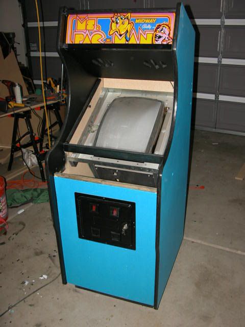

Bought an old Taito Ms Pac Man-Quix game today for $40.00 Seems the power supply is dead?  The cabinet is rough with water damage I may be able to replace the sides, not sure this one is worth saving.  Im not in it a lot, maybe I should part it out.  not sure how to check the power supply.  There was a switch in the front left corner with four wires going to it. two white and two black.  They were disconnected.  Do i need to hook these white/white black black?  or white/Black white/black?  What is the next step to testing the power supply?  There is AC at the auxillary plug now (After repairing the initial fuse block.  Any suggestions?  Are any of the parts valuable?

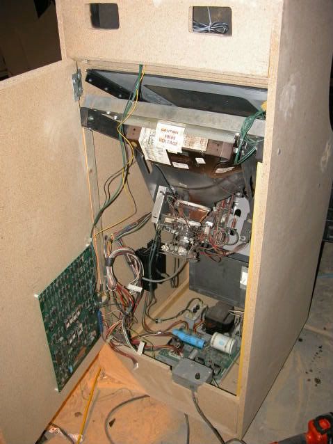

Day 2 - electronic troubleshooting
« Reply #10 on: October 12, 2009, 10:31:11 pm »
Ok, I pulled the circuit board and learned something interesting.  The circuit is not shorted untill I hook it to the brick.  Does anyone know what this means?
« Last Edit: October 20, 2009, 12:55:19 am by newtrix »
newtrix
  • Posts: 165
  • Last login:March 26, 2025, 04:16:36 pm
    • Loving Family Seeking to Adopt
Day 3 - A possible solution?
« Reply #11 on: October 13, 2009, 02:05:37 am »
Determined that the Bridge Rectifier (Which is the first component off the fuse holder) is dead on two segments.  planning on replacing it with this one, is that ok? http://www.radioshack.com/product/index.jsp?productId=2062584  does it sound like I'm barking up the right tree?
« Last Edit: October 20, 2009, 12:55:54 am by newtrix »

Hard to say without pictures of any kind.  Make sure they're not blurry.

Junkyard Arcade $40.  Blown Fuses $5.  Bridge Rectifier $6  Working Ms Pac Man Qix Conversion ...Priceless.  Needless to say the Bridge Rectifier Fixed it.  I say junkyard because it was literraly on a pallet stored on a metal rack, outdoors.  No idea how long it had been there, but at least it doesnt rain much in Las Vegas.  That said, one side and the top and front have a lot of water damage and there is a damaged corner and now I am at a crossroads... To repair? repaint? remake the cabinet?  I could sell it as is for four times what I paid for it and put the money in a scratch build.  Just dont know what to do.  I know as this it the restoration forum and everyone will say restore to QIX.  (Which I am not interested in doing.)  I'll add pictures for advice on the water damage.  Does anyone have any experience with wood hardner?
« Last Edit: October 20, 2009, 01:20:34 am by newtrix »

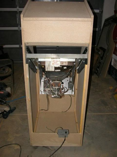

Day 5 - The rebuild begins.

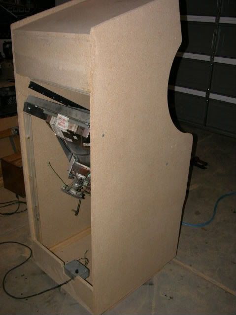

« Reply #14 on: October 14, 2009, 02:14:19 pm »

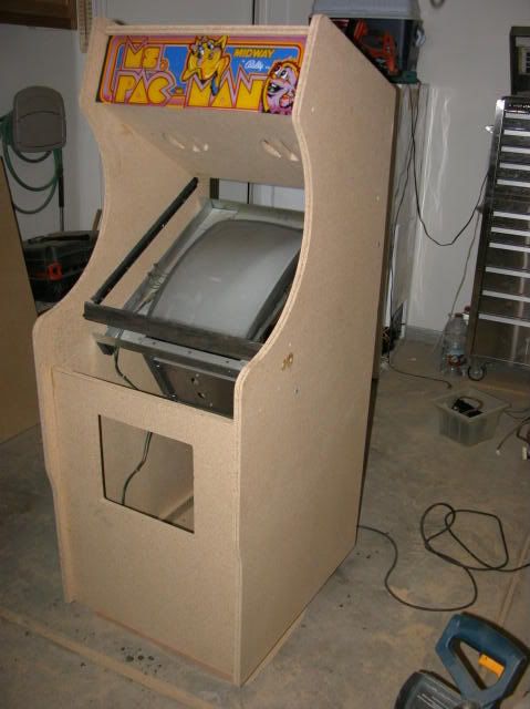

So last night I emptied the now working cabinet. Laid it on its side and cleaned the edges and surface of the one good side with a belt sander.  Today I'm getting new lumber to rebuild the cabinet.  I intend to use the one good existing side to make duplicates I'll make 4 blanks and use two to rebuild the cabinet and 2 to do a scratch build mame.  Not sure how I'll decorate the Ms Pacman.  Its not the right shape to do a real ms pac.  I could change the shape since I'm replacing the sides anyways.  Cause in reality it's a Taito Qix with a fake Ms Pacman PCB and a conversion marquee, so it will never be a true restoration.  I think I'll use the Tatito shape, paint it Ms Pacman Bluem with no graphics and a generic bezel and CP .
« Last Edit: October 20, 2009, 12:57:06 am by newtrix »

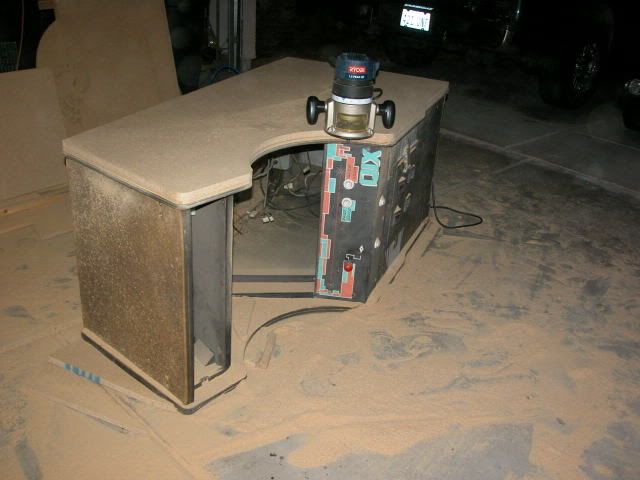

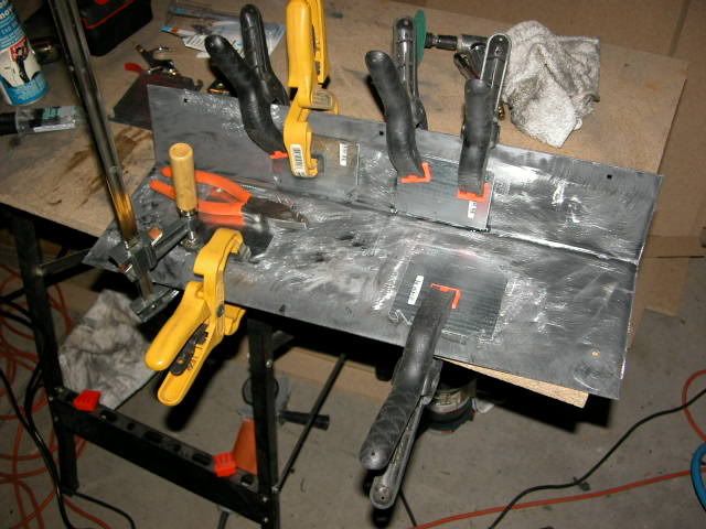

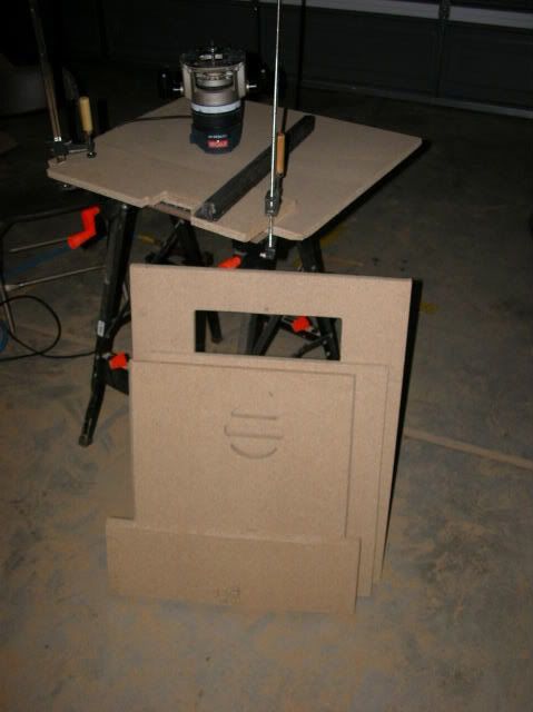

Day 6 - A trip to Lowes - Bases Built

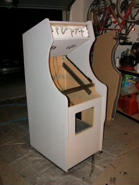

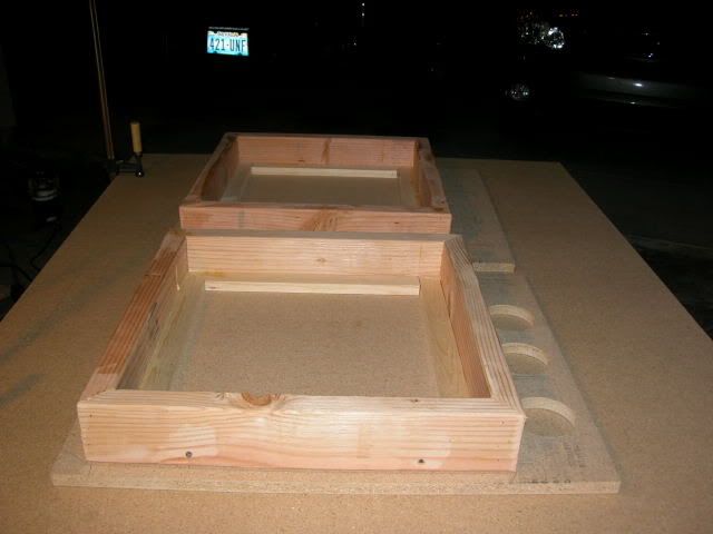

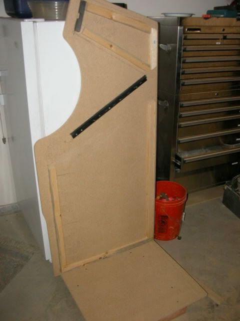

« Reply #16 on: October 17, 2009, 03:46:41 am »
Well how it will look is still undecided.  But i'm going ahead with the faithfulish cabinet replication.
Sturdy 2X4 bases cause these taitos had particleboard bases that crumbled with time.  Seems every restore requires new feet.
Copying the one good side with a router.  I made a second set of sides to make a scratch build mame with LCD.
Its coming together nicely.  Cant believe I only bought this Sunday.
Made speaker Panel,  top, front and a couple parts of back for assembly tomorrow.   I am interested in ideas for how it will look.  it will play ms pacman perhaps taito stencils in blue and pink?
« Last Edit: October 20, 2009, 01:00:59 am by newtrix »

I can't tell for sure from the pictures, but that Qix control panel looks to be in pretty good shape.  Since there is no reproduction available for that control panel, you may want to see if any Qix owners would like to swap panels with you. (that is, if you are planning on going with a Ms. Pac looking paint job)

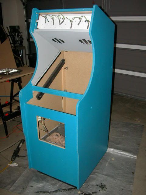

Day 7 - Cabinet takes shape
« Reply #19 on: October 18, 2009, 12:49:42 am »
Time for end of day post up.
« Last Edit: October 20, 2009, 01:02:04 am by newtrix »

Day 8

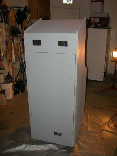

« Reply #20 on: October 18, 2009, 01:40:10 am »

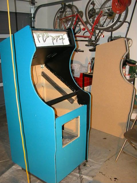

Im looking for ideas about how to do the back door if anyone has any posts that show something you think would work please clue me in.  Currently I'm leaning towards screwed on panel, but I'd rather have a door.  I happen to have a new piano hinge lying around.
« Last Edit: October 20, 2009, 01:03:22 am by newtrix »
SirPeale
  • Green Mountain Man
  • Posts: 12963
Re: Taito Ms Pac-Man Saved from the Junk Heap
« Reply #21 on: October 18, 2009, 07:32:53 am »
That's amazing!  I wish I had that skill.  And the tools.  :)
The back door on an original Taito was on a hinge with a locking mechanism that would secure both the top and bottom of the door, from the right, when you turned the key.
What I'd do is cut the door and instead of using a lock I'd use screws to secure it into the wood.  A couple of PLYWOOD (not MDF) blocks to screw into (so it doesn't get ripped out (which it probably wouldn't but I got my training keeping stuff on the street intact, not in the home)) and off you go.
If you were looking for something original you'll have to ask around for the locking mechanism.
newtrix

Day 8
« Reply #22 on: October 18, 2009, 12:13:20 pm »
Got the door figured out, thanks for the compliment. For tools... Router $100, flush bit $25, slot cutter $25, chop saw $100 (not totally necessary), Radial arm saw with angle capability $100. Air nailer $20 harbor freight, used air compressor $40, belt sander $80  (not totally necessary). That is all I used. One tip is to get some panels cut to the interior width, the floor, top, front, back and shelf all have the same width.  Then at home all you need is one Straight cut per panel.
« Last Edit: October 20, 2009, 01:04:57 am by newtrix »

Completed the door last night reusing the Taito hinges.  Then I added a simple lock to the other side.  I decided to install the circuit board power supply and wiring harness.  Next thing you know it was all hooked up and I turned it on to make sure it still worked. (I had had a close call with the circuit board while it was out.)  What do you know it still works!
Also filled some alignment holes with wood putty, next a little sanding and primer.

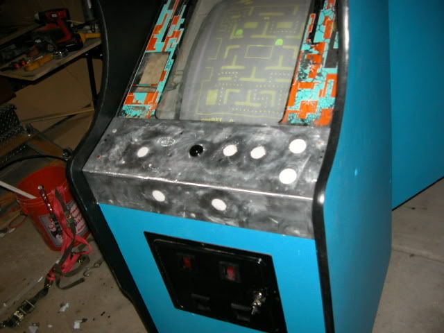

looks nice but will look better once you offload that bezel/cp to the needy and get something more fitting to the ms pac theme.

Yeah They are just for Mock-up and function verification for now.  Still planing the bezel and CP.

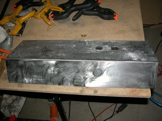

« Reply #28 on: October 21, 2009, 01:36:23 am »

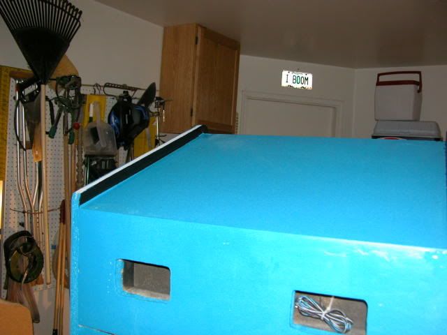

Last Minute Dinner at the in-Laws despite best laid plans.  :hissy:  Took the monitor out and painted the base will need another coat I'm afraid.  little more touch up with wood filler.
« Last Edit: October 21, 2009, 10:21:47 pm by newtrix »

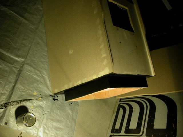

Day 11
« Reply #29 on: October 21, 2009, 10:06:06 pm »
A coat of primer
« Last Edit: October 21, 2009, 10:21:26 pm by newtrix »

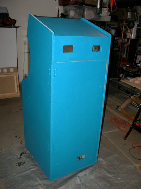

Day 12

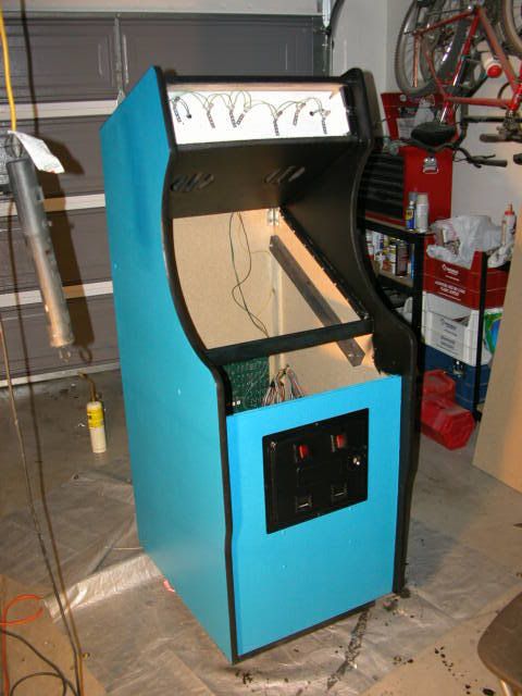

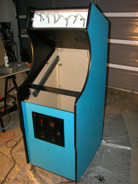

« Reply #30 on: October 23, 2009, 01:38:12 am »

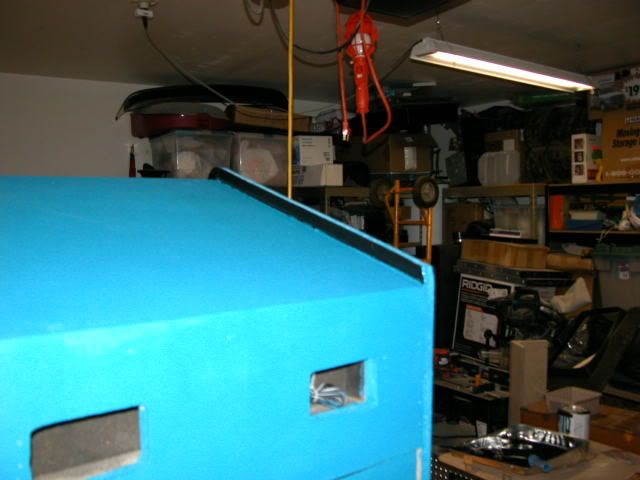

Dinner at my Mother's house and Survivor and a late night painting session.  Paint from Home Depot Glidden Rapsody.
Scored a CP overlay on eBay http://cgi.ebay.com/ws/eBayISAPI.dll?ViewItem&item=220495472411&ssPageName=ADME:B:BCA:US:1123.  Now I'll have to relocate/fill some holes in the QIX CP.  Plan on backing with metal using bonding epoxy and then fill with Bondo.  This is my big weekend project.
« Last Edit: October 23, 2009, 01:53:14 am by newtrix »
newtrix
  • Posts: 165
Day 13
« Reply #31 on: October 24, 2009, 02:16:06 am »
Dragged to Dinner and a casino tonight.  Painted the black areas when I got home. Also bought a small sandblaster from Harbor Freight and tomorrow I'm going to try to blast the coin door and CP (Crossing Fingers)
« Last Edit: October 24, 2009, 02:19:44 am by newtrix »

newtrix
  • Posts: 165
Day 16 Heat Gun for the Win!!!
« Reply #36 on: October 27, 2009, 01:47:18 am »
Finally removed the Vinyl from the CP with a $25 Lowes heat gun. And a $1 Scraper. :applaud:  Thanks for the advice guys!  Slammed the monitor back in and it looks like I'll need a Cap Kit.  :badmood:  Anyways I roughed up the back of the CP and Epoxied some electrical plates over the holes i dont need. Eventually I'll Bondo the front and Drill the 3 correct Ms Pacman holes.  Did the Marquee Yesterday.
An hour later...
Wow that worked Awesome.
« Last Edit: October 27, 2009, 02:55:02 am by newtrix »

Day 17 Bondo the CP
« Reply #37 on: October 27, 2009, 10:34:34 pm »
« Last Edit: October 28, 2009, 12:43:03 am by newtrix »
