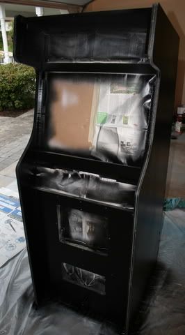

I do have the cab. I have just attached a few picture for everyone.
As you can see in the pictures there are places where I think there used to be wood moldings that would hold the bezel and monitor in place but they are missing. I am hoping to figure this out with as little experimentation as possible. :) So far this forum has been a great help.
I am not even sure what size monitor-TV to put into this thing. I would love not to spend to much more on it but of course I will if I have to!
Thanks for the feedback.
rich

That's not a Joust ... it's a Robotron.
Not that it helps you, but since I have one of the same era, I can take some measurements for you (even though I swore that I would never do it again, the arcade gods have smiled upon me recently, granted me a grail and I need to keep the balance tipped appropriately).
FWIW, though, it looks like the monitor shelf is intact.

Intact-ish.  It's a plywood board that the monitor bolts to (shelf mount monitor) and slides into place and the shelf is then bolted to the cab.  Unless he pulled it out, it appears to be missing.
But that's not a big deal, it's just a piece of wood.
Also appears to be missing all cab hardware (cp latches, I note) and is there a cp?

wow that cab has seen better days, im glad it found a good home though someone who is willing to nurse it back to health.
as per your coin door you have 2 options.
1. get a new coin door + cash door that originally went on it.
2. replace kick panel (front bottom panel) with a fresh piece of wood and mount any door you want.
3. ADD a new piece of wood over the kick panel leaving the original panel behind it and then add a coin door (coin door would need to be of same or smaller dimensional otherwise you'd be cutting up the original kick panel behind it.
#1 would probably be the easiest way to go about it.. that midway door you have is highly desirable you could probably get someone to swap you for a working door that originally went on that cab.. if not happs sells doors that will fit it.
the original door was a coinco 2802.
the monitor mounts on a piece of wood, then it slides into those other two pieces of wood on each side of the cab..
       Monitor
the bezel usually just sits on the monitor and is held in place by the monitor glass/plexi
although sometimes it's stapled in place on it's edges.

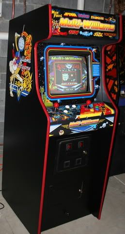

Here is what that cab looks like cleaned up:

Well that looks great! I still think that at 8 hours a day I can have the cab done in 2 weeks. I'm on vacation.
I am planning to paint the cab white instead of black. I have ordered 40 feet (a little extra) of bably blue t-molding and want to paint the coin door either white or the same blue.
I need a new Marquee image and CP layout sticker. Eventually I will get the coin door working but I had thought that I should just install two buttons in the rear of the cab for credit 1 and 2.
I recently won a auction for a HAPP trackball that is marbled the same color combo I love white and light blue.
On the sides of the cab I will eventually take the time to either airbrush some graphics on or just buy some vynal static decals of Pacman and Ms pacman.

I can think of one example where someone did it, but it's /really/ crowded.  Remember this is a cab that was originally intended for one person at a time.  Two player SF2 layout can be done, but it's a tight fit.  Add in a TB and it's even worse.  Plus remember you have to stand next to the person you're playing with/against, literally shoulder to shoulder.
If it were my cab, I wouldn't necessarily do an only Williams game theme, but I'd do only horizontal games that are 2P alternating play.
