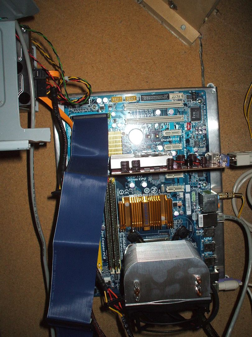

Computer:
  Instead of using a computer case, I build a mounting plate from some left over sheet metal and standoffs.
This way, the motherboard gets all the air it needs inside the cabinet without the loss of the earth ground the case provides (i have a grounding braid going from the mounting plate to the psu.)
  Got clever with the psu and mounted it with plastic straps that i think are used to hang ventilation.  Just unscrewed a few of the psu's case screws, attached them, and bolted them to the bottom of the cabinet.
  I then bolted a drive holder i cut from an old computer case for the hard drive.  Worked out really well... If I decide to add a DVD drive, i'll have access through the coin door  8)
  Also custom fabricated a little rig using one of the original cherry power switches to power on the PC. (Pic of this later)
Specs of computer:
-Intel Pentium E5200 2.5GHz Dual-Core Processor
-ARCTIC COOLING Freezer 7 Pro 92mm CPU Cooler
-OCZ 4GB (2 x 2GB) DDR2 Dual Channel
-GIGABYTE GA-EP43-UD3L ATX Intel Motherboard
-CORSAIR 400W Power Supply
-Western Digital Caviar 500GB 7200 RPM SATA Hard Drive
-ArcadaVGA card hooked into the original monitor (really like the vga break out cable they offer by the way, didn't expect it to plug right into the monitor board like it did)

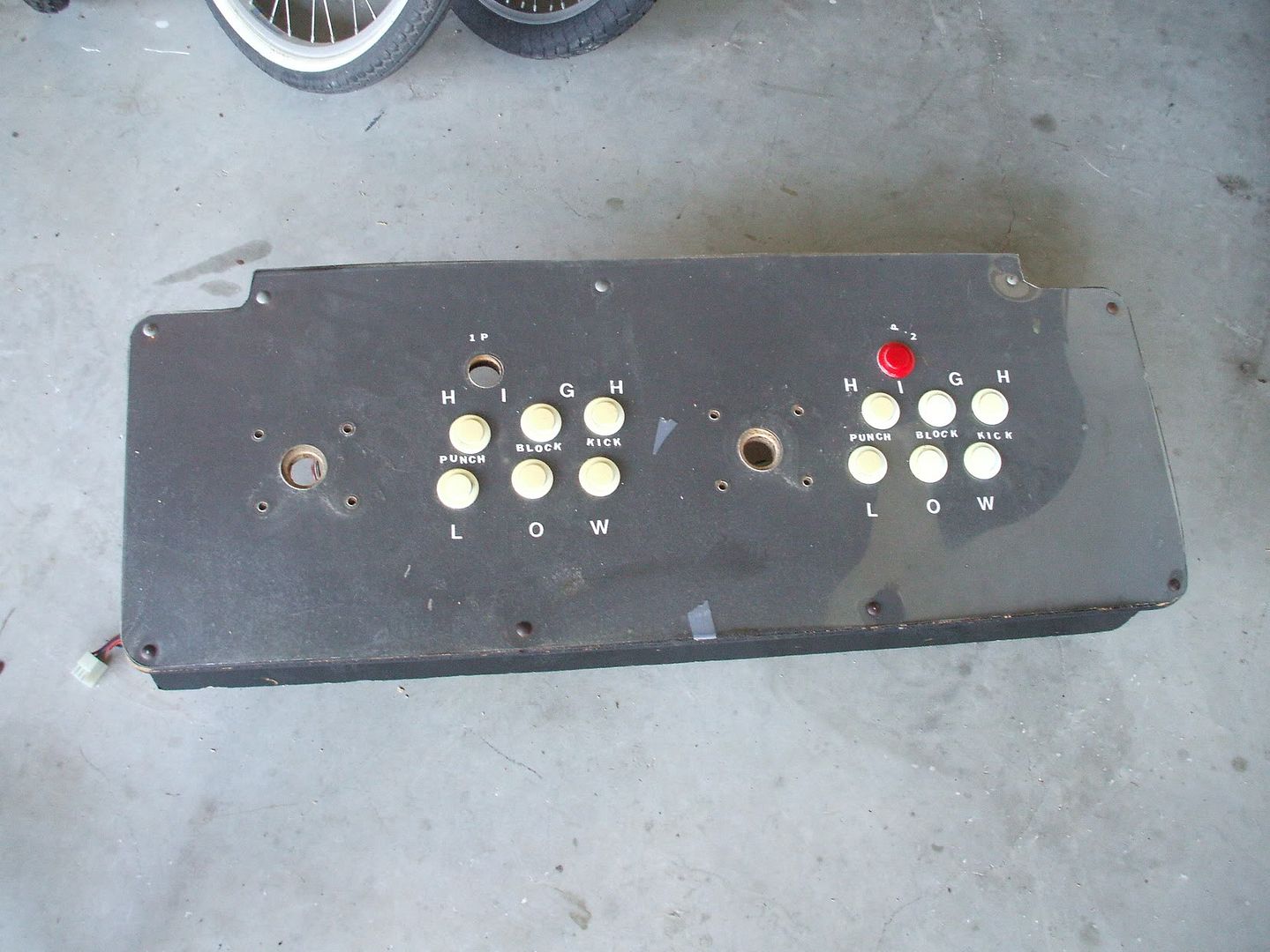

Control Panel:  Ah... now heres the main project  ;D The original was just all sorts of mess.  Bunch of non-working buttons including some on the joysticks, and only 2 players. The joysticks and everything were in there, I was just poking around so i removed them.
  I redesigned one with 4 players with a trackball
  ...SUPA re-enforced....   :dizzy:
 ...and even entirely detachable so its easy to move (I'm a college student so it'll probably see a few different apartments in the next few years).
Having the overlay made soon and should be finishing this up soon.  OH, and changed the theme to miller lite  :lol
