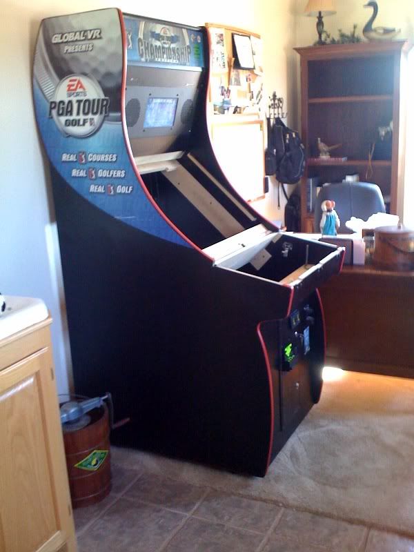

I'm in the process of MAMEing a cabinet for a friend of mine and one part of the project is giving me problems.
The cabinet is a Global VR Golf and there is a lighted instruction card between the speakers, as seen here:

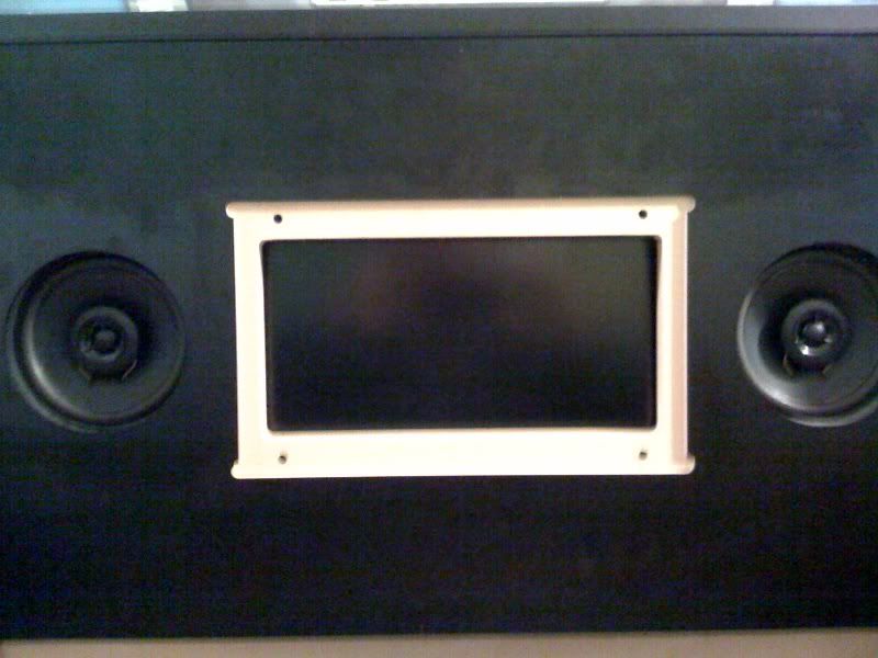

We've removed the card and now have an opening that is 10" x 5". In it's place, my friend has mounted a 15" LCD monitor (12" x 9").
What I need to figure out is how to restrict the screen size from 12x9 to 10x5 (obviously not the same screen ratio). That or I need a program that will display an image and remember the window position. I will use CPwizard to create the instruction images, then resize them, and hopefully get them to display in the same position every time. I need to find a program that will launch the image file from a command line. My searches haven't gone well. Even if I have to display the image full screen on the secondary display, that's fine, because I can add borders to all the images to fill in the hidden areas if needed.
But I'm not sure the best way to go overall. I want the button layout to load the moment a game is started and stay loaded the whole time.
Anyone have some ideas on what to do here? Thanks.

Figured it out!
What I did was extended the display to the second monitor, moved Irfanview to it, resized it to display at 10" x 5", made sure it remembered the size and position, then told it to fit images to window. I can just have Mamewah load the images into Irfanview when starting each Rom set.

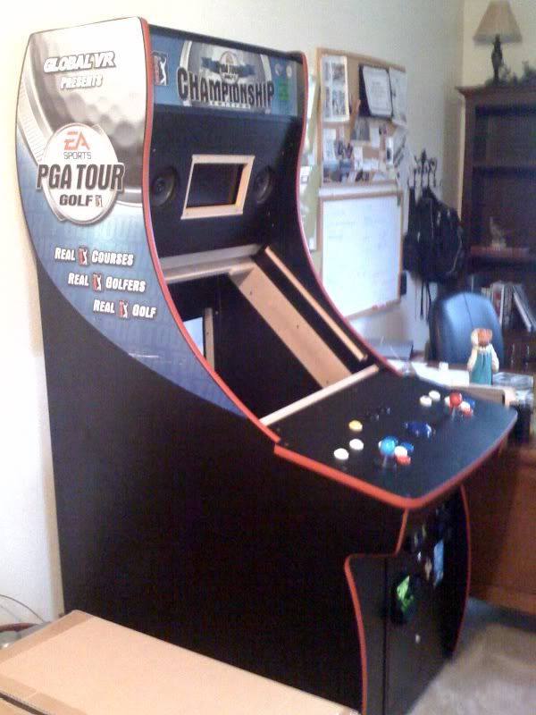

« Reply #9 on: October 02, 2009, 11:45:27 am »
Figured out the answer to my question last night and got it working. I'll be posting instructions and pics (as soon as I have them) later.

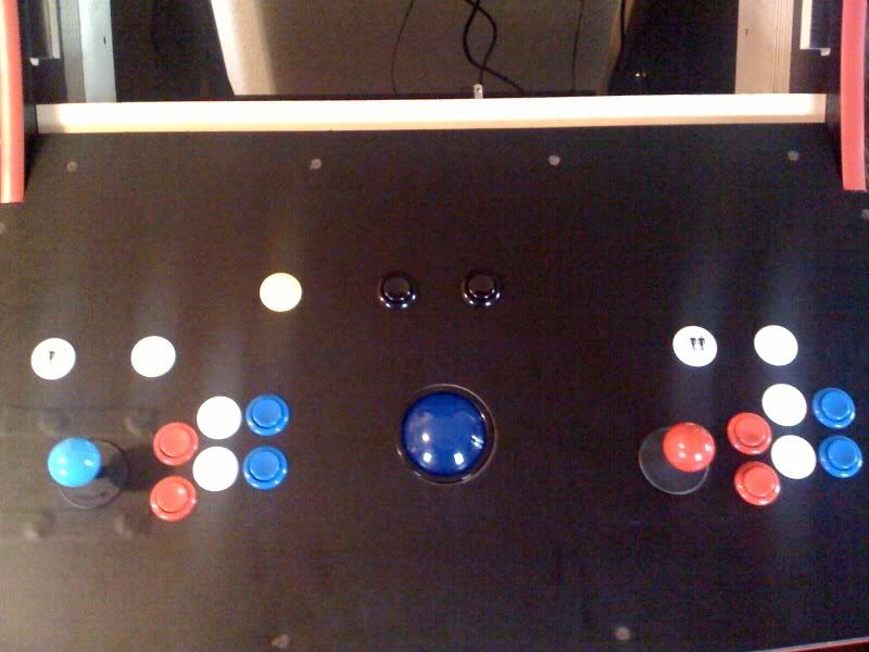

Here's the CP I did for this cab. I messed up a little bit, which is obvious, but I'm happy with the playability.
