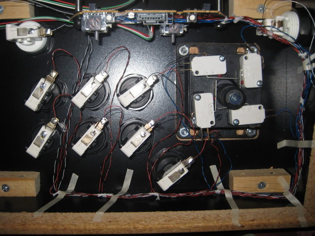

JamesV77
  • Posts: 6
  • Last login:September 03, 2015, 05:10:07 pm
Re: Turning a Dreamcast arcade stick into a 360 stick
« Reply #4 on: February 04, 2009, 10:10:49 pm »
The newer 360 wireless controllers are also common ground.  I realized that after the mod job...... :dizzy:
Great fun mod to do.....It becomes multi platform sorta if you get the microsoft windows receiver so you can use it with MAME on a PC..... Heres some pics of mine......
  • Last login:February 09, 2026, 10:26:35 am
« Reply #5 on: February 05, 2009, 06:20:44 am »
Not quite.  LT & RT are on their own ground for the new wireless M$ pad.
