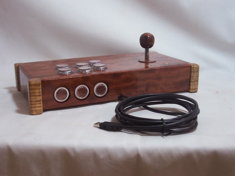

I didn't take any progress pics of the first one I built (the red one in the pics below) so I thought I'd try to document the second one a little better.  The construction of the box will be the same.  Black laminate this time.  Different color t-molding and different cpo.
First stick:
Second stick - parts cut out and parts glued to laminate.
The sides are 5/8" and the top is 1/2" with .010 plexi on top.  Tomorrow I'm planning on trimming the pieces and getting the sides glued together.
Hopefully by the time I'm done with this stick, the gold laminate I have on order for the Ark will be in and I can get back to working on that beast.  ;)

Got the pieces trimmed today and glued the corner blocks to the front and back panels.  I also routed out the lexan.  Unfortunately, something got underneath the router and scratched the Lexan through the protective film.  Total loss on that.

I think most of us started with one of these kind of projects. The thing I hated with mine (besides the crappy woodworking) was how high it sat up in my lap and just how big the whole assembly was.
I love your first stick and now I'm thinking of building one, but with a focus on the ergonomics of it all. However with yours, I bet the size and the angle of it makes it mighty confortable. Let me know how it feels on your lap during a long play session.

I can't tell from your first post whether the back & front walls have an angled cut on them?
I can see an angle on the side walls so that the CP surface angles towards the player (excellent!) but I was wondering if you had to angle cut the top edges of the back/front walls, and whether that added a lot of complexity?
somunny
  • Posts: 1618
  • Is it hot in here?
Re: XBOX 360 Street Fighter Stick #2
« Reply #16 on: January 13, 2009, 07:23:12 pm »
Yes the fron and back pieces are cut to match the angle of the side pieces.  If you have a table saw it's pretty simple to cut the angle.  I used the side piece as a guide to set the blade.  Just butt it up to the blade and adjust.
The height of the box is only 4 1/8" at it's tallest point.  Haven't played with it on my lap, though.  I normally set my other stick on the coffee table and play it that way.  My other stick is quite a bit bigger than the red Street Fighter one however.

A little more progress tonight.  Tomorrow, I'm going to try and route out the Lexan and drill the holes in the top deck.

Progress tonight: Lower box assembly is complete.  Re-routed the Lexan.  No scratching this time.  Laid out the joystick and button placement.

Essentially finished the box today.  Still need to apply the artwork and t-molding (waiting for delivery).
Lexan and control panel drilled.
Pic of the drilled control panel.

Got the last of the buttons I was waiting for this afternoon.  The box is finished.  No controller or wiring, though.  I'm thinking of just selling populated shells and letting people do their own controllers and wiring.   I do have some hacked controllers left in the event someone wanted the whole package.
Anyway, on to the pics...

That's great man. What are the side buttons? Triggers or Back/Pause? Is the button that is next to the USB port the Xbox Guide button?
Just trying to figure out what kind of admin panel I should build when I put my Xbox in my SF2 cab.
Edit: What is the purpose of having the LB and RB on your layout? Are they going to be used for SF4 do you think?

Thanks.  The side buttons are start & back and the button next to the USB passthrough is Guide.  I went with the 8 button layout because, IIRC, the first Street Fighter released on XBLX let you map P and K x3 to those buttons.  I'm not sure if they'll play any future role but you never know...
