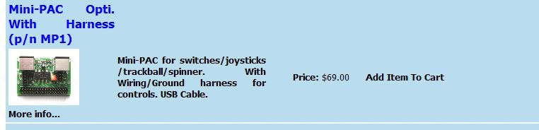

Option 1: U-Trak ($89) + Bezel ($5) + Mini-PAC Opti ($69) = $163
Option 2: Electric ICE-T Trackball ($116.95) + Trackball Install Kit ($8.95) = $125.90
Option 3: U-Trak ($89) + Bezel ($5) + Opti-PAC Opti ($39) + Trackball Adaptor Harness for Opti-PAC ($3) = $136
Option 4: Trackball 2 1/4in Without Cables ($48) + Trackball Mounting Plate ($16) + Mini-PAC Opti ($69) = $133
With these options do I need to add anything else, or did I add some I don't need?  I was a little confused on the Mini-PAC standard vs Opti and if I can use the Opti-PAC for buttons.  I do like the thought of one store ordering to save on shipping, as I need to get some stuff from Ultimarc anyway.  All this confusion for 1 extra button :'(.
Any opinions?
