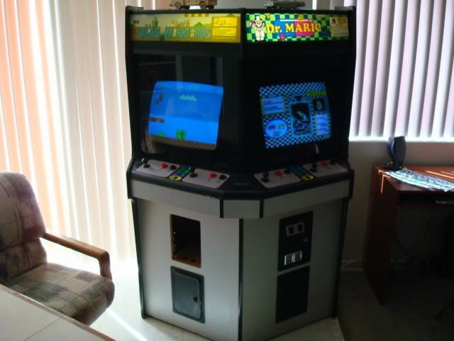

37 yrs old and starting to get into the stand-ups...
just bought a nintendo vs. machine (left/right) one side is super mario bros and other side is dr. mario.Am not very fond of dr.mario(never was),
am wanting to make dr.mario side into a jamma board 60 in one and keep supe mario,can someone please tell me how this can be done while keeping original control panel and monitor.guess what im asking is, is there a way for it to be plug n play...

There are a couple of plug and play options to run Nintendo boards in JAMMA cabs, but I haven't seen one that goes the other way.
About as close to plug and play as you're going to get is to remove the innards from the one side, drop in a normal CGA monitor, power supply and JAMMA harness.
Otherwise, you have to deal with the difference in voltage (Nintendo ~ 100V), video inversion and amplification (Nintendo is amplified off-board, JAMMA is on-board) and wiring harness (I am assuming that you're running a Dualsystem board rather than two Unisystems). I don't think it is as clean a solution as you are looking for.
If I were you, I'd grab a different VS kit to replace the Dr. Mario.

And what he means by that is that you can replace "cartridges" in that Nintendo system. Perhaps there is another game you like better (ExciteBike?). That's your easiest solution.

Yeah, that's what I meant ... replace a handful of socketed chips (no soldering) and presto! New game.

There's the rub, it has to be a VS game.
http://www.klov.com/game_list.php?letter=V&type=Videogame (scroll down to the end of the list)
And I usually find my VS kits on eBay.

Are you talking a Vs Dual cabinet?
sri3850341
  • Posts: 23
  • Last login:December 21, 2008, 09:15:21 am
Re: new to the forum with first question....
« Reply #9 on: October 08, 2008, 07:56:07 pm »
yes sir

Remember that if you make one side Jamma, you will have a bar rolling through the picture on both monitors. This is due to both monitors having their yokes so close to each other and no longer running from a single CPU clock source.
is there any way to shield against that
Yes, it was detailed in a very old Star Tech Journal issue. You need to install a heavy LEAD shield plate between the two monitors and connect a cabinet frame ground wire to it.
