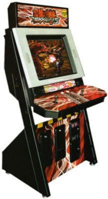

    Im building a new cabinet. The local arcade has a tekken 5 and i really like the game and the cabinet its in. So im gonna build a cabinet based on it. I have a ps2 with tekken 5 and a dreamcast with marvel vs capcom 2. Im torn between which game to use because i just want to make it a dedicated cabinet. The cool thing about tekken 5 on ps2 is it offers 16:9 progressive scan. Also what im thinking about is lasting power. Which one is gonna last longer before having problems,the ps2 or the dreamcast, because i don't want to be replacing it in a year or two. Well i would like to hear you guys opinion on this one. Im going to take a lot of pics during the build process since i havnt seen a cab like this built yet. This should be interesting.
here is the cabinet
Twin-X

I like the way those cabinets lay back, but they have kind of an IKEA look to them. I liked this cab, which has a similar profile but doesn't look quite as primitive. I'm pretty sure this was posted here, but I don't remember by who. I just liked the shape so I saved the pics for reference. This is also a bit easier to build for a DIY'r, since you can use wood instead of the metal beams on the one you posted. Sorry, but most of the images were small.
