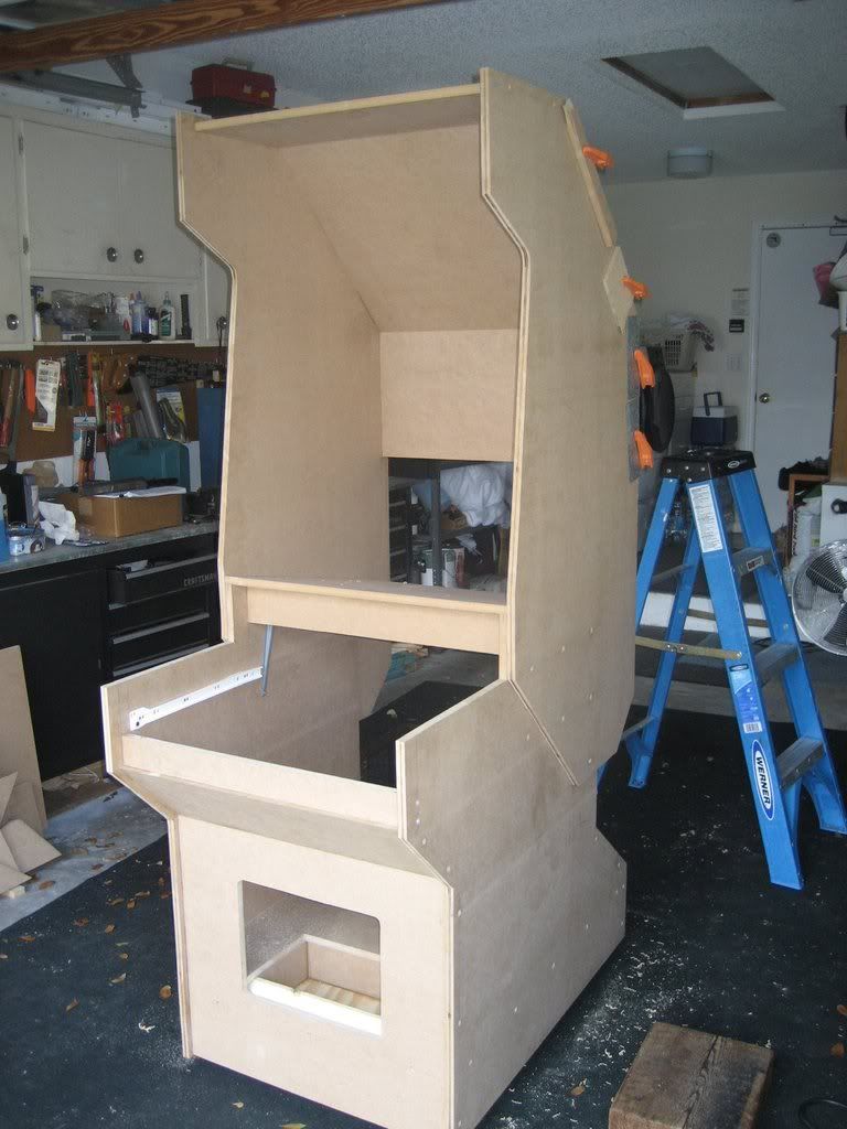

The original plans called for the cabinet to sit directly on the ground... no casters.  I wanted to be able to move the thing around.  I modified the plans a bit to allow for a recessed base that would accommodate nice heavyweight casters.  I didn't want to see wheels.
I also did some rough weight calculations.... 5/8" MDF sheets were in the neighborhood of 70 something pounds each.  The monitor I chose is 100 pounds.  Controls, computer, etc... this was going to be a heavy cabinet.
I didn't think that 5/8 MDF would be good to hold all that weight, so I decided to build the base using a 2x4 frame with a 3/4" Plywood base.  I would then mount the casters to the 3/4" plywood.
Time to start cutting:
Many of the parts have been cut, it's time to start building the frame for the base:

Time to put some more of this together... Let's see... Tab A into Slot B...
(up to now... I've got about 16 hours invested in the project)
Time to install that plywood base and the casters:

Time to get the top section into place.
I should say... I've been using #8, 1.5" screws and a good wood glue to put this thing together.  I first drill 1/8" pilot holes.  Then, each hole is drilled about 5/16" deep with a 3/8" bit.   I bought a 3/8" plug cutter and drilled plugs from scrap MDF.  Once the screws are in place, I hammer in a MDF plug with a rubber mallet.
Here the top section going together.

Hardware... oh, yea... I'll be needing some hardware...
I went hunting around for some way to mount the control panel box onto the cabinet.  Yes, I know that Happ sells those panel latches (and I'm not sure, I may still need some of those).  I found these friction catches at www.rockler.com .  I mounted them and the panel now snaps into place.  I used 4 of them.  Since the catch uses a "pin and socket" sort of design, I didn't want my panel to be sitting on pins (the part of the catch that's mounted to the bottom of the control panel) when it's removed from the cabinet.  I decided to place two pieces of MDF (one on each side) on the bottom of the control panel.  I cut them at an angle so the panel really does center itself as it snaps.
« Last Edit: July 13, 2008, 05:57:34 pm by paulscade »
... Why is it that you always find it in the last place that you look? ...
paulscade
  • Posts: 215
  • Last login:December 26, 2022, 09:40:35 pm
    • My Arcade Project - Blastoff!
Re: paulscade - First Build - MAME - No Name (yet)
« Reply #20 on: July 13, 2008, 04:52:29 pm »
Another "thinking" problem.
I wanted to hinge the top of my control panel at the front of the control panel box.... so that the control panel top will lift up from the back (like other panels you've seen here on this site).  I had a requirement of not wanting to see the hinges from the front.  BUT... my panel top overhangs the front of the control panel box by 3/4".  Standard hinges wouldn't work.... because the top needs to lift and separate from the box to accommodate for the overhang.
Again, at Rockler, I found what I think will work.  I don't have these mounted yet but my initial tests with scrap wood, it seems that these hinges give me the right amount of lift and separate that I need.  They weren't cheap... $15 for the pair + shipping.
Here are some photos of the test.
Simulated 3/4" overhang on the front of a test "panel"
A closed panel top
Some of that lift and separate
This just might work
« Last Edit: August 31, 2008, 10:50:33 am by paulscade »
paulscade
  • Posts: 215
« Reply #21 on: July 13, 2008, 05:00:07 pm »
Time to place the monitor back into the cabinet for some fine tuning.
I'm now 57 hours into the project.
I placed the monitor back and marked up the holes for the mounting bolts.  This was also a good time to cut the bezel to size.  A sharp box cutter and a steel ruler did the trick nicely.
Measure twice (I probably measured 4 times)... and cut once.  I didn't want to have to buy another bezel.
I also noticed that there was a gap between the top of the bezel and the speaker mounts... humm... time to cut a small MDF filler.
The filler panel for the gap
The first time that the bezel meets the cabinet

Once the monitor is removed, that bezel will need a frame to rest against.  The frame will also serve as something to "push against" once I install the glass.
** By the way... I ordered glass from www.onedayglass.com.  Smoked, tempered, pencil edges.  I haven't received it yet but they had the best price around... I checked a number of local shops and this place beat them all.
The frame needed to be removable as the monitor would hit if I needed to remove it.  I built an MDF frame with countersunk screws and attached it to the cabinet.
While I was "in the area", I also sealed up the speaker section.  This would provide a for a speaker box and also give me somewhere to mount the marquee light later.
The frame
The bezel resting against the frame and the sealed up speaker area

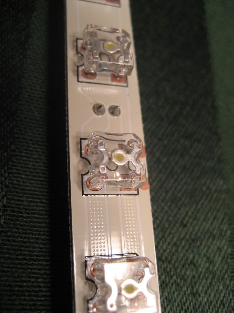

I went with the Groovy Game Gear NovaMatrix lighting for the marquee.  I hooked it up for test and it was pretty bright.  I don't have any art for the marquee yet... so it remains to be seen if it will provide enough light.  I think that it will be fine.  I really like the idea of generating less heat in the cabinet.
Here's the NovaMatrix:
... and a close up of three of the 16 LEDs:
« Last Edit: August 09, 2008, 11:24:33 am by paulscade »
